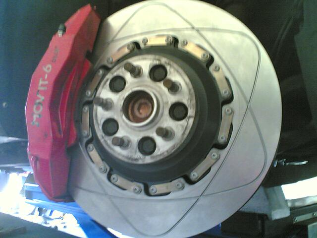

Not yet in production but watch this space.
These discs are in testing.
36mm x 378 , as fitted to Aston Vanquish.
These discs are on the awesome fully floating strap drive bells.
Massive improvements are obvious from first appearances. Absolutely no judder or rattle, just silky smooth running. My movit front discs were simply not able to handle the hear and they disintegrated after a few thousand miles. These new discs have been designed to overcome the issues of the movit disc. The same disc casting is used for the M5 e60 Ap upgrade. These discs come from the company how made brake pars for the Bugatti Veron, Maclaren , Jag F1, Touring cars etc.
I have gone to exceptional effort to get my breaks to cope with the power of the 6 piston calipers, finally I feel I have got there.
Product not yet available.
Will let you know when testing is complete. G
If you want pictures sent me pm with your address.

Post by Hutch » Mon Sep 11, 2006 8:06 pm
Pics G sent me of the discs are in my gallery.

Lovely pics Thanks H.
Rs4ever, great sig, Nice of you to share your thoughts. I personally cannot believe the improvements these discs have made. To surmise my car finally feels as refined as it did just before the wobbling cracking super duper moved discs that have no guarantee that only crack rattle and bang (then snap crackle and pop) if you drive to slowly to fast stop to quick or stop to slow. Ap4ever is my new name.
