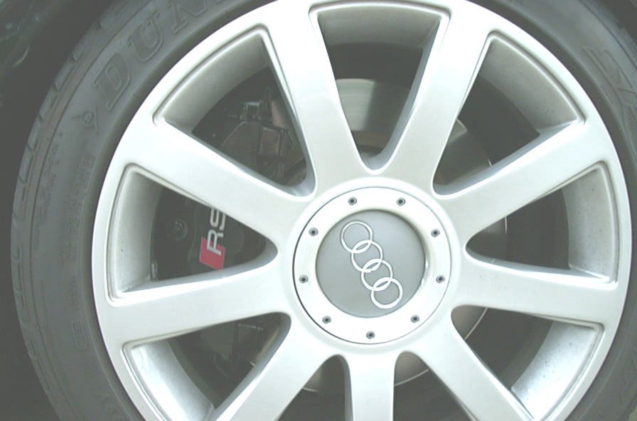

Due to much private messages regarding the topic (RS6 brakes on RS4) about partnumber request and mounting instructions:
Mounting RS6 8 cilinder-calliper in stead of RS4 calliper (standard) can be done WITHOUT modification.
The original RS4 disc doesn't need to be changed!
After mounting the RS6 calliper, the brake-pads of the RS6 can on course be easily mounted.
Only one thing:
to make the job right, the best thing to do is to change the original brake-hose (don't know if this the right word in Englisch) in STAHLFLEX-hoses and also to change brake-fluid in the racing-flued which can handle a much higher temperature.
However, the brake hoses don't need to be replaced. The difference is that the original hoses come out of the calliper in a 90 degrees angle. But in the RS6 callipers they come out in a 45 degrees angle. They can be "twisted"a bit, but not to far!
My RS4 is dated 11-2001. Please rectify that erverybody who want to do this brake-change has the same original brake-system as I had. I personally don't know if the braking system has changed during the production of the RS4!!!!! When it's hasn't changed during prodution 2000 - 2001 this is a super deal (MTM or ABT asks at least 4000 to 5000,- Euro for an 8 calliper system).
I don't know if prices differ a lot in the world, here in Holland you can buy the 3 needed parts for about 1500,-. I think it's a super deal.
PARTNUMBERS:
8-piston calliper left: 4B3 615 107
"- " " right: 4B3 615 108
Brake linings: 4B3 698 151 A
Regards from Holland.

- Attachments
- 8-piston RS6 callipers on my RS4
- RS6remmen.JPG (144.44 KiB) Viewed 18952 times

Jochie, great info, thank you! Regarding the mounting brakets for the caliper, di you made a custom one, or does the RS6 calipers mounts on the same mounting braket of the RS4 calipers??!!

Yes Thanks jochieNL!zeke wrote:![]()
JochieNL,
Thanks for all the info, you were totally right, the calipers fit right on the the RS4 disks and brackets, with out any modifications.
Best Regards
Zeke
This setup works real great!!!
But now im wondering to get the RS6 discks shuld be no problem?
THANKS!
/Jimmy Särås
