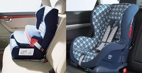

When my first daughter was a baby I couldn't get an ISOFIX capsule (Britax do one now). However when she could sit I got the Audi one made by Hugepak. It's the left hand one below. Although the restraint looks strange. It is actually excellent, and good for a toddle to sleep on. Also when the child is older (it is suitable up to around 6 years) the belt is so much easier to use than the 3-point harness.

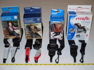

When our second daughter was old enough, we bought a new Graco seat for our eldest. Seats for older children are designed to use the normal seatbelt (there is usually an extra hook at shoulder height to keep it low), so the seat is not held down. This is not a problem when the child is in it, but when they're not and you're driving round a corner...
So I also bought a LATCH strap which allows me to secure the seat to the ISOFIX points. I had to buy this from the US.

If you decide on the Audi seat (the one with the cushion which the kids lie their head on when small) then let me know as we have a virtually unused one which we will be selling. I think they are something silly new like £160+ !

Anyway, yes you'd need a strap to keep your Graco seat secure. I have the Century/Graco EZ Latch as shown above. It fits the Graco Junior very well. If you have any trouble getting one let me know - I may be able to find details of where I bought mine (mail-order from the US).
