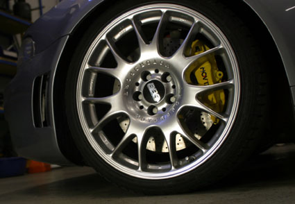

Jani means my car and yes it is very scary to drive with the standard brakes on a racing track! You can drive maximum 2 laps fast and they´re all gone and then You just have to hope for the best
Well now I have Movit´s 370x35mm at the front and they seem to work very well, hope I get soon to a racing track with them! The only problem with Movit´s is that they do squel very hard when they are cold and it´s very annoying!
- Attachments
- Here´s my new Movit´s!
- movit.jpg (43.33 KiB) Viewed 1557 times
