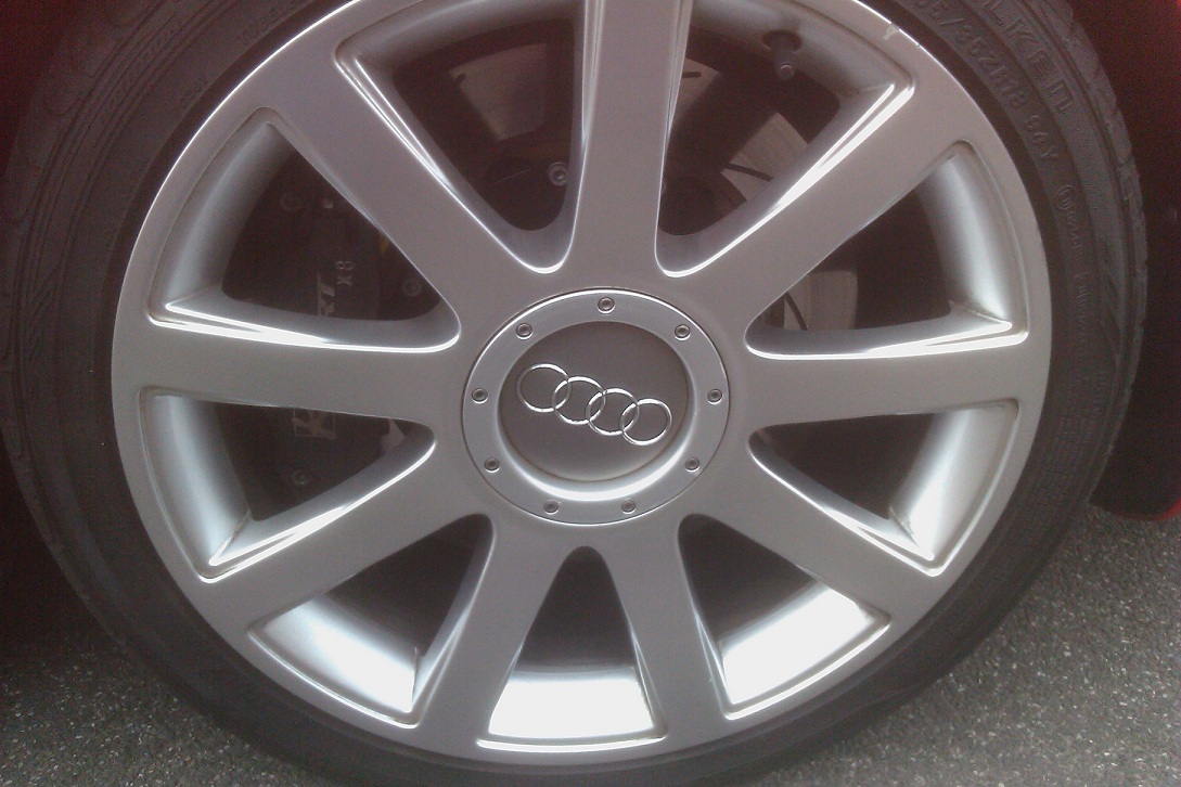

Just as an update to this post....
I ended up getting the KSport Discs and calipers with the YellowStuff pads.
It took about 1000miles to bed them in, lots of grumbling noises until then. Well worth the wait though, the bite on them is excellent, miles better than the stock caliper/discs, it really does stop on s sixpence so I am well happy with this setup, for price and performance they are really good.
Needless to say the steering wobble has gone and they feel like they could stop a steam train..... :)
Take a look at these beauties.... :)

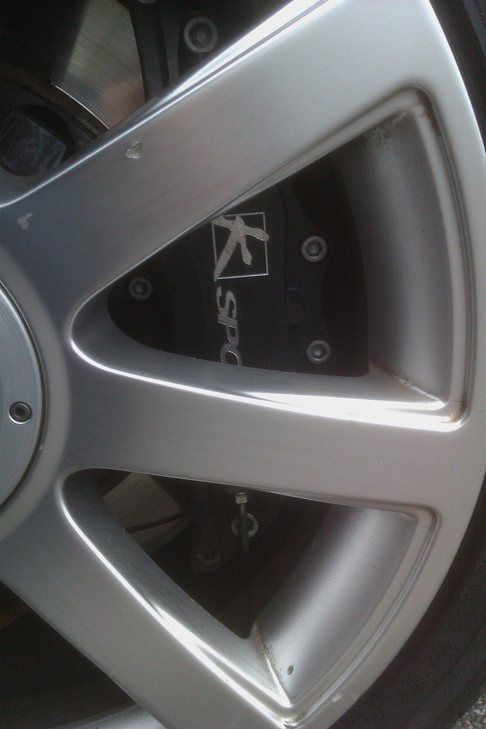

Ahhh yes im thinking about using XYZs version on thoose since im runing thoose on my S2 with good effect. Does KSport offer a rear option to?

Here they are....

I seem to recall that KSport offered a rear option too, but dont quote me, my priority was getting the fronts sorted and the balance of front and rear still feels pretty good.
