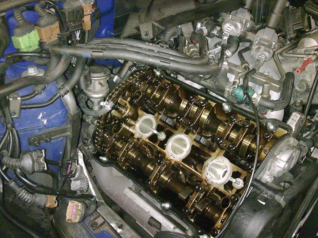

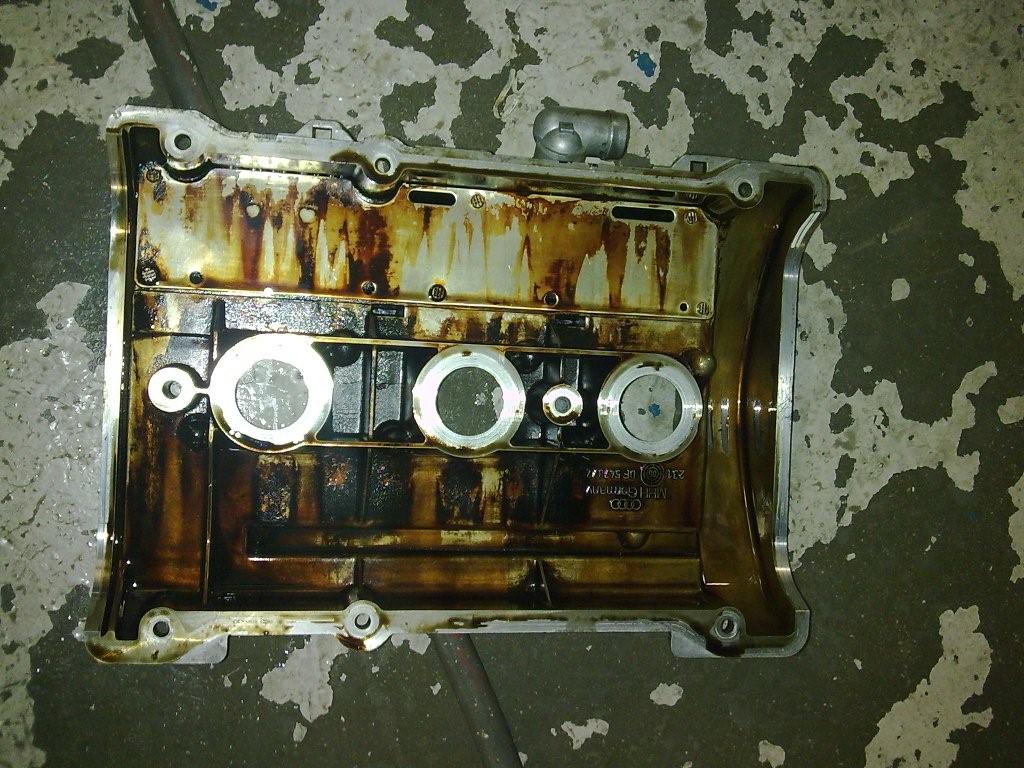

Mine has done under 70k and I've just had to replace the cams, lifters, tensioner and chain on bank 1 - I suspect some of my problem may have been down to tensioner failure or incorrect timing when the belt was last changed by Audi though....
I wasn't expecting the bill though, only spotted it by luck fixing a leaking cam seal after a cam-belt service @ MRC. There had been that much movement in the chain that the top of the cam cover is scored!!!
Cam wear was worse on Exhaust bank, but pitting was visible on both but the major concern was the chipping on the cam cogs - seriously worrying. I urge everyone to check these each service, for the sake of removing the cam covers it's worthwhile doing. Esp if you start to hear some rattles coming from the lifters / followers!
Damage to the Cam Cover

Looking at it and I think I'm right in saying that the cam shafts are identical on each bank for the exhaust I believe - just reversed I think.
Wouldn't this point to either
1/ Oil starvation at then end of the oil track where the pressure would have dropped off furthest from supply?
2/ A manufacturing fault on the Cams?
Basically does the argument for oil issues or type account for the fact that only lobes on cylinders 1 and 6 are getting nailed only.
I can see it maybe if an oil gallery is getting blocked at one end?
Maybe bolts for the caps have been replaced or swapped in those areas as they're meant to be wasted type (on one side of the cap) looking at page 17 of the S4 SSP 198. So the oil cam run up the bolt stem.
Also in the closeup pics the lower (exhaust) cam lobes are bone dry whereas the inlet have a nice track of oil on them...
The majority of the gasket leaks are at the same ends aren't they?
