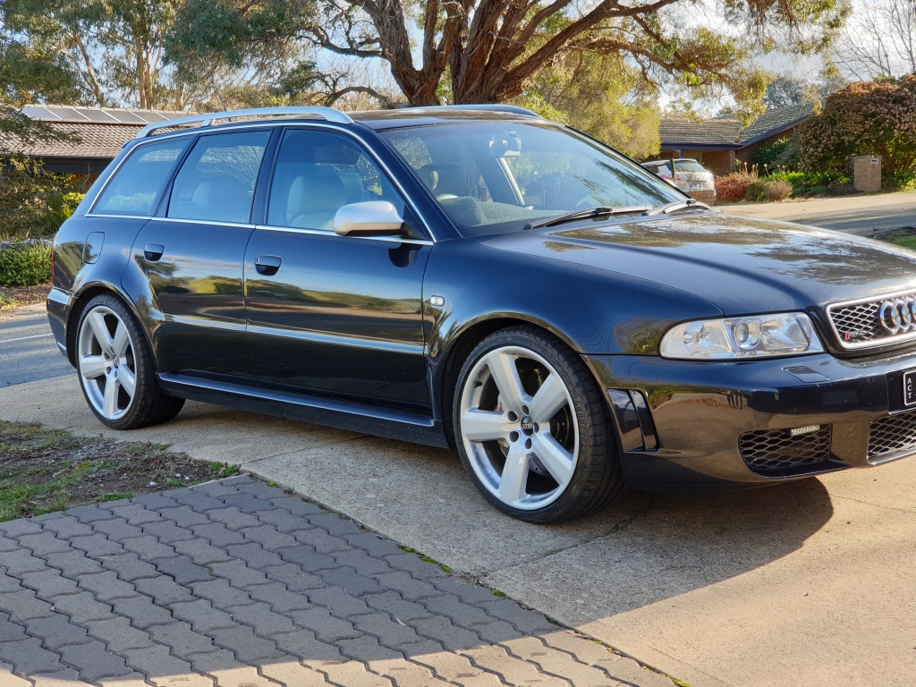

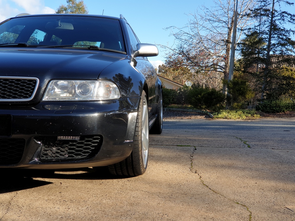

Following on from the tyre failure in the previous post, I had a set of genuine C5 RS6 wheels (ET35) available so thought I'd use those while I work through the 18 inch tyre options. I elected to use 15mm spacers on the front and 20mm spacers on the rear to get the wheels back to where the 18 inch factory wheels sat.
The spacers put the wheel just where I would wish them to be, so all happy and a test drive found no issues.
I'll run these while I prevaricate on the options.
