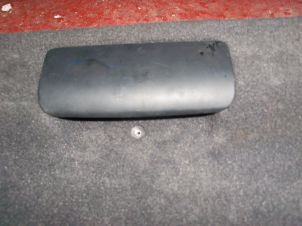

There is 1 screw in the trim by the grab handle which goes in the hole you can see below

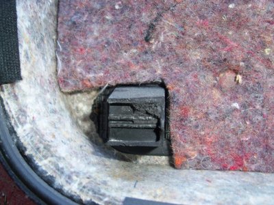

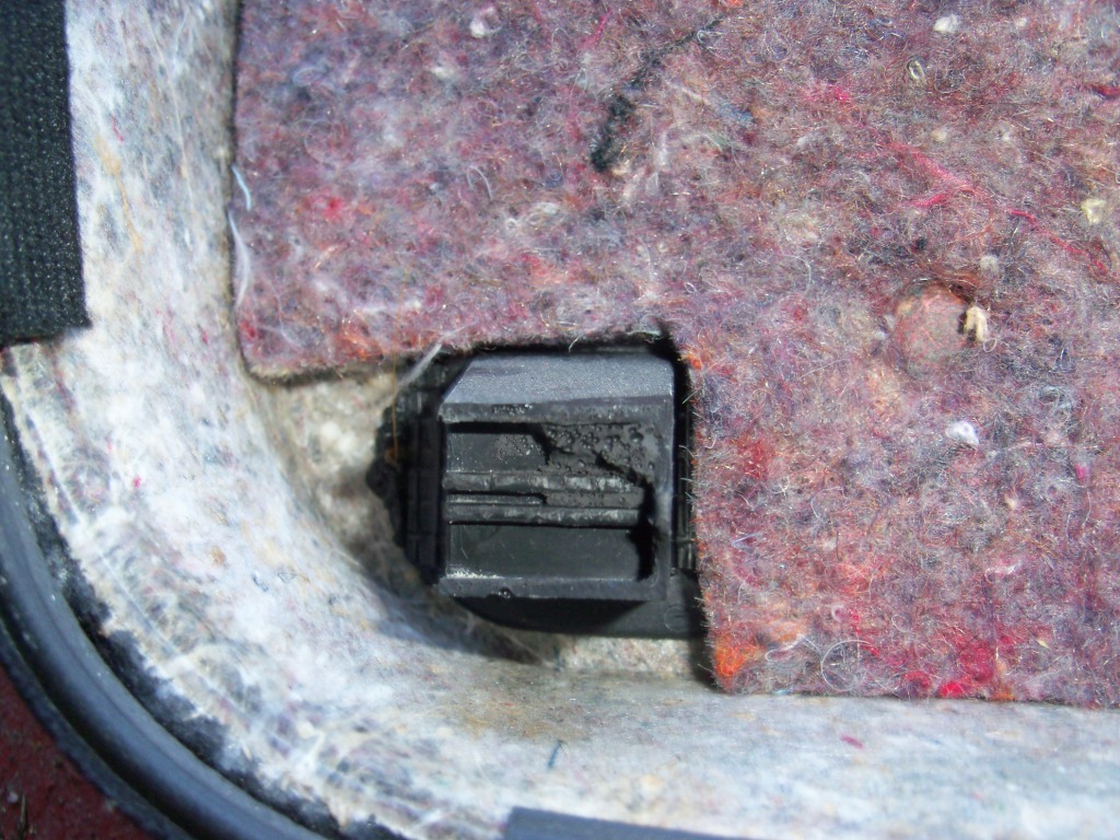

The below shows a broken clip mounting point

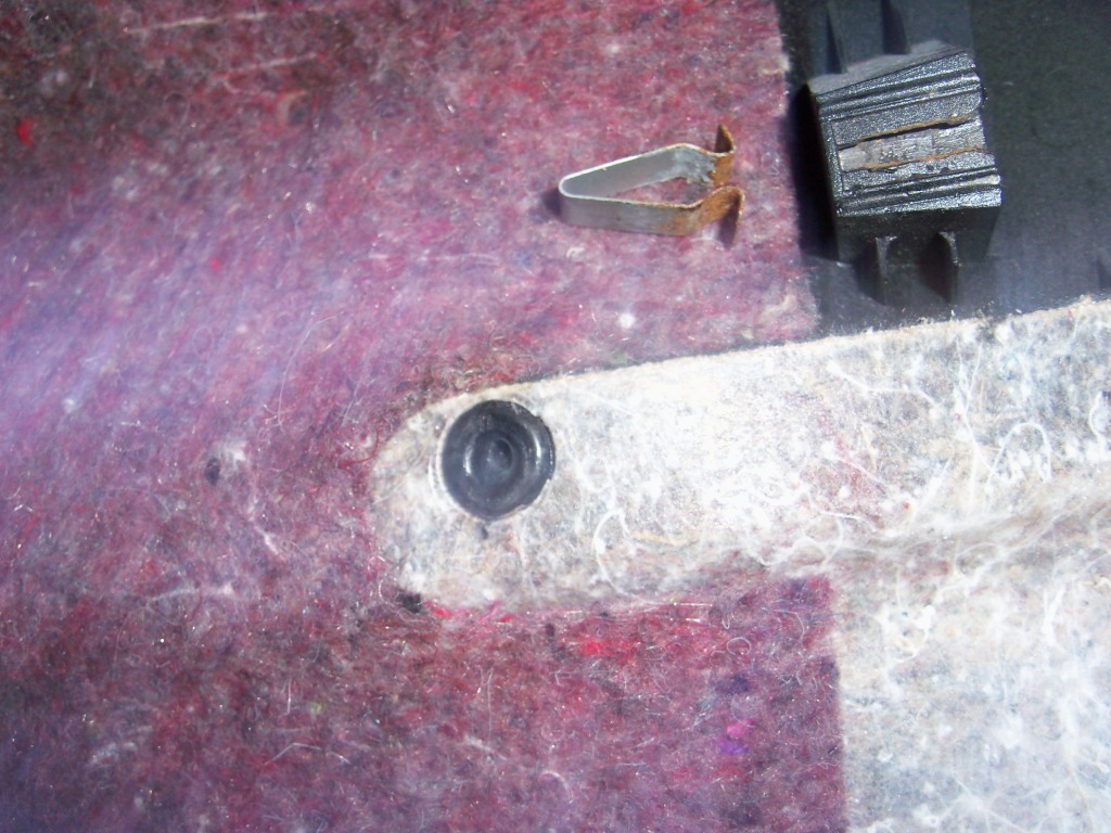

The below shows a clip at the side of its unbroken mounting point

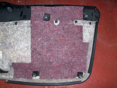

The below shows the location of 4 clips and their mounting points (there are another 4 on the left hand side so 8 in total)
