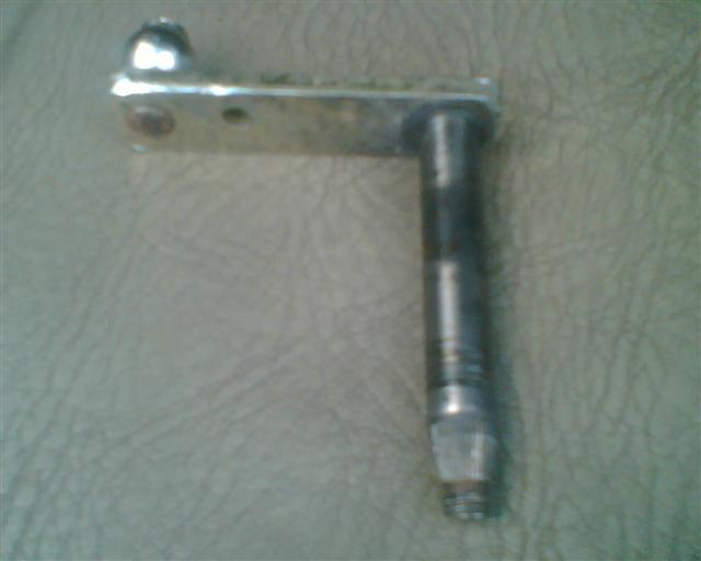

Yes, I know it's been done to death as to the reasons why wipers go slow. I took the whole wiper linkage unit and motor out and found the drivers side linkage spindle thing seized. I managed to get it out, but it was so seized that I damaged the top of the thread doing so.
So, does anyone know if these spindles are available from Audi as separate items and if so, around how much are they (picture below showing part in question)?

I had the same problem, but managed to get it out, clean, and re-fit. I doubt the part is available on its own, and IIRC there wasn't much change out of £100 for the complete system
If it happens to me again, I'll go down the path of spending the money as I think it makes sense. My fixed system took some time, and the wiper judders a little.

Phil, you are right, the two spindles come together with the base unit that they go into. Part number 3B1 955 603 B in case anyone wants to know. It's £78.01 plus vat, which I'm not massively unhappy about. I need it ASAP so I'll have to order from my local dealer.

Thanks Jarv - you prompted me to take mine to bits last night and fix them. Mine were almost seized too - exactly the same as yours. I damaged the end of one of mine slightly too but managed to fix it by running a die back down the thread. Looks like you snapped a bit off possibly? This is the most difficult part - getting the old wiper arms off before you can even start on the wiper mechanism. I ended up using a ball joint spliter to pop the arms off!!
It's tricky getting the wiper mechanism out from behing the ecu box! I reverted to removing the ecu box mounting screws so could pull it back towards the front of the car. Then the mechanism and motor can free. All back together now and works like new. Plenty of grease should keep it working for a good while too.

No probs. I thought someone might spot the short thread! It was my lame attempt at a temporary fix as I didn't have a die set. I just cut the damaged top bit off in the hope that there was enough thread left to temporarily hold the wiper on, which there wasn't. It's not a problem, the car's off the road all week and I have a courtesy car. I ordered the bits last night and they'll be in Wednesday. I took the ECU and it's box out too. If you look on Audi World there's a tech article on how to remove the wiper assembly and it says that you can get it out without removing the ECU with a bit of jiggling. Don't be fooled, I think that's with an S4 and the brake servo assembly must be that bit bigger on an RS4 and that gets in the way.simon_golf_tt wrote:Thanks Jarv - you prompted me to take mine to bits last night and fix them. Mine were almost seized too - exactly the same as yours. I damaged the end of one of mine slightly too but managed to fix it by running a die back down the thread. Looks like you snapped a bit off possibly? This is the most difficult part - getting the old wiper arms off before you can even start on the wiper mechanism. I ended up using a ball joint spliter to pop the arms off!!

Ahh so you cut the end off !! Makes sense. Mine wasn't really that badly damaged just one thread was a bit squashed where I smacked it with a hammer!
