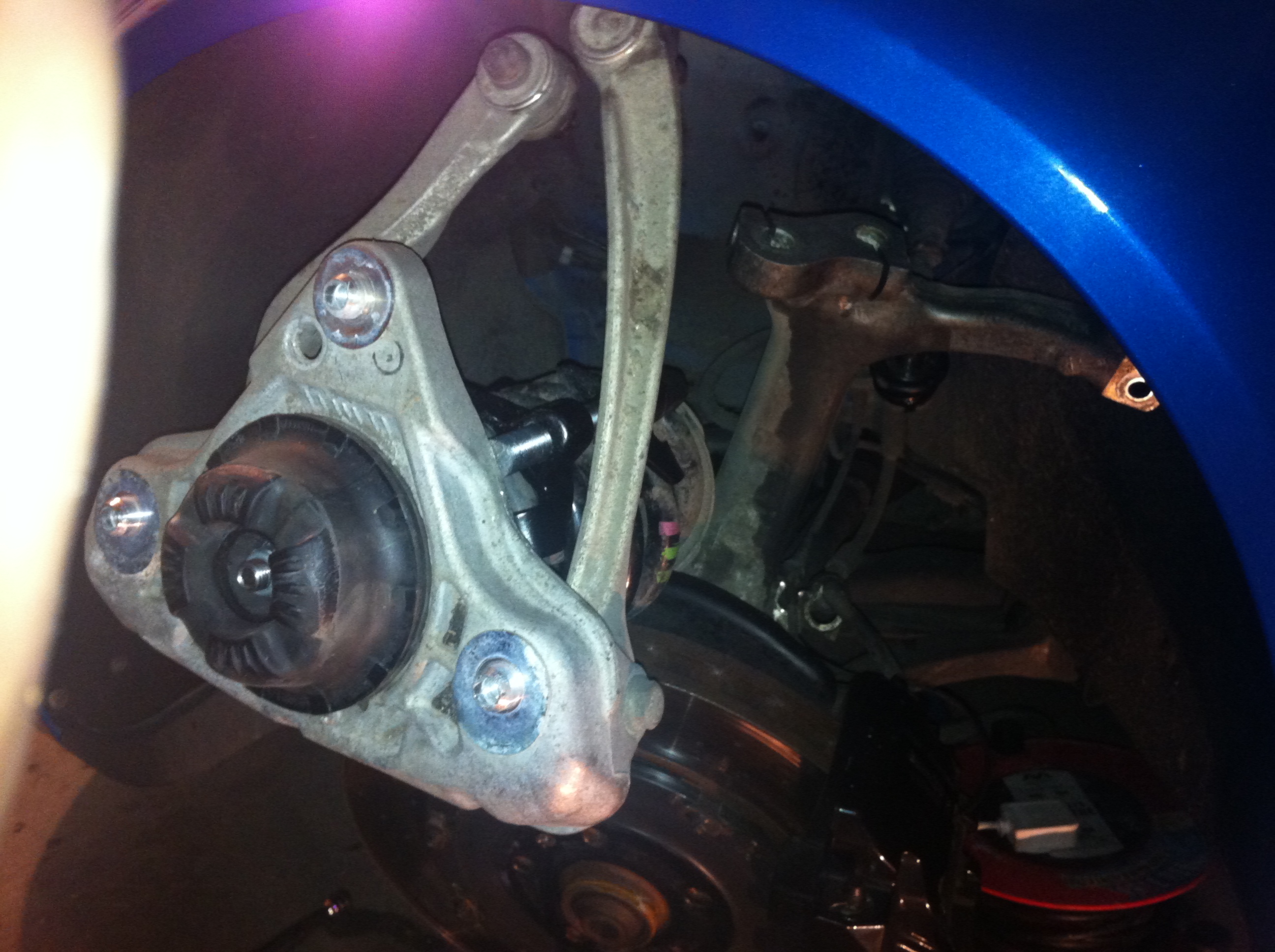

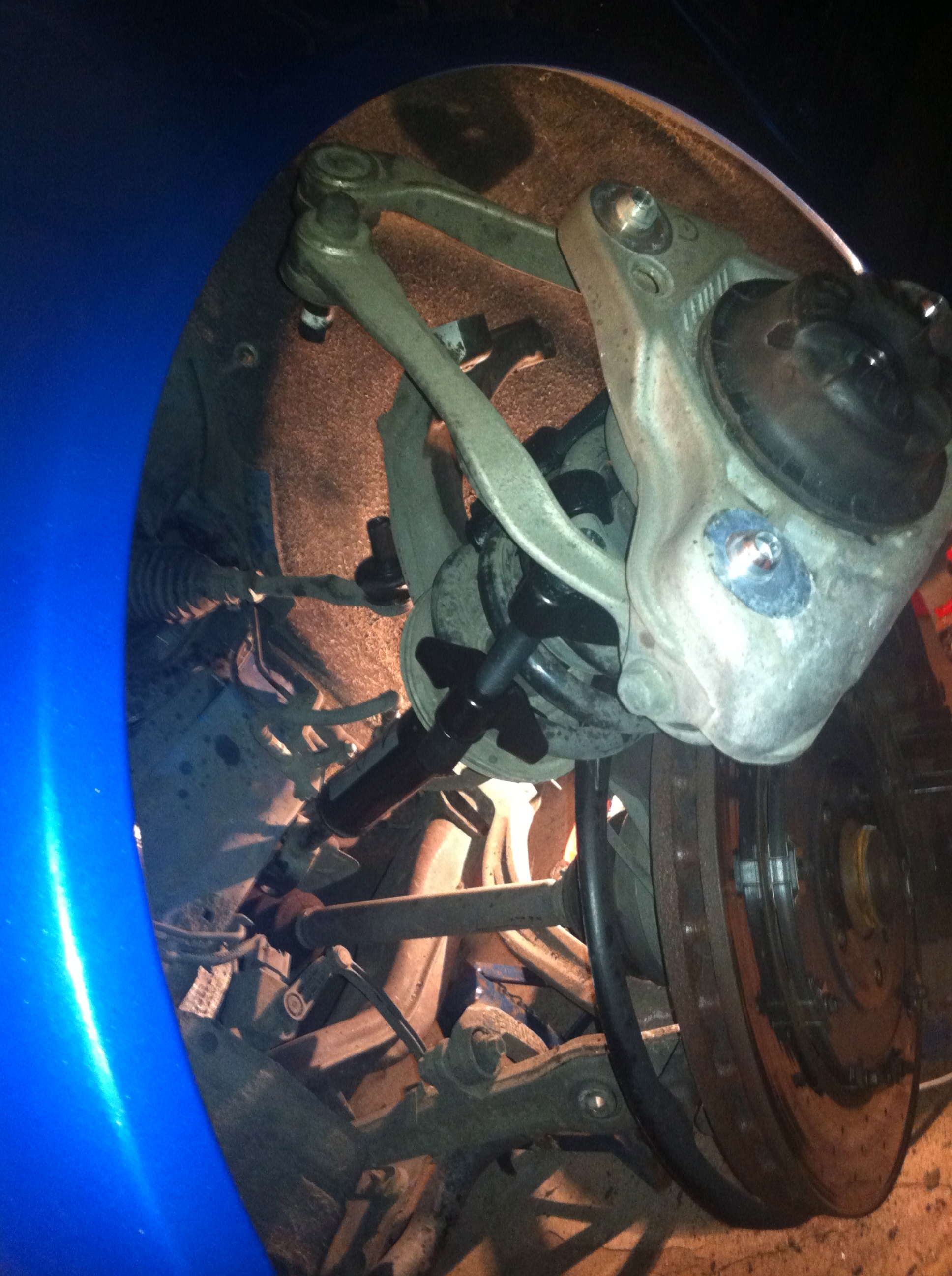

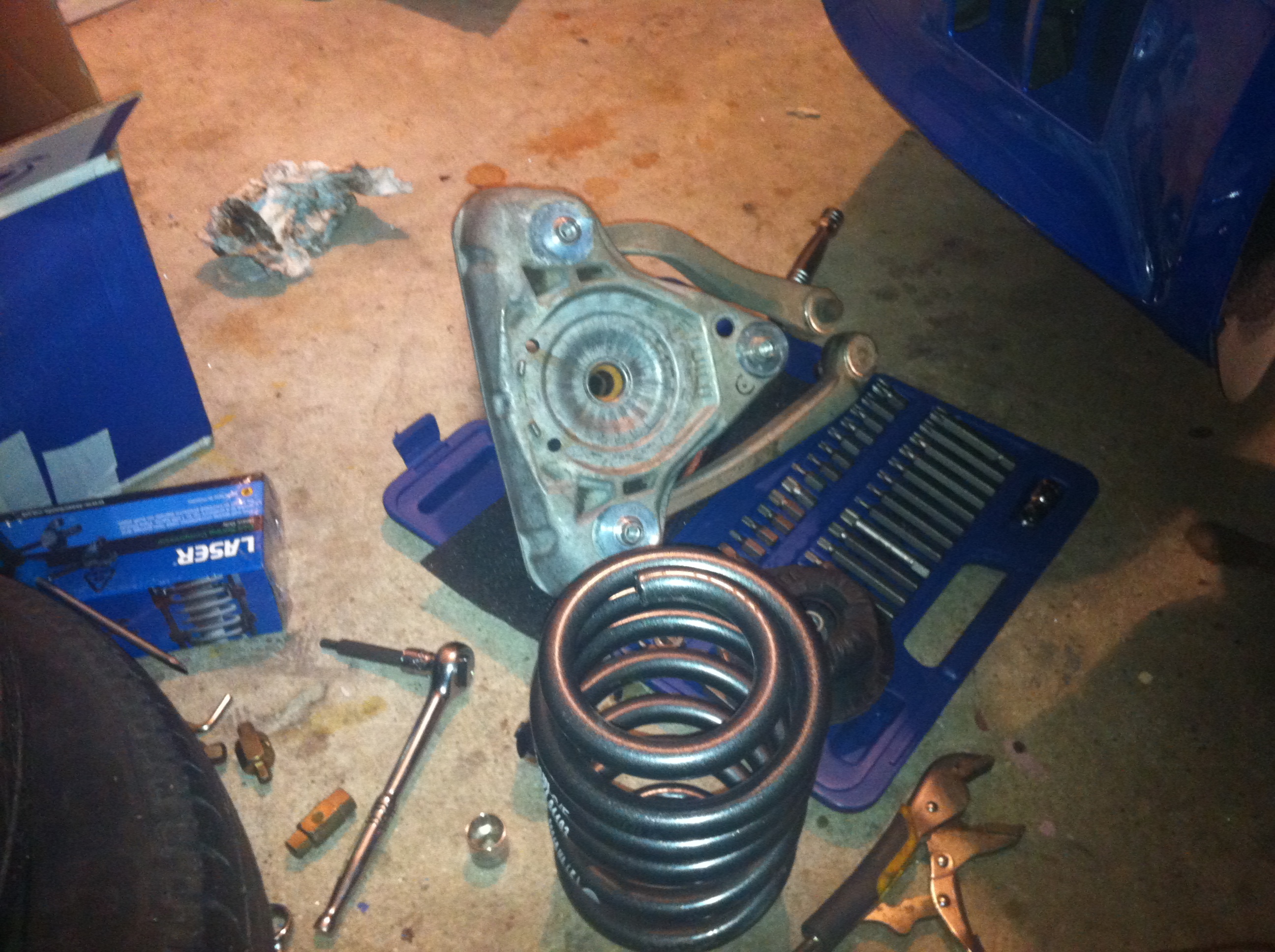

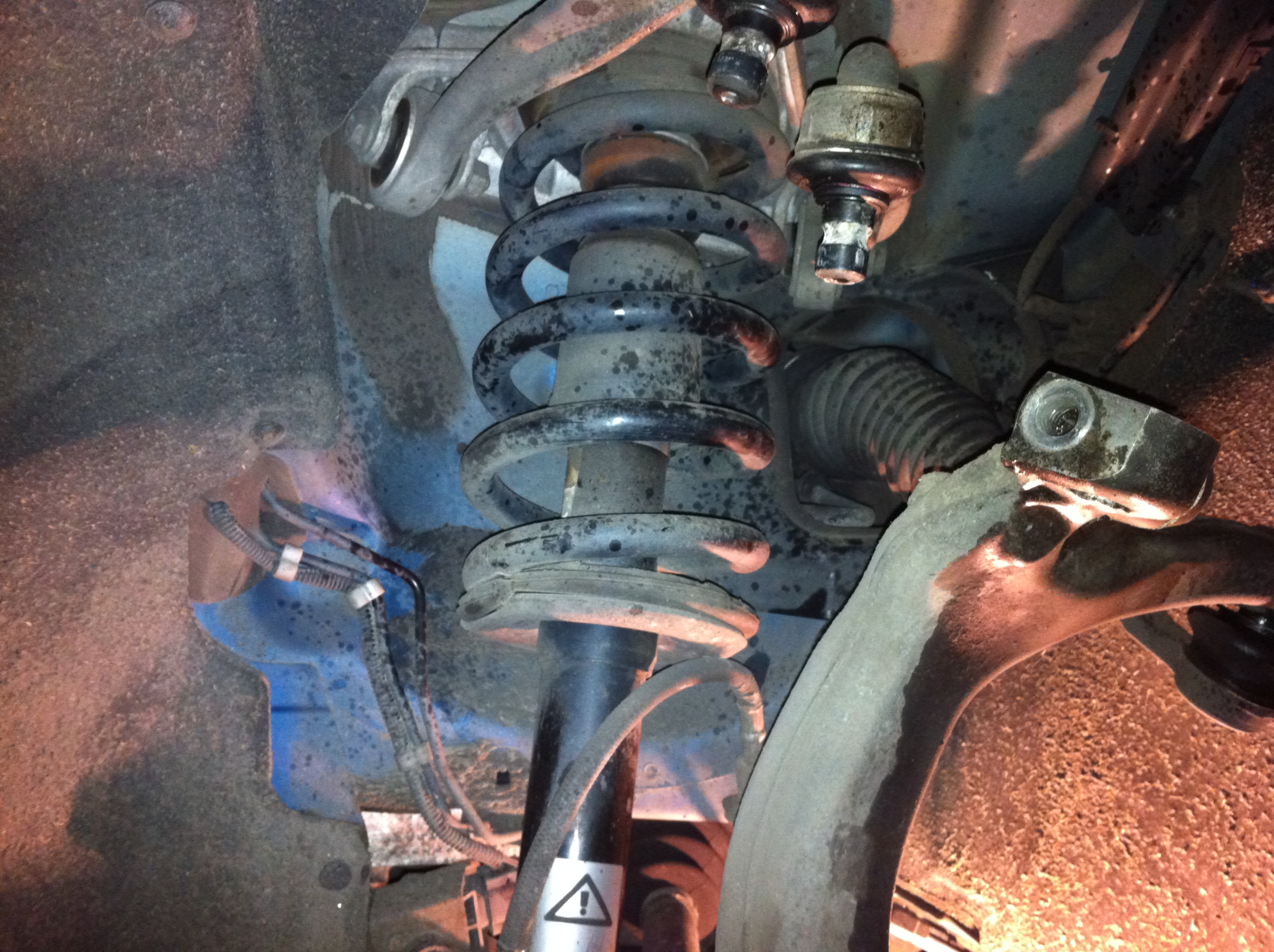

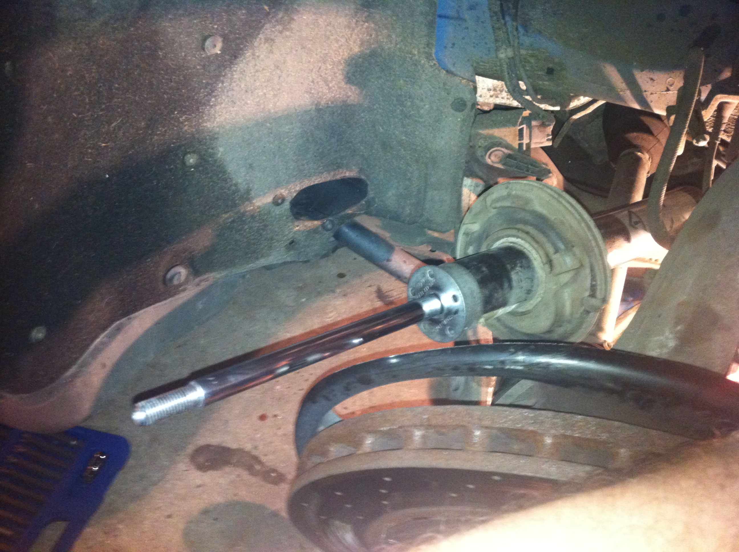

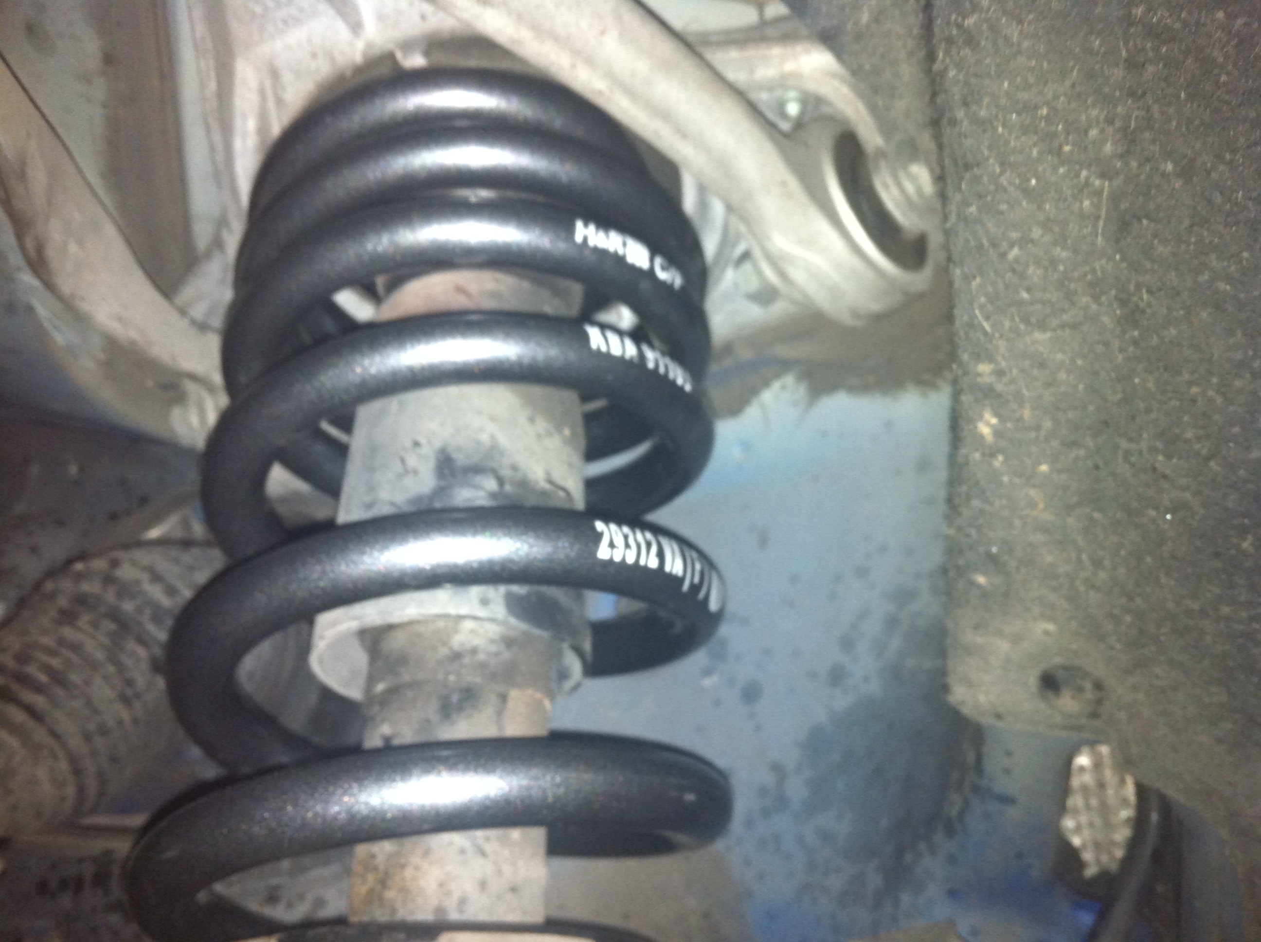

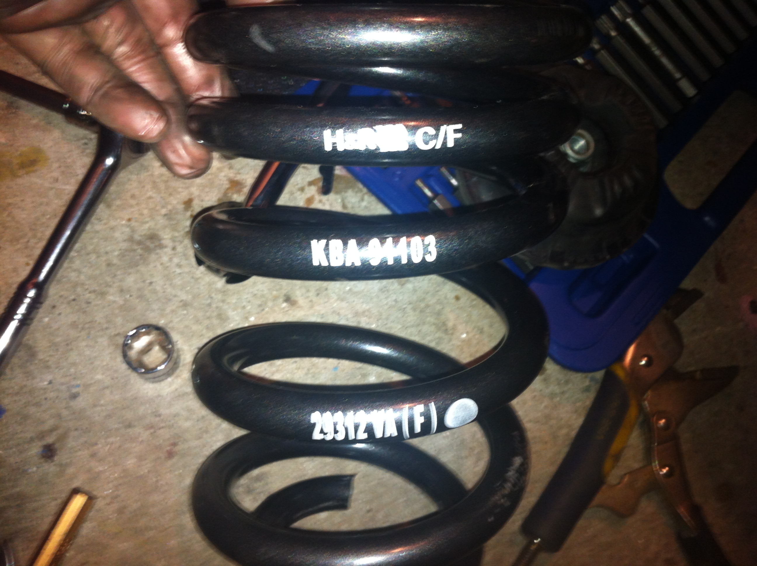

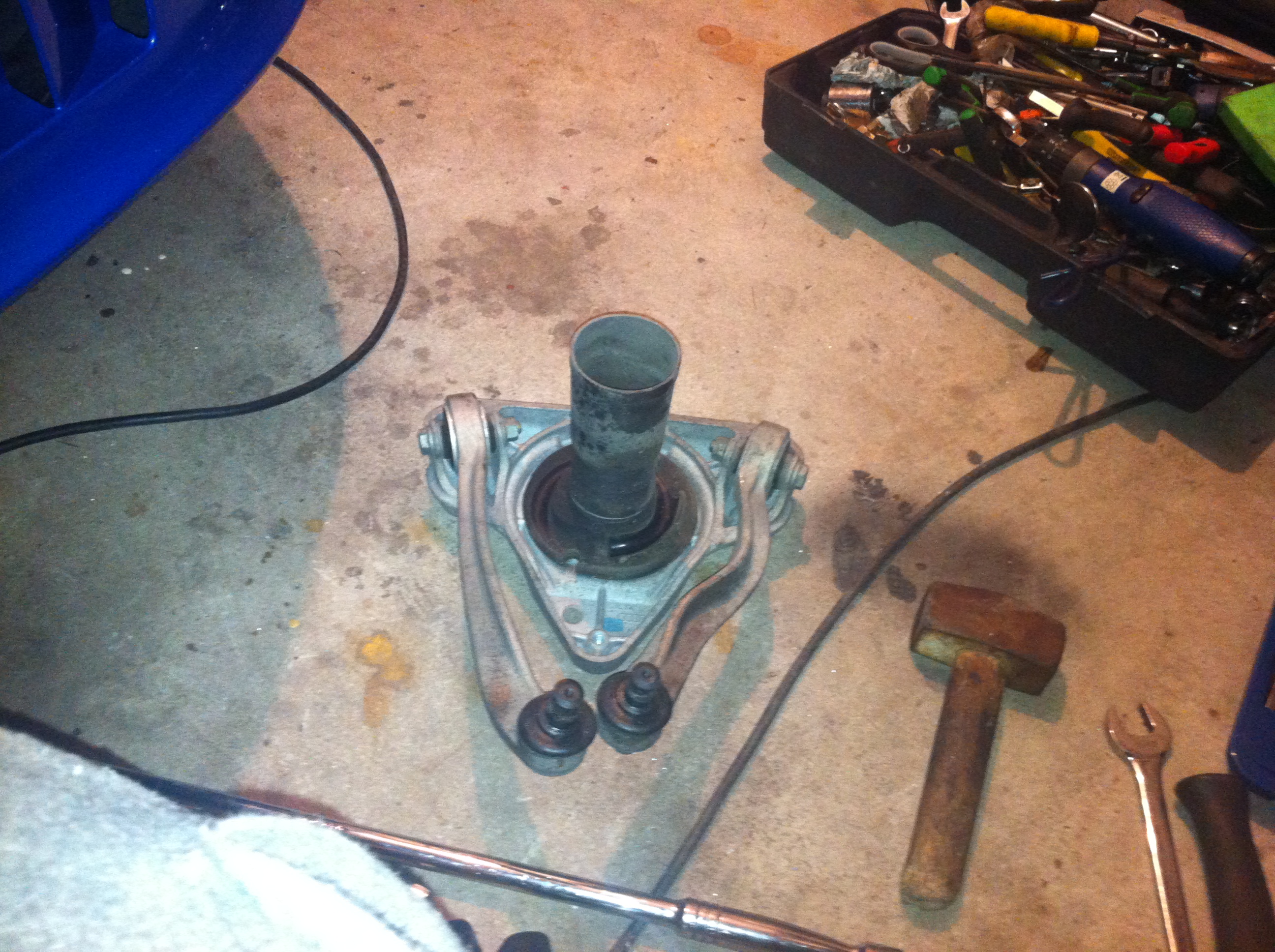

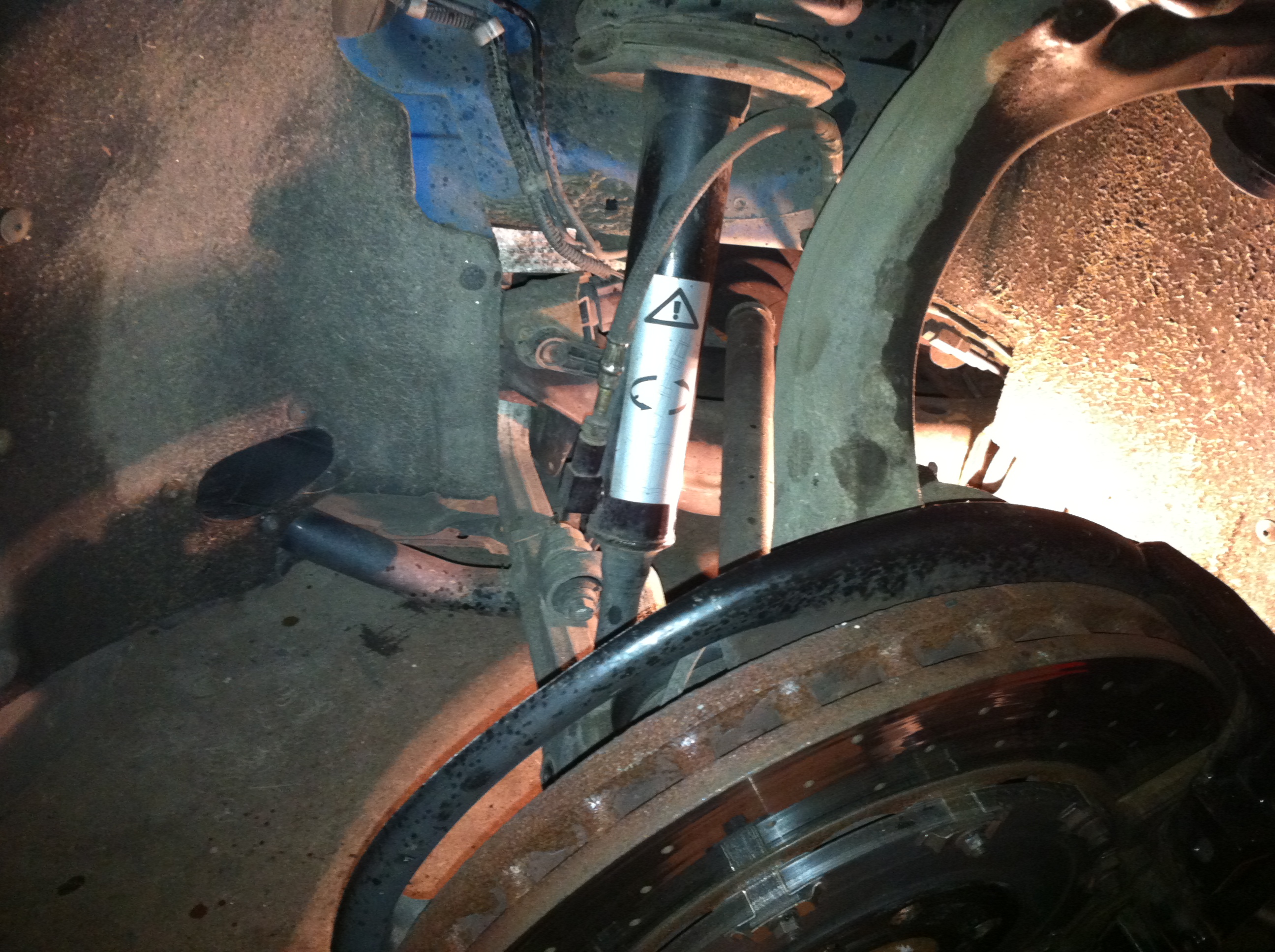

Heres a few pics of me removing the old springs and fitting the H&R ones, i will post some after pics later as i haven't taken any yet just been enjoying driving it to much :biggrin3:
RS going in.
Removed the top arms.
You have to compress the spring before removing the strut be very careful not to damage the DRC hose as it gets very tight when your pulling the strut out, the spring commpressor i bought from halfords for £30 but i had to modify it by cutting the bolts down so that it would fit when the spring was compressed.
Now remove the top nut and remove the spring.
Spring removed :)
Top mount removed.
H&R spring, just commpress the spring slightly as you will not be able to get the top mount nut on, i just used one side as i couldn't get both on which just does it.
Strut fitted with new spring.
