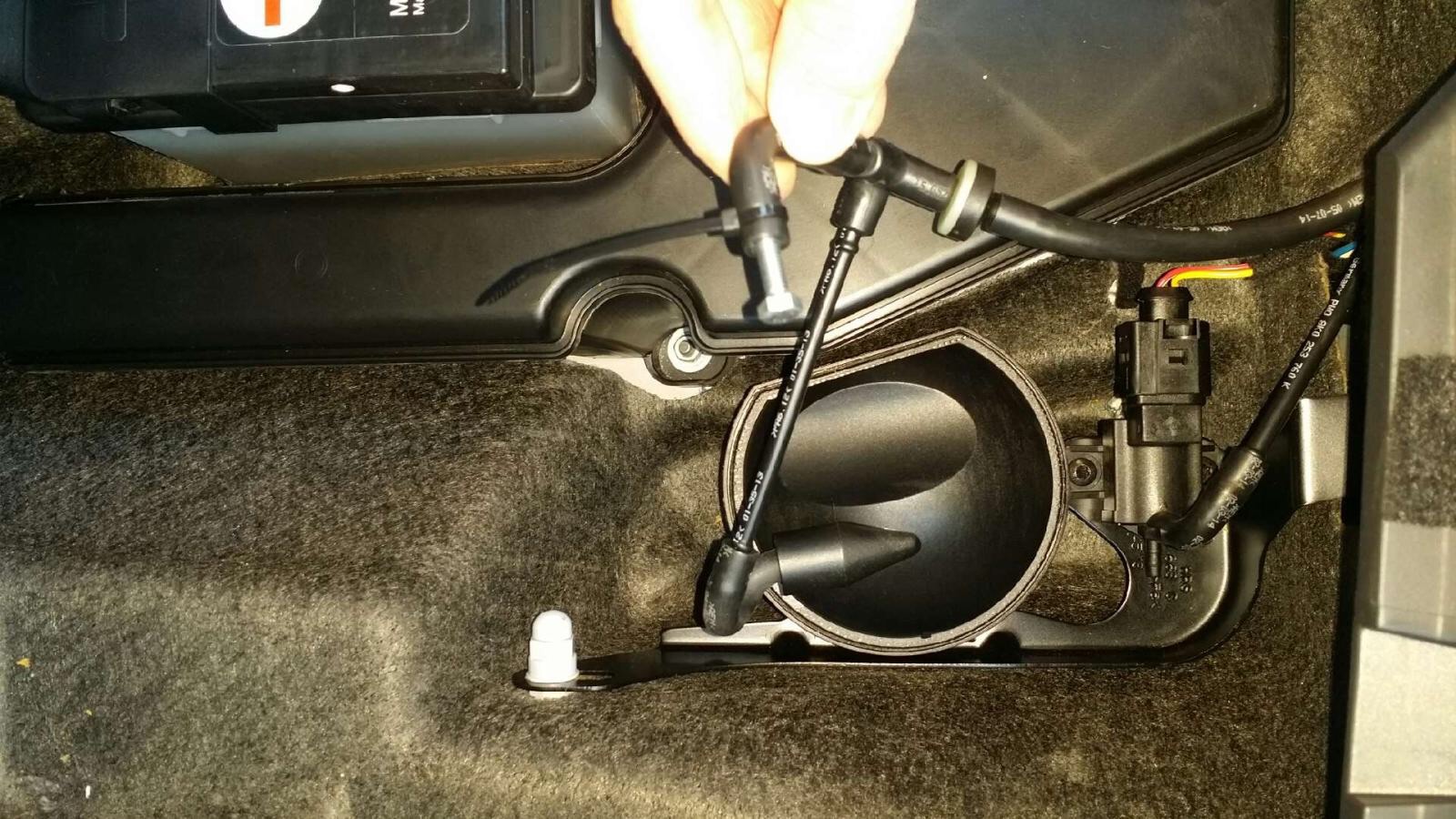

Not sure if this has been covered, but it's such a simple mod to do.... Car sounds like thunder without having the aggressive gearbox settings and the downshift blips ! Totally reversible too.
Place a self tapping screw in the vacuum pipe after you've selected the sports setting. Enjoy :biggrin3:
Access is in the boot, by the battery.

No, the valves open at a certain speed in dynamic, open all the time in sport and never in comfort.
If switch the car into sport by pressing the gearbox lever down, the valves open. That's fine, but for general driving I find the gearbox shift/attitude too aggressive and the loud downshift blips are a desired taste for normal town driving.
With this mod, you get the valves open all the time, but the comfort of driving the car more sedately ?

And this mod, puts the the exhaust into the full in 'S' setting.
Which is, let's face it what you want with that lovely v8. Not too intrusive, either.
