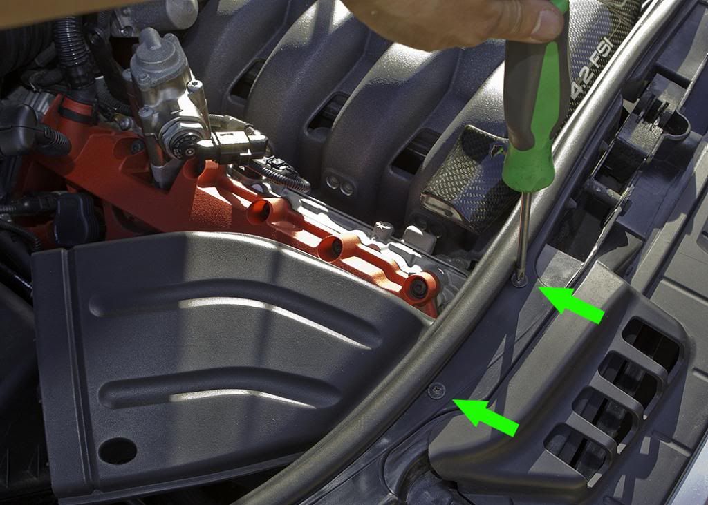

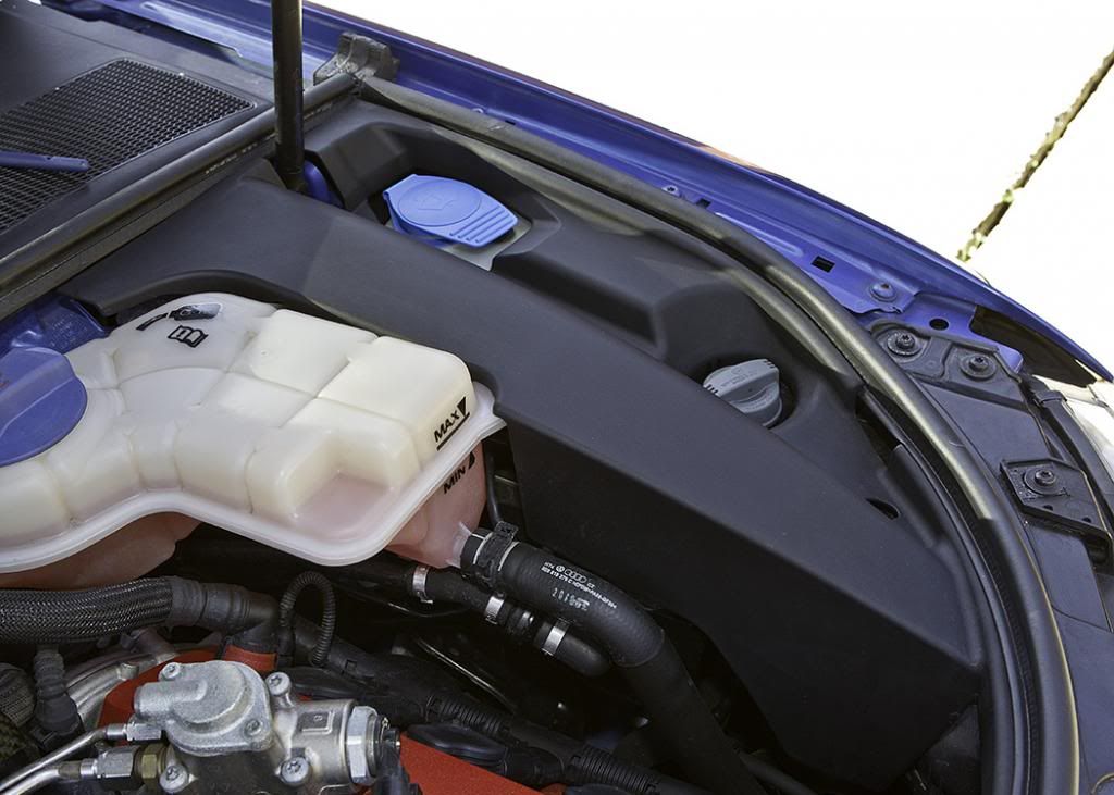

Step 1
Removal of the plastic cover on the right hand side of the engine bay, this covers the PAS reservoir and the washer fluid reservoir.
Take the T30 torx bit and remove the screw located at the front, this winds into a clip located within the front slam panel. Once the screw is removed you can lift up the front part of the plastic cover and it will pull off a rubber locator next to the coolant reservoir.

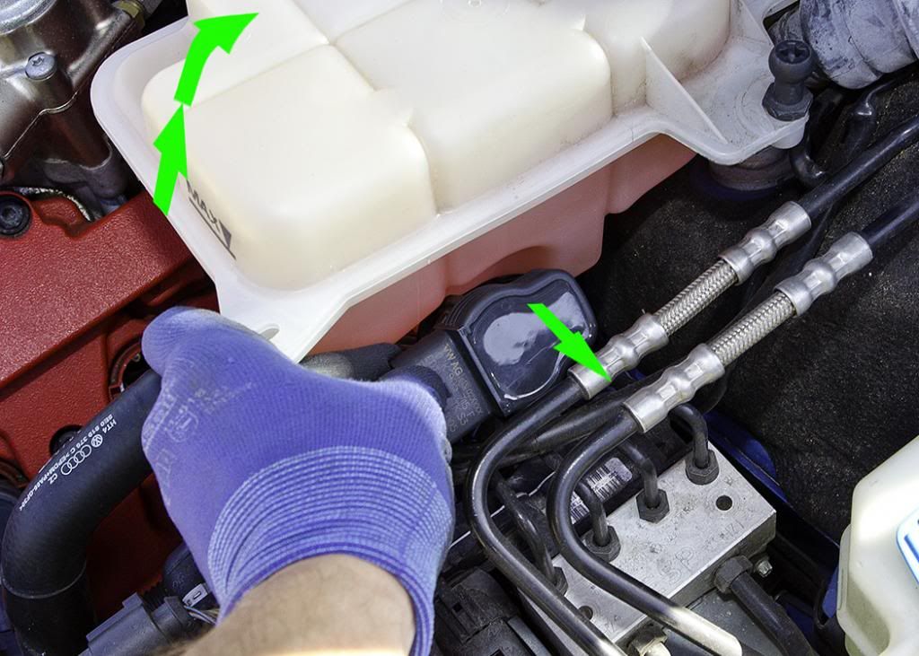

Step 2

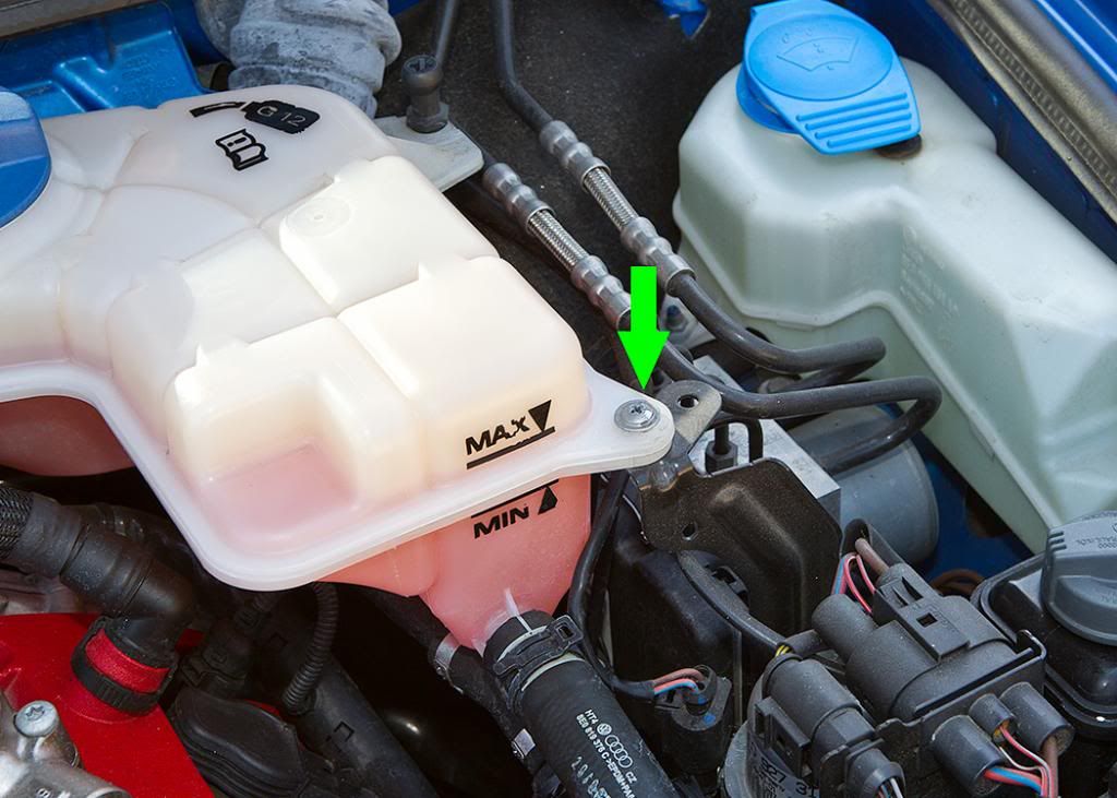

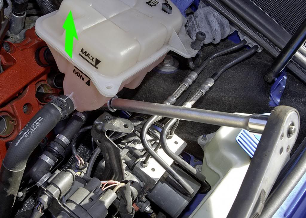

Take Phillips screwdriver and remove the screw located on front right hand side of coolant reservoir. The official Audi documentation will then have you clamping both coolant hoses and draining the tank down. However, with a little patience further on, it isn’t necessary to do that; there’s enough slack and movement in the system, to wiggle/manoeuvre stuff around it. So I elected to just remove the screw; the choice is yours.

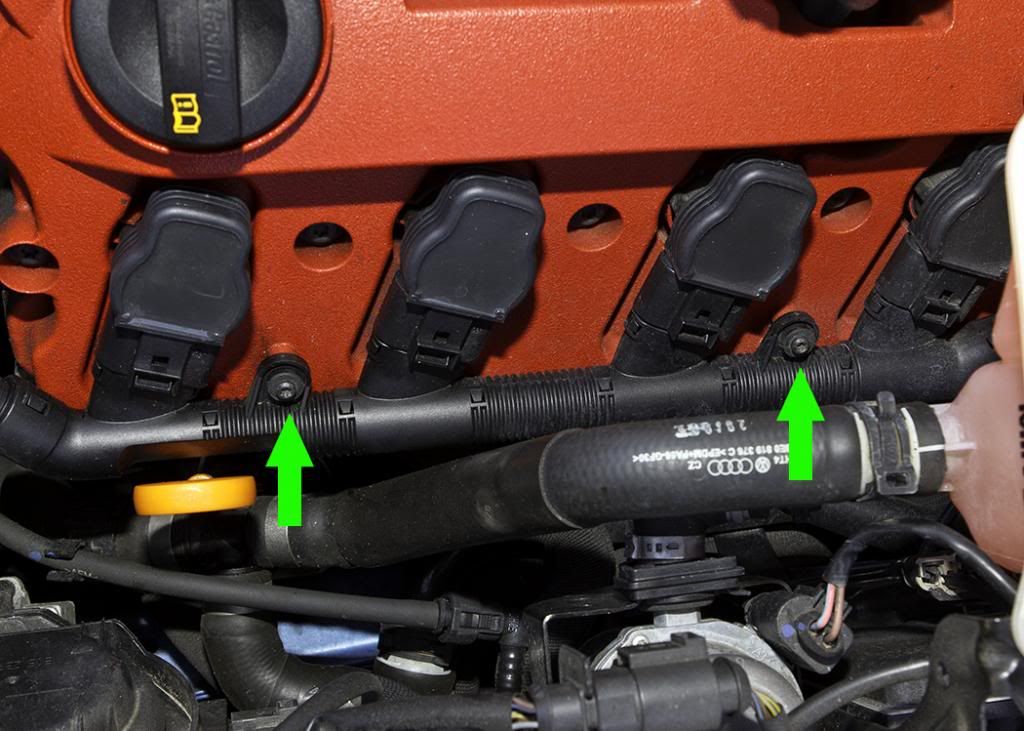

Step 4

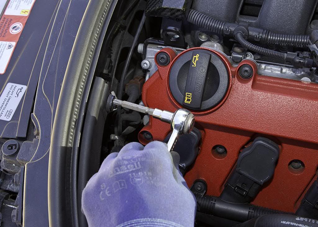

Take the T20 torx bit and remove both screws that hold the coil pack wiring loom onto the red valve cover.

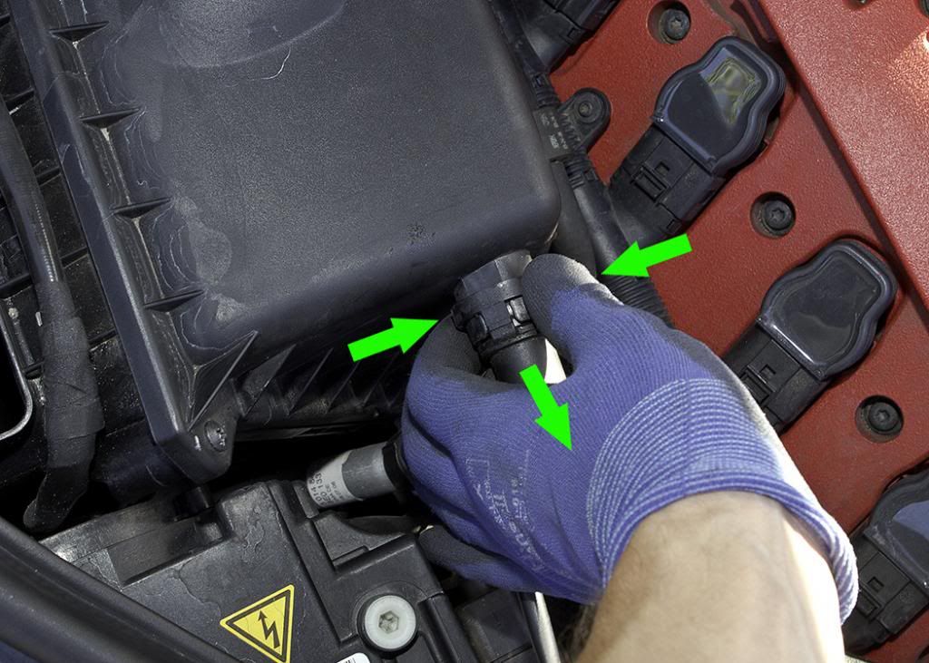

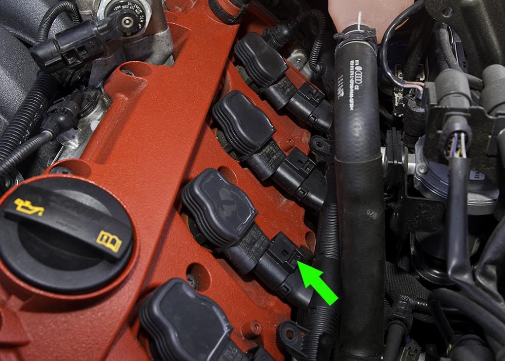

Now for the first fiddly bit – Unclipping the coil pack connectors. There is a couple of movements required together in order to undo these.
1) Press the plastic bit I have arrowed downwards firmly
2) Whilst doing the above, push the clip into coil further until you hear a feint but audible click.
3) Once you hear the click, you can then wiggle the connector off from the coil.
4) Start on the one nearest the oil filler cap first to practise as the rearmost one is harder to get onto.
5) If you are struggling with this step then walk away and get yourself a drink, come back to it 5 minutes later - a screw driver does not help here and will only serve in breaking the plastic clip.
Step 6

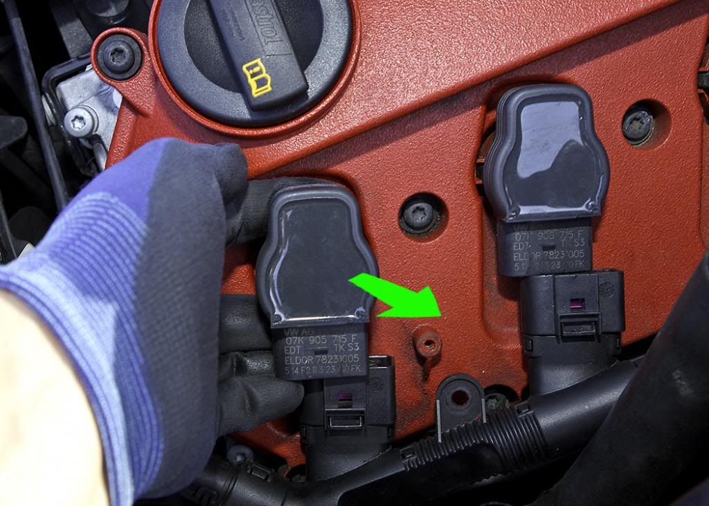

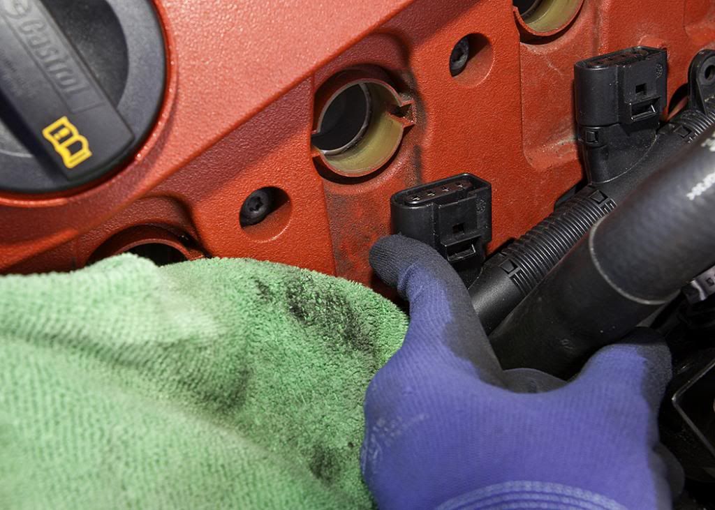

Removing the coil packs. Audi have a special tool for doing this but it can be done by hand. I squeezed my fingers under the coil pack edge as detailed in the picture (use both hands though) and then wiggle and pull up at the same time. Do this for all four coil packs with the last on being rotated 90 degrees whilst lifting the coolant reservoir as indicated in the second picture. On the underside of the coolant reservoir is a sensor; it didn’t get in my way, but for those with big hands just be mindful of its position.

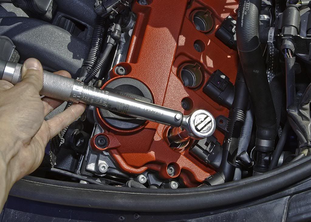

Take the new plugs and screw them back in clockwise, I like to do this by hand without the ratchet until I can no longer turn them. Set the torque wrench to 25nm and tighten them all up, then adjust the torque wrench to the final recommended setting of 30nm and tighten all four again.

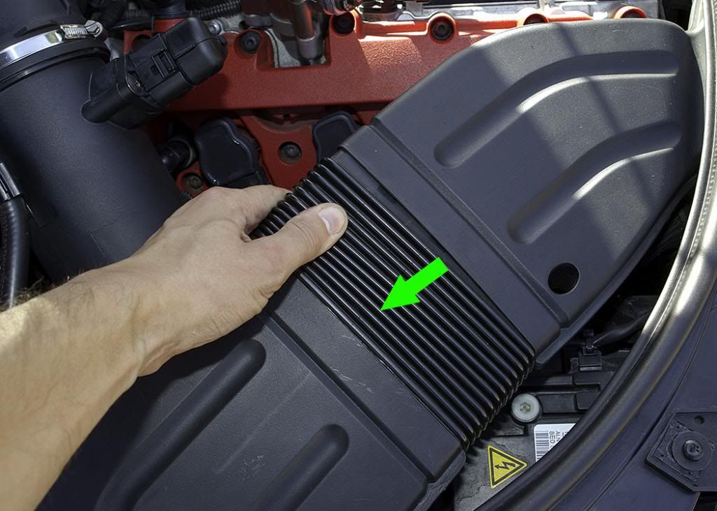

Split the air inlet feed. Use both hands and just pull back the corrugated section; it should separate from the front part fairly easily. When it comes to refitting this part later on, pay particular attention to getting all the clips both top and bottom locking in right, before pushing it back together.

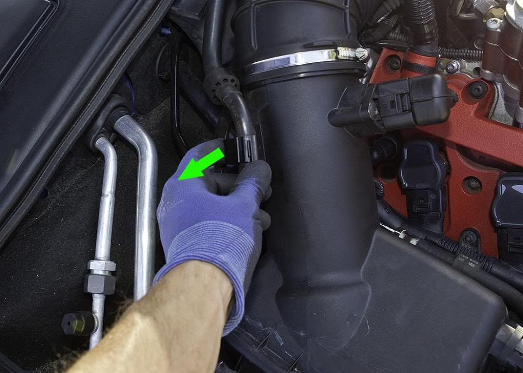

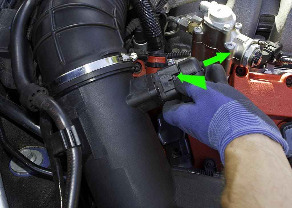

Unplug Mass Air Flow connector. This connector works exactly the same way as the ones that plug into the coil packs. Refer back to step 5 to re-familiarise yourself if not sure.

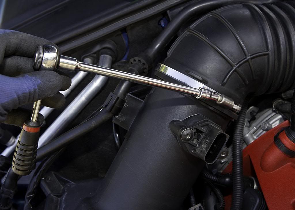

90mm flexible air inlet hose. Take the 7mm socket and loosen the jubilee clip, this will enable you to slide the hose from the Airbox lid/MAF housing.

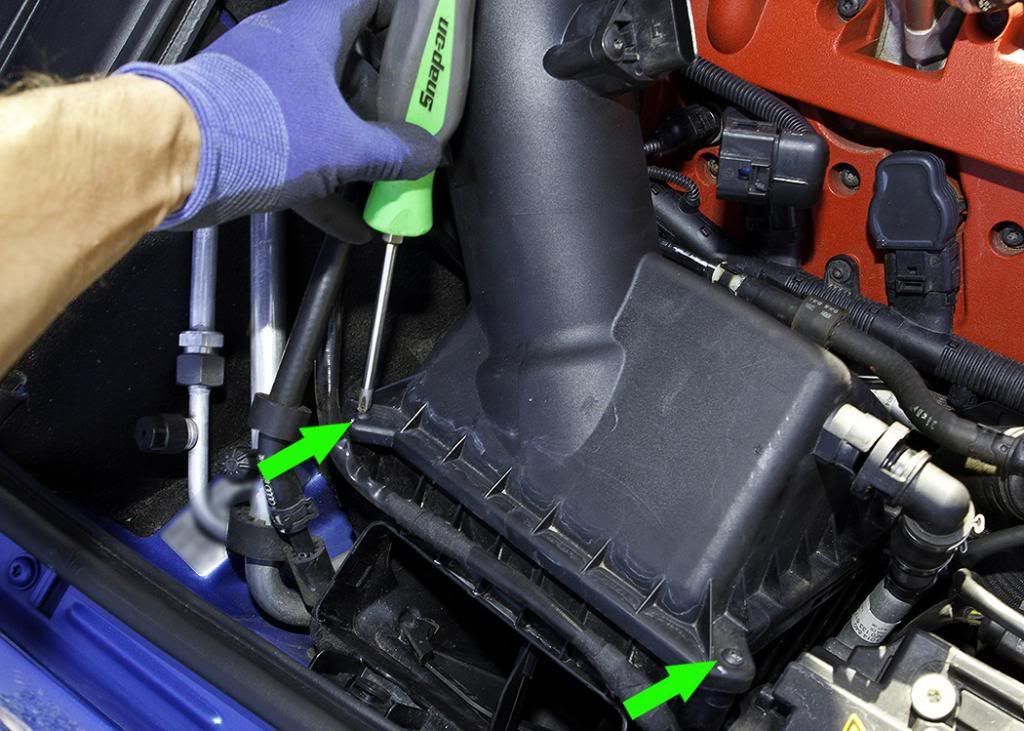

Step 17

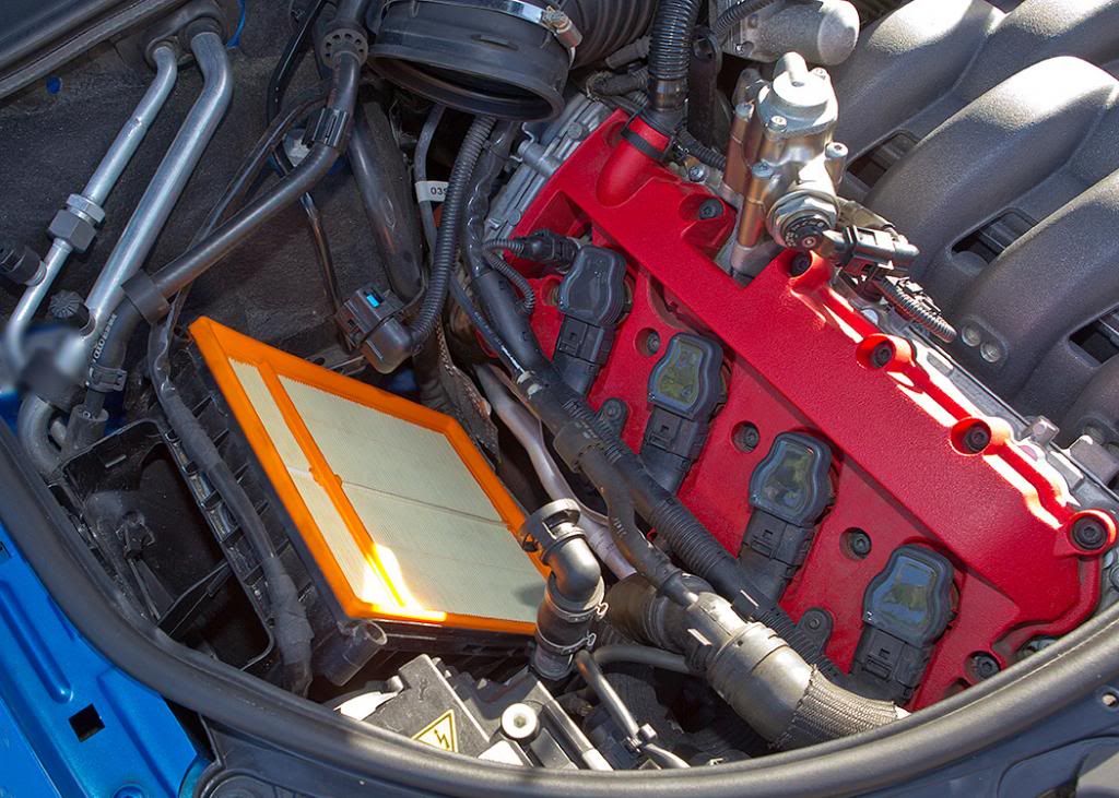

Airbox lid. There are finally two Phillips screws that need to be removed as arrowed in the picture. Once done the housing lid will lift off and out, leaving you sufficient access space to carry out the rest of the work.

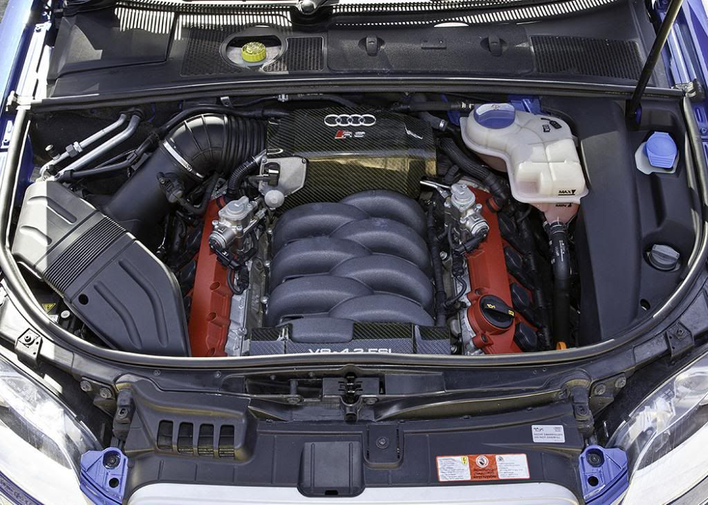

When finished, the engine bay should look like this. Job done.

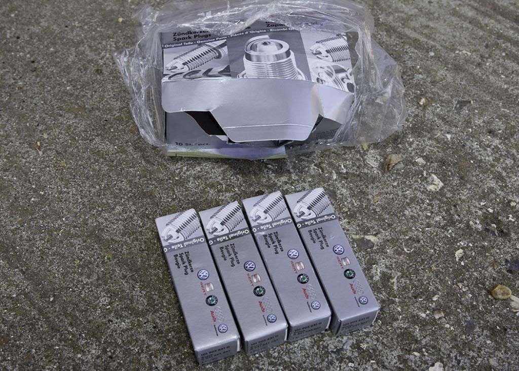

Am I right in thinking the plugs can go in straight out of the box and the gap is already correctly set?
Was looking on the NKG website and that's how it read, can anyone confirm?

Post by Batfinnk » Mon Sep 09, 2013 7:09 pm
Not sure about NGK's but I put the Bosch quad tips in mine so no adjustment needed on them.

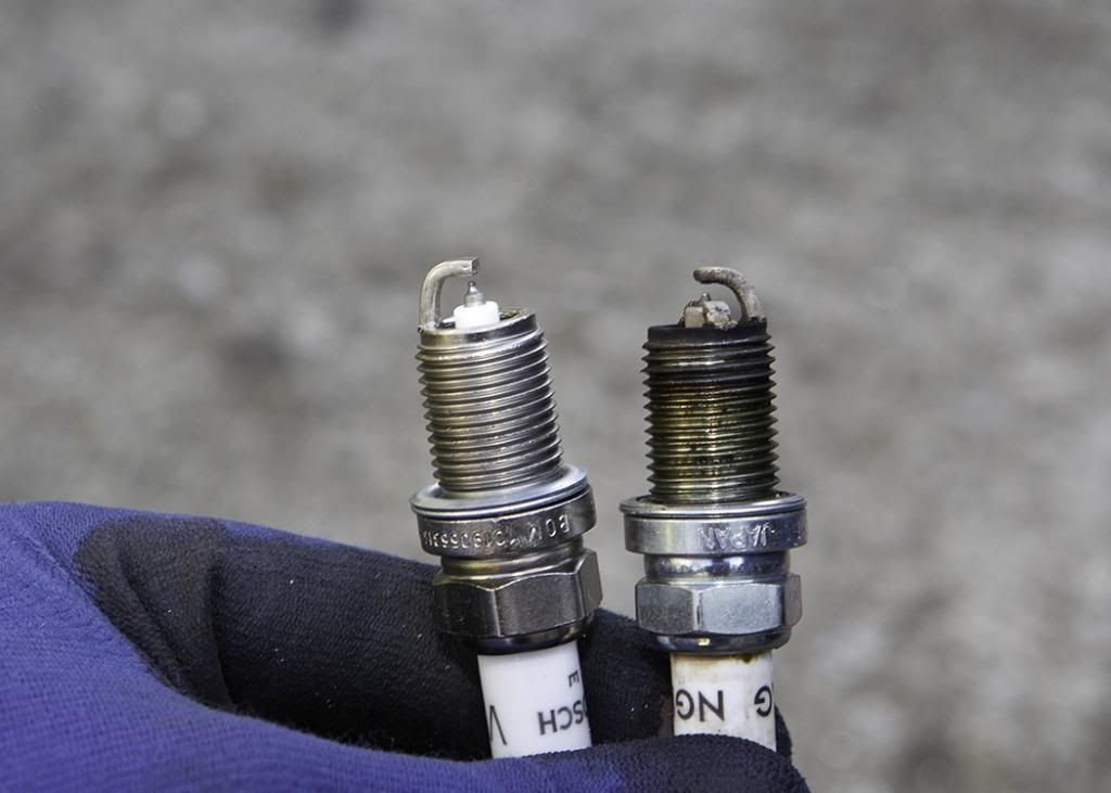

Batfinnk - Good point about the plug socket rubber.
With regards to the gap, I could find no definitive size. NGK say that theirs are pre gapped for the RS4 application. However I was supplied the Bosch ones because they superseded the NGK item, due to some NGK's suffering from broken cores according to my dealer.
The old NGK's I removed measured 0.9mm and the new Bosch one were measured at 0.7mm. After fitment my engine gained greater urgency to rev out past 5000rpm, I had the kick previously, but it's now more pronounced. I just attribute that to new plugs though.

Great write up, thanks for taking the trouble to take all the photos too. I would add that removing the expansion bottle is fairly easy as can simply be syphoned empty and then once is removed can suck a little bit out of the hoses or bung them - I did a guide on changing the bottles over to make the engine bay look newer so could be worth doing at the same time, likewise an ITG filteron the other side.

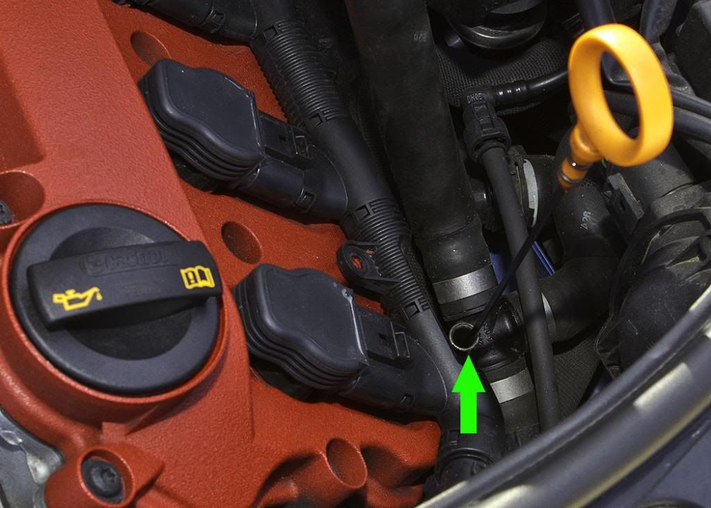

One little tip that may help others is that I struggled to get the coil packs out that were nearest the header tank as it was an awkward spot, so used VERY light leverage with a lever bar with cloth underneath so as not to damage the valve cover. I must stress it was only very light leverage and it worked a treat for the awkward buggers under the header tank.
