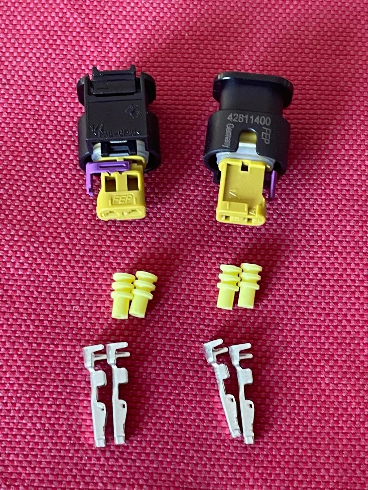

So a quick update, I have found a seller online listing these as equivalent;
MCON 07P973702 , FEP 42811400
and they do look the same apart from the crimp retention mechanism which shouldn't affect this, so I have ordered a pair (so I have a spare) to see if they fit, watch this space ...

Just to close this one off I can confirm the equivalents ordered as above fit like a glove, I don't have a retention clip on bank 1 still but its a tight fit with the weatherproof seal so we will see how it goes. Those pumps are expensive just for the lack of retention if I can get away with it.
