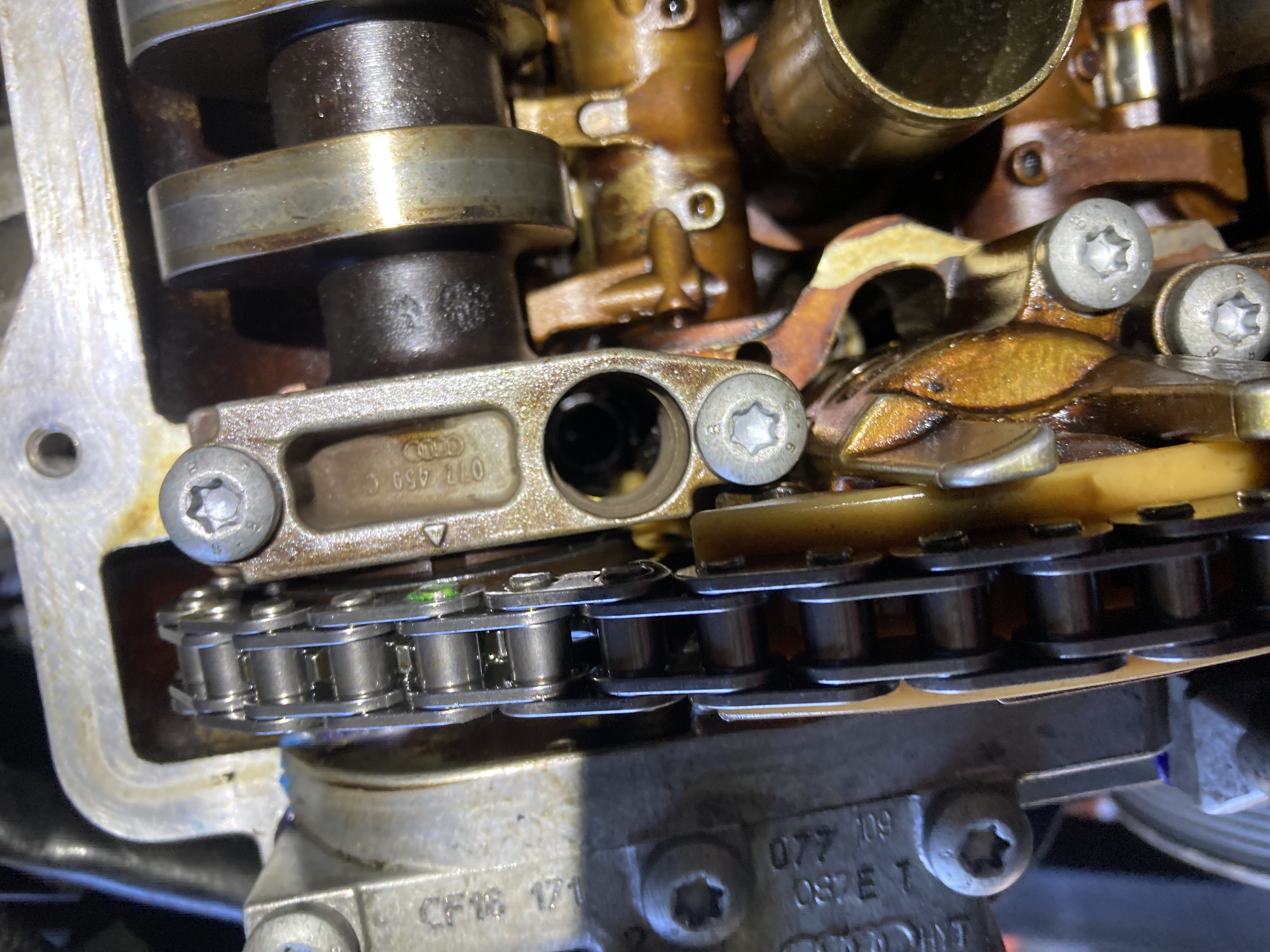

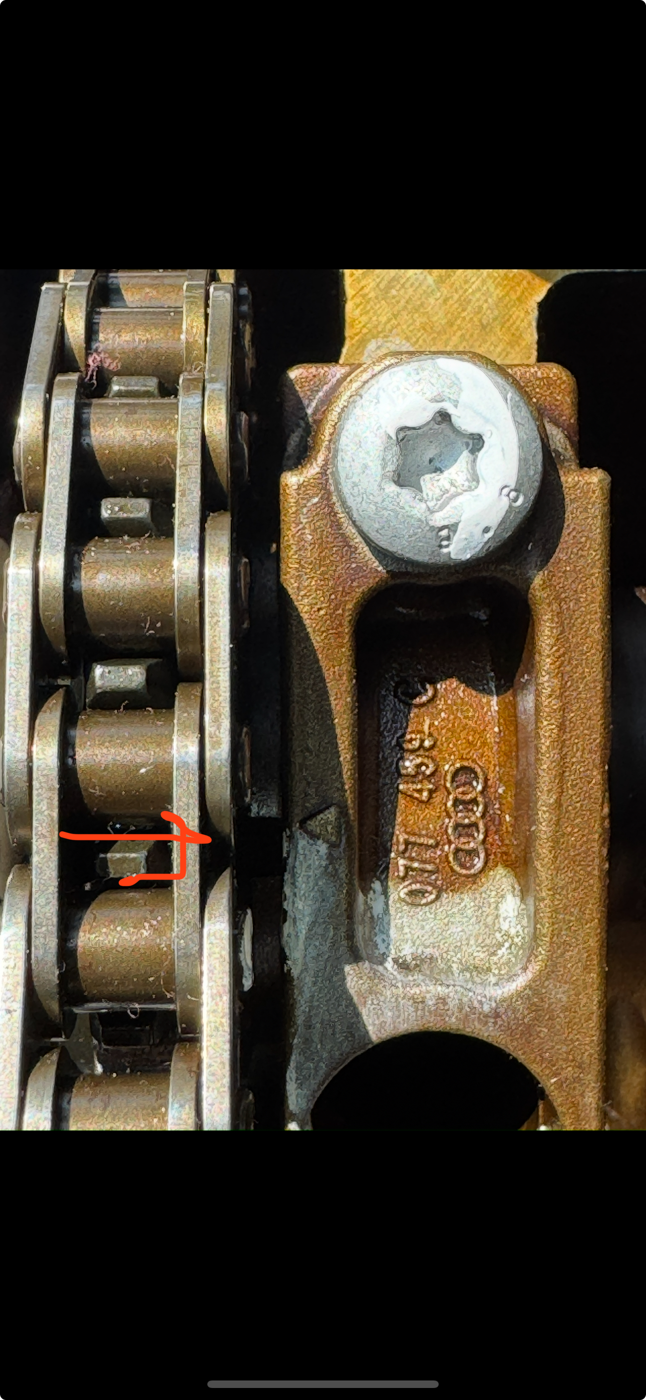

How loose was the chain when you got it on? Mine seems pretty loose right now. I’m assuming the new tensioner just needs to be primed with oil to tension the chain correct? Is there a good way to prime it? Also does this look close enough?
- Neutral
- Posts: 47
- Joined: Thu Sep 05, 2024 1:25 am
Re: Cam chain tensioners/pads removal and replacement guide
Yes, it’s normal for the chain to be a bit loose. As long as you have the right distance /number of rollers on chain between cams…The best way to prime the tensioner is to pre-fill it with new engine oil (if the tensioner is new or the old one has been taken apart), but the 2nd best is to turn the engine by hand a couple of revolutions (clock wise) once the timing belt is on and timing is good. After turning the engine by hand, if all 4 cams line up their notches with the cap arrows and the cam bar fits you should be good to go.2014audis8 wrote: ↑Fri Jun 06, 2025 6:51 pmHow loose was the chain when you got it on? Mine seems pretty loose right now. I’m assuming the new tensioner just needs to be primed with oil to tension the chain correct? Is there a good way to prime it? Also does this look close enough?
It could be close enough (the picture) because it’s hard to tell since a slight angle on your camera makes it look off but it could be perfect. The best way to tell is to look from different angles and lastly directly from above.

so the arrow is technically inside the notch, but just barely.
