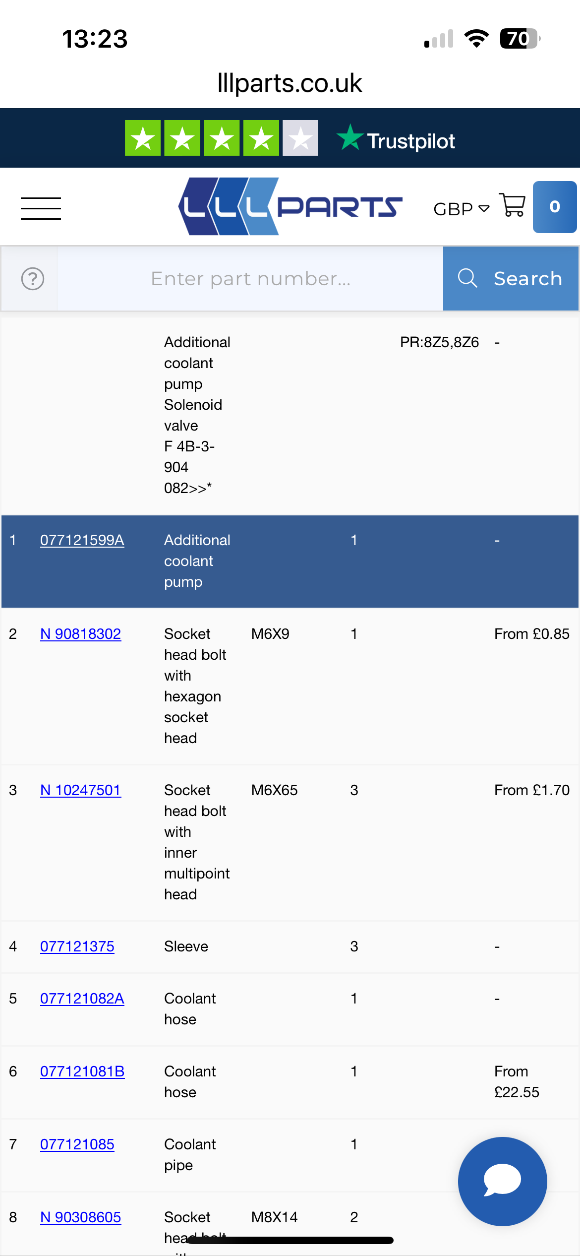

steve2003rs6
Posts: 2955
Re: Help with sourcing vac lines etc.
Post by steve2003rs6 » Fri May 09, 2025 1:10 pm
If you zoom in on the photo. The part no is on the box.
077 121 599A.
There was some confusion at the time with the last letter. But I was assured that is the correct pump.
Bought from Audi Tradition IIRC. Someone on here fitted this pump and recommended it. So I bought one for when and if I need it.
If Craig and Paul have fitted the Autodoc ones. That would be a good enough recommendation for me.
Just came across the above info from a Topman post in “new owner seeks some advice thread”
Seems to confirm what I bought.
