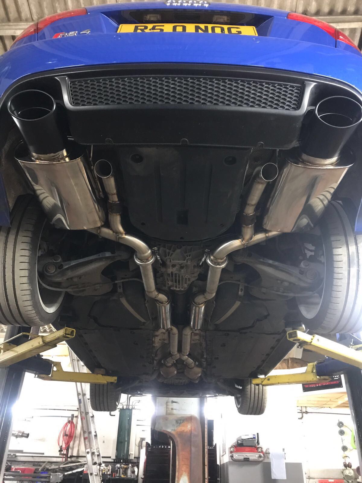

I had a custom built system by Badger Burton over Aylesbury way
It was a while back mind, but i do remember it wasn’t that much more expensive than a Milltek at the time.
Valves still worked on the s button,and a quality bit of kit

What are the two pipes pointing down out of interest?
Is that an original Nogaro?!?! Amazing if so, I thought there was only 1 or 2 made in that colour. Sorry to take the thread off topic but would love to see more pics.

It was the only Nogaro bread van there is a saloon also.
The 2 pipes in question are straight through so when when you put in sport it was loud😂

Post by Mav8 » Wed Apr 16, 2025 12:34 pm
I no longer own it sold it a few years back

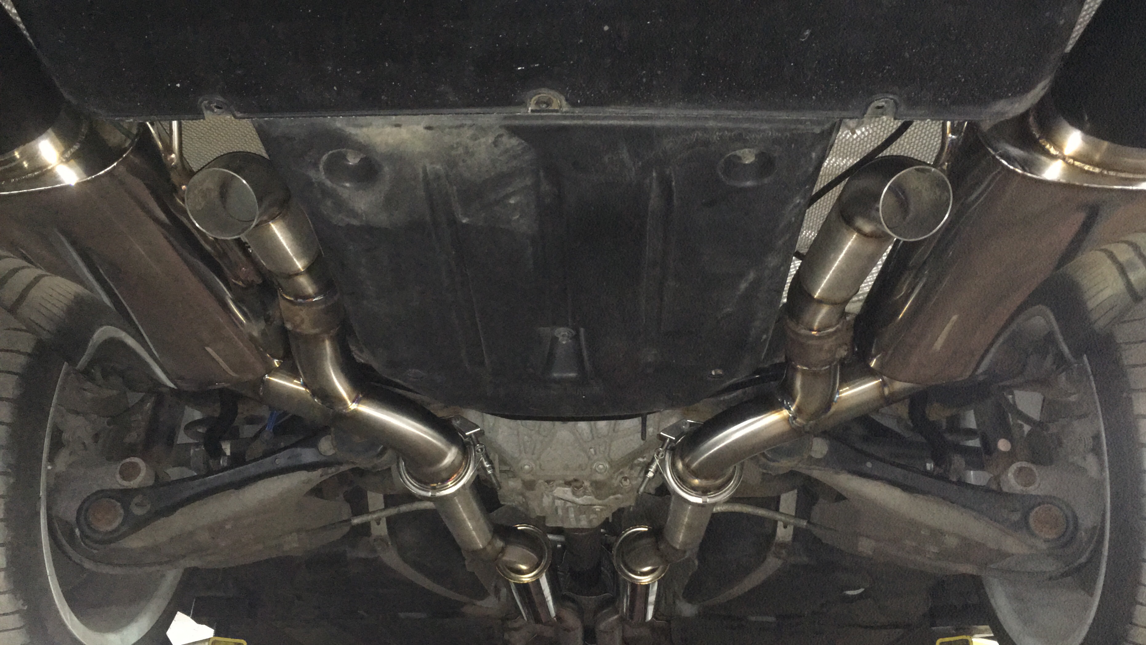

This is an old pic because HMS is single oval exit now, not dual - but you get the idea with the shape of the back boxes and the two resonators that you can just about make out at the bottom of the picture: https://www.tuning-empire.com/blog/anot ... s-exhaust/
The resonators then form part of the centre section which go into an x-pipe join.
Yeah absolutely you could do that first and see how you like the sound. In fact, Supersprint already make this for the RS4 - https://www.supersprint.com/en-ww/audi- ... e--v1.aspx
