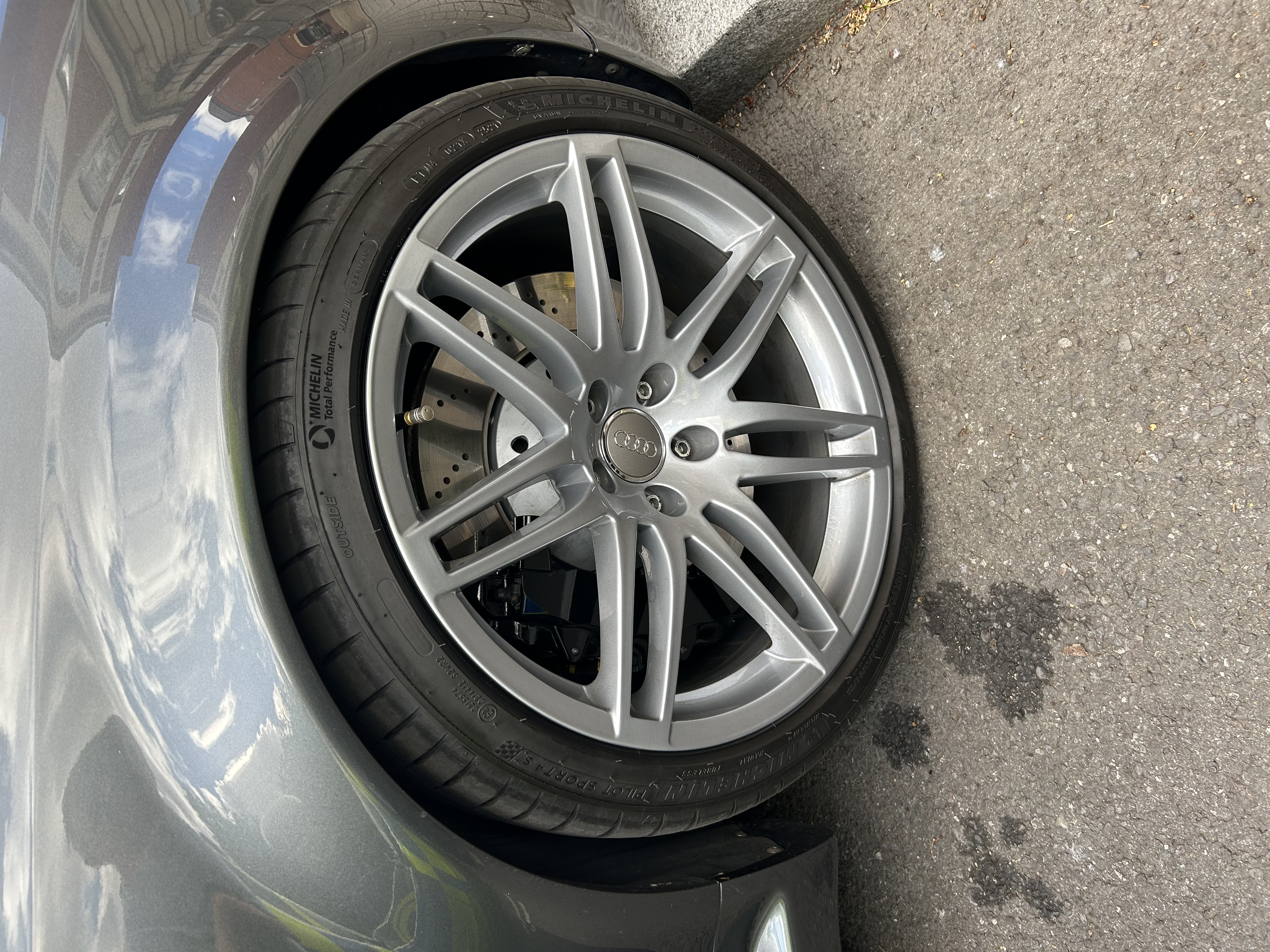

Replacing rotors – drilled Zimmerman, I sprayed hubs silver with a fair amount of clear coat. Hopefully, they remain shiny.
Image Image
