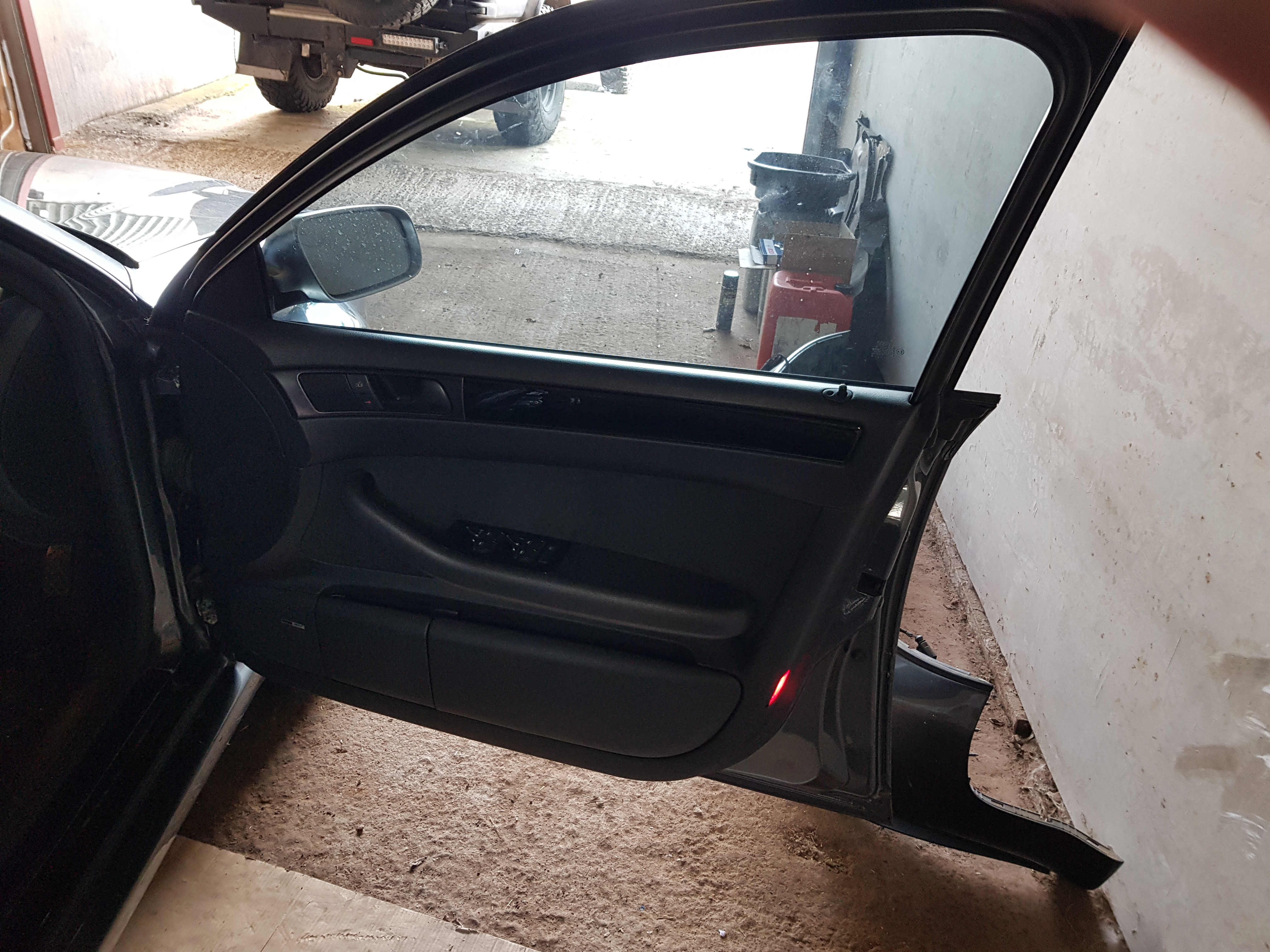

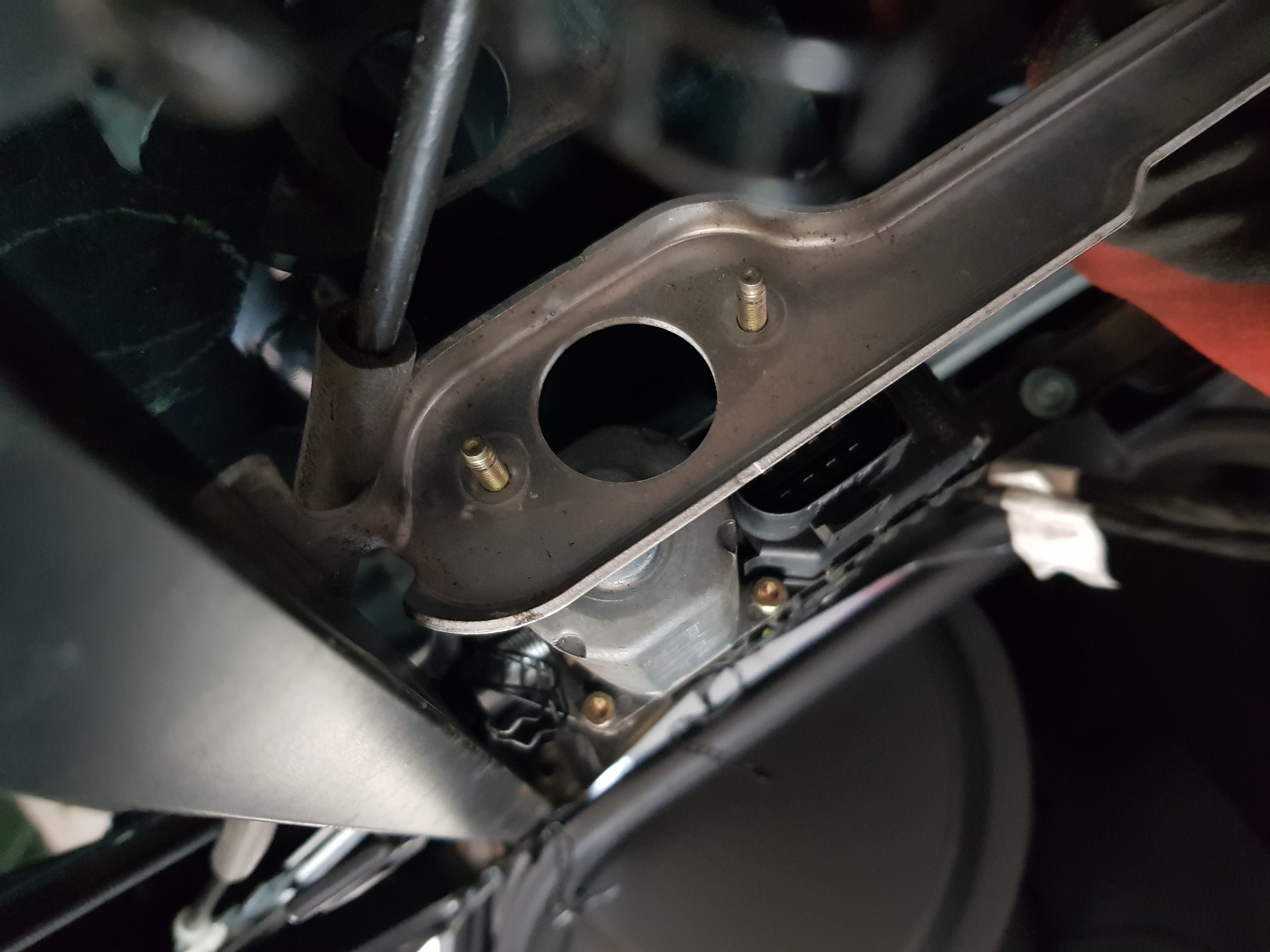

Got the drivers door window regulator finished and all working. Slightly annoyingly there is a support bracket for the end of the motor, but the replacement regulator frame positions the motor slightly differently so it didnt fit. I couldnt see it being a massive issue not having the support for the motor so unbolted the bracket.
Main thing is the window goes up and down again! 😅

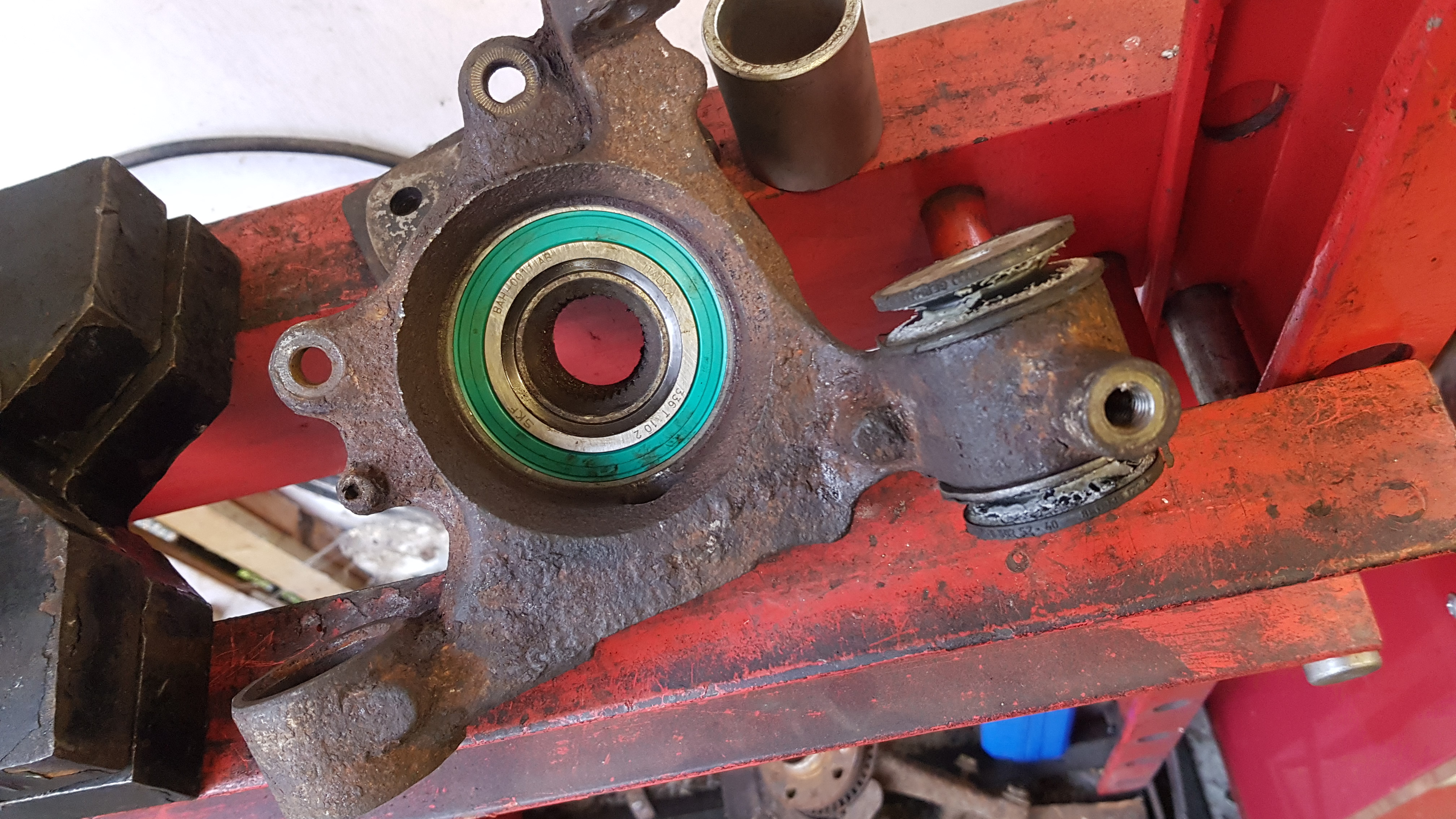

Next job is rear suspension overhaul and rear right wheel bearing change. Essentially all the bushes are looking pretty haggard so will be replaced. Hunting down the specific RS ones was an expensive exercise...

All the rear wishbones and hubs are off the car. Will have to wait till next weekend to finish replacing the bushes and fitting back together again.

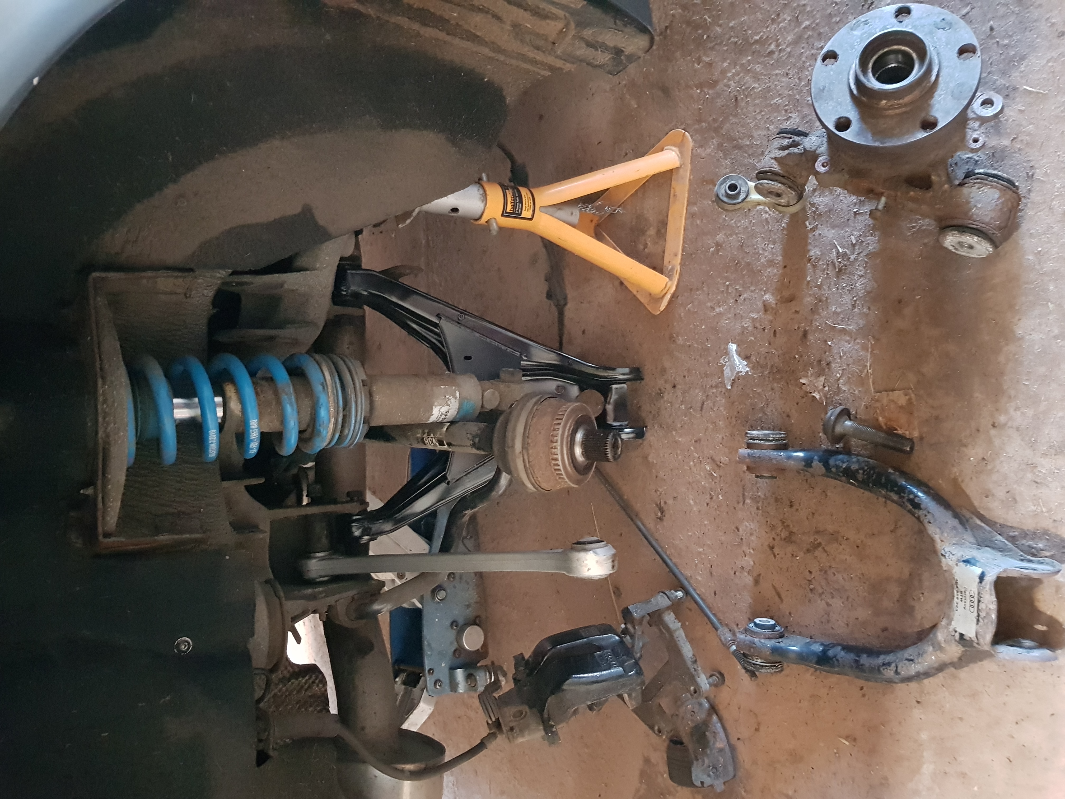

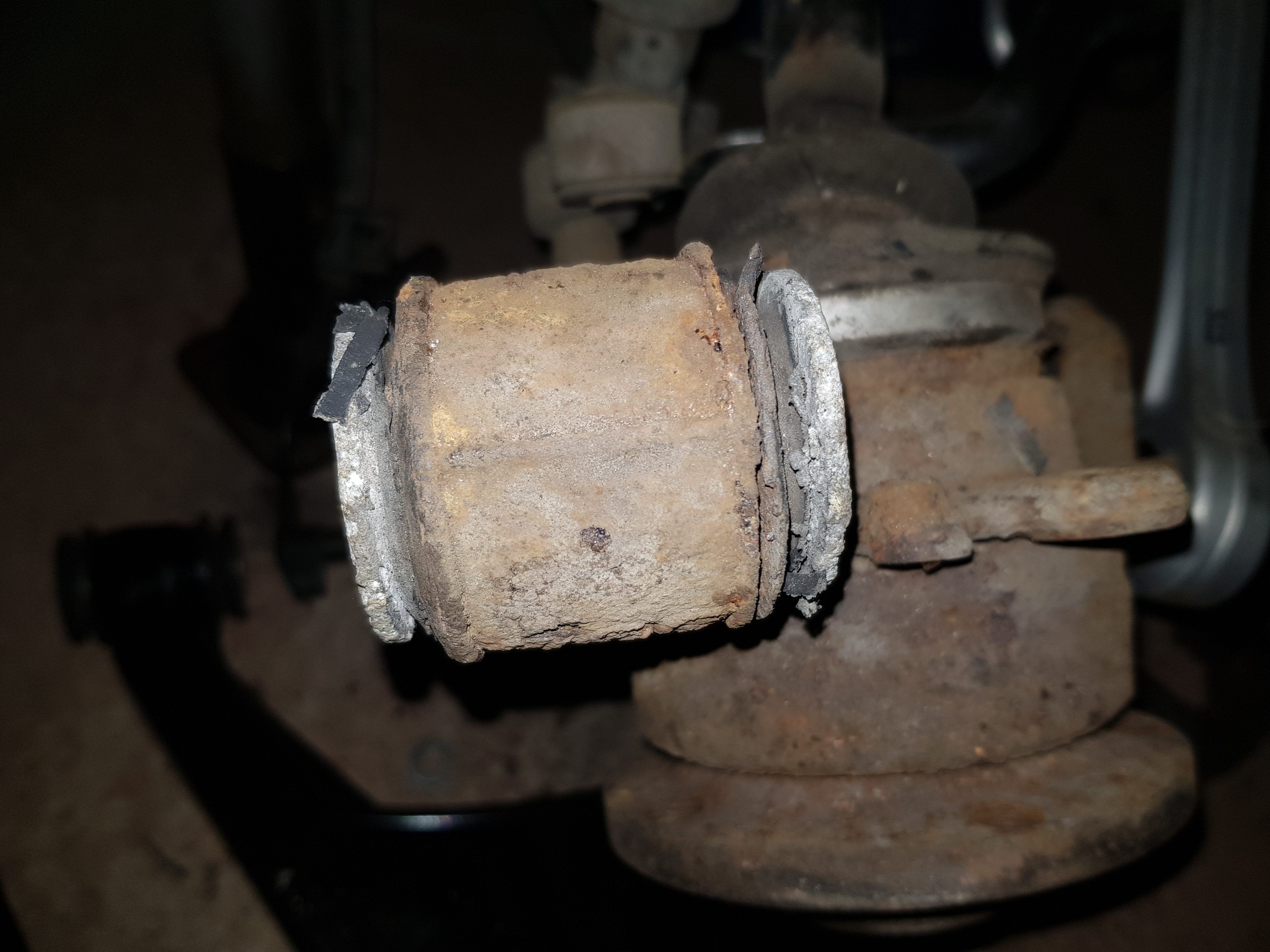

Post by Felix2566 » Sat Feb 17, 2024 7:52 pm

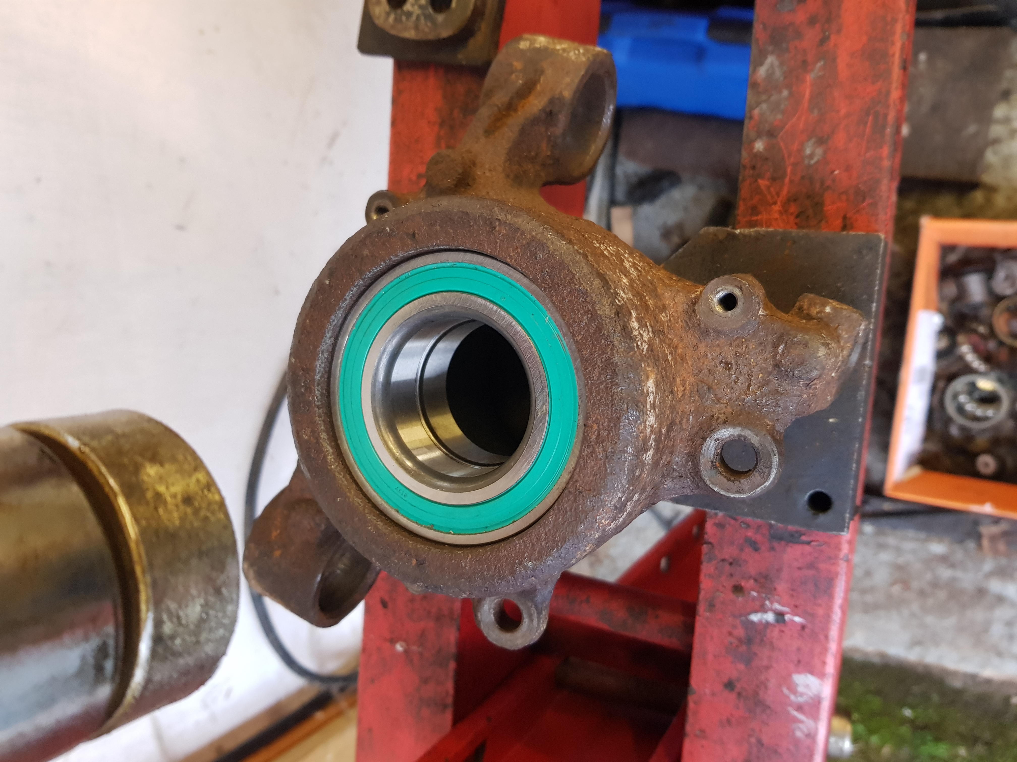

Finished changing the last remaining bushes and replaced the rear right wheel bearing....ready to be all fitted back on the car tomorrow.

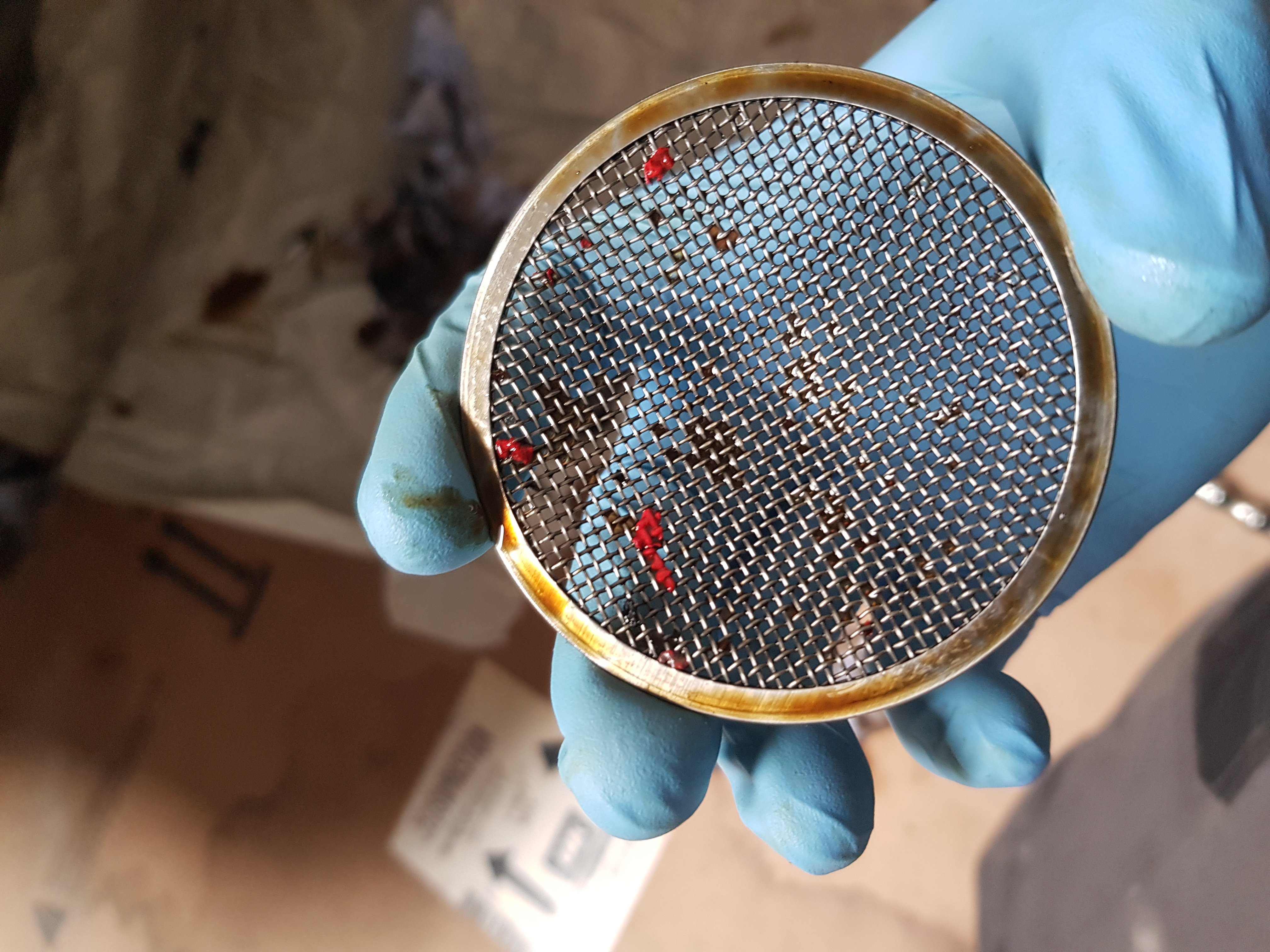

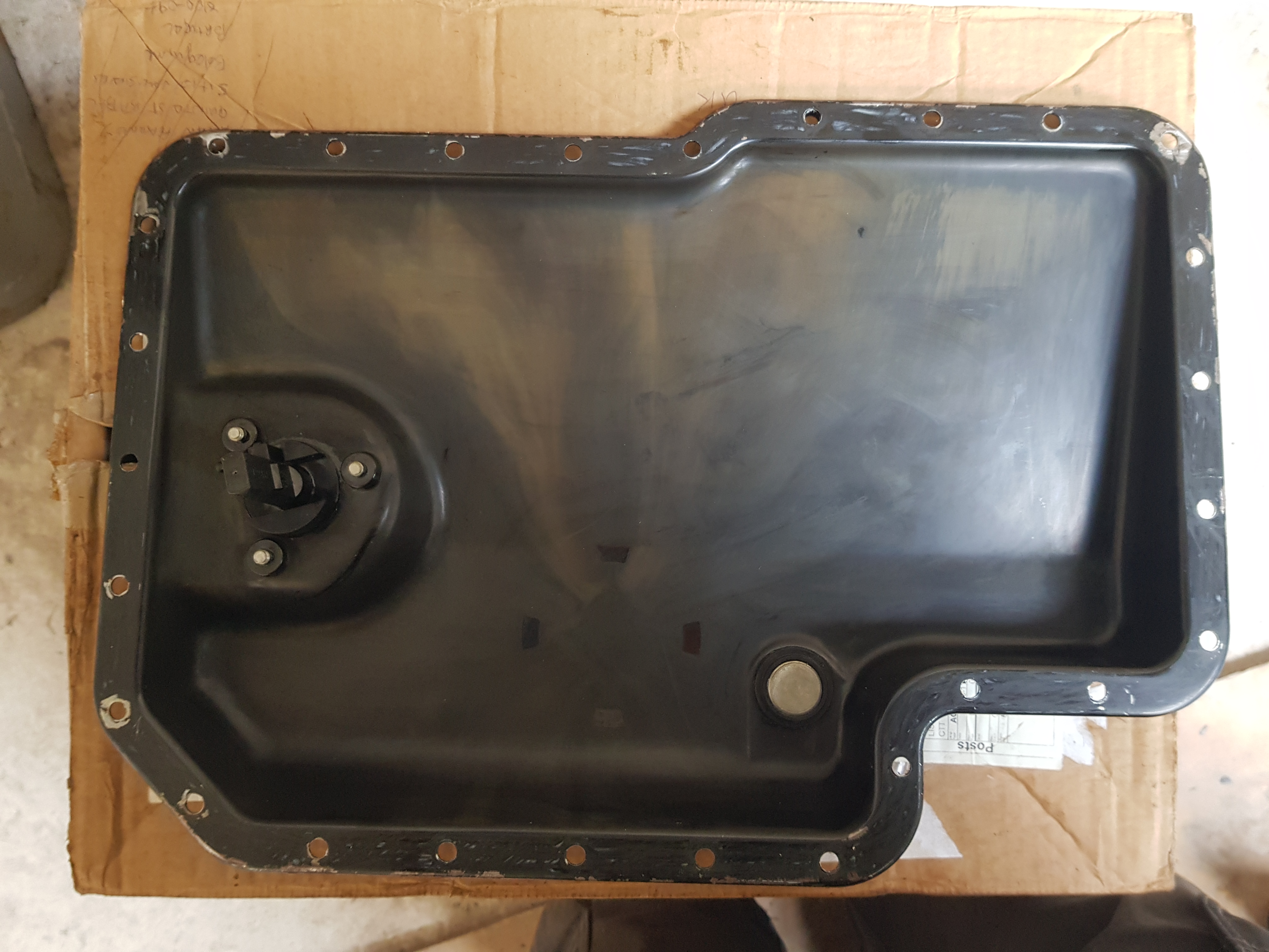

Post by Felix2566 » Thu Apr 04, 2024 9:11 pm

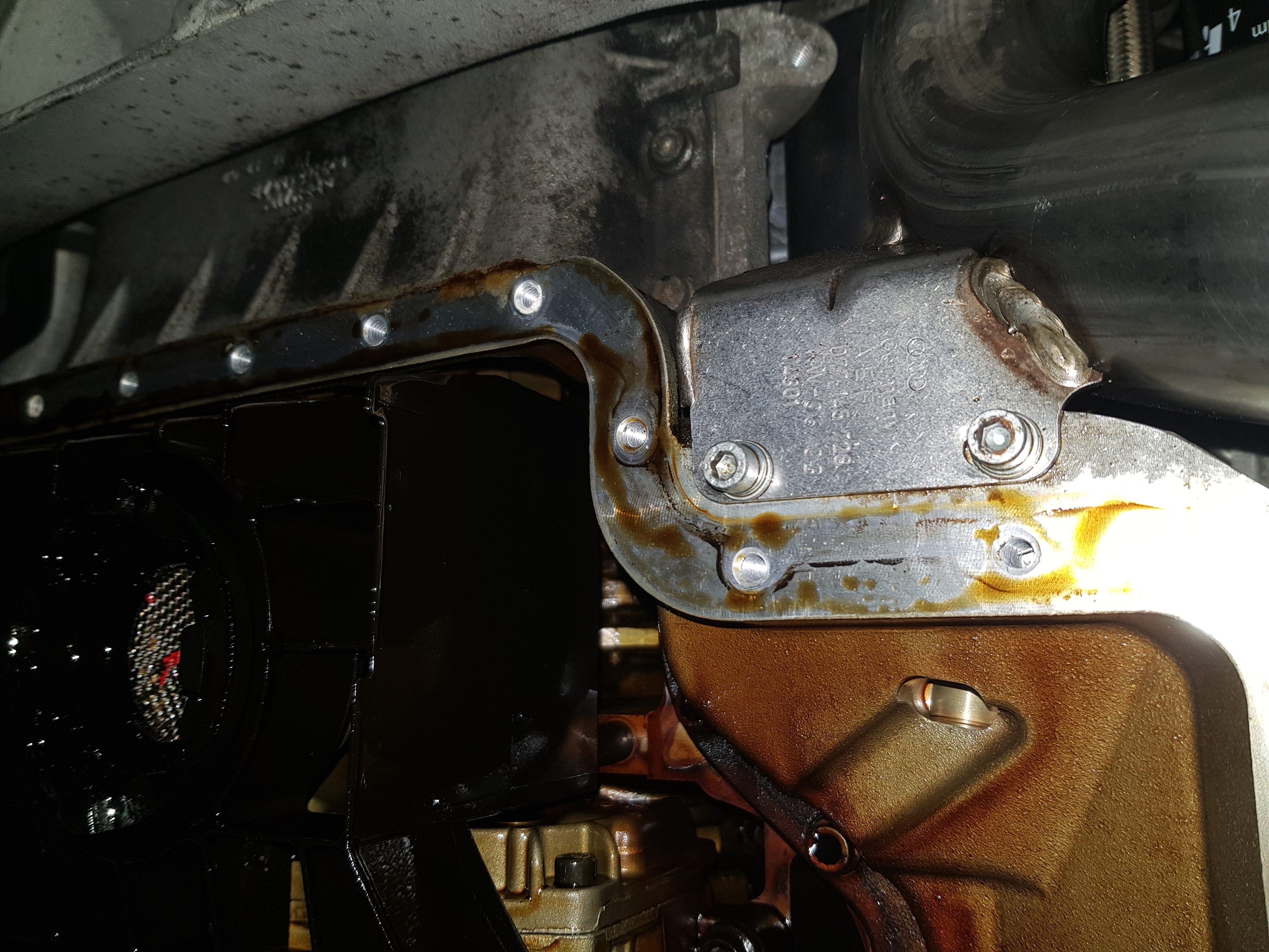

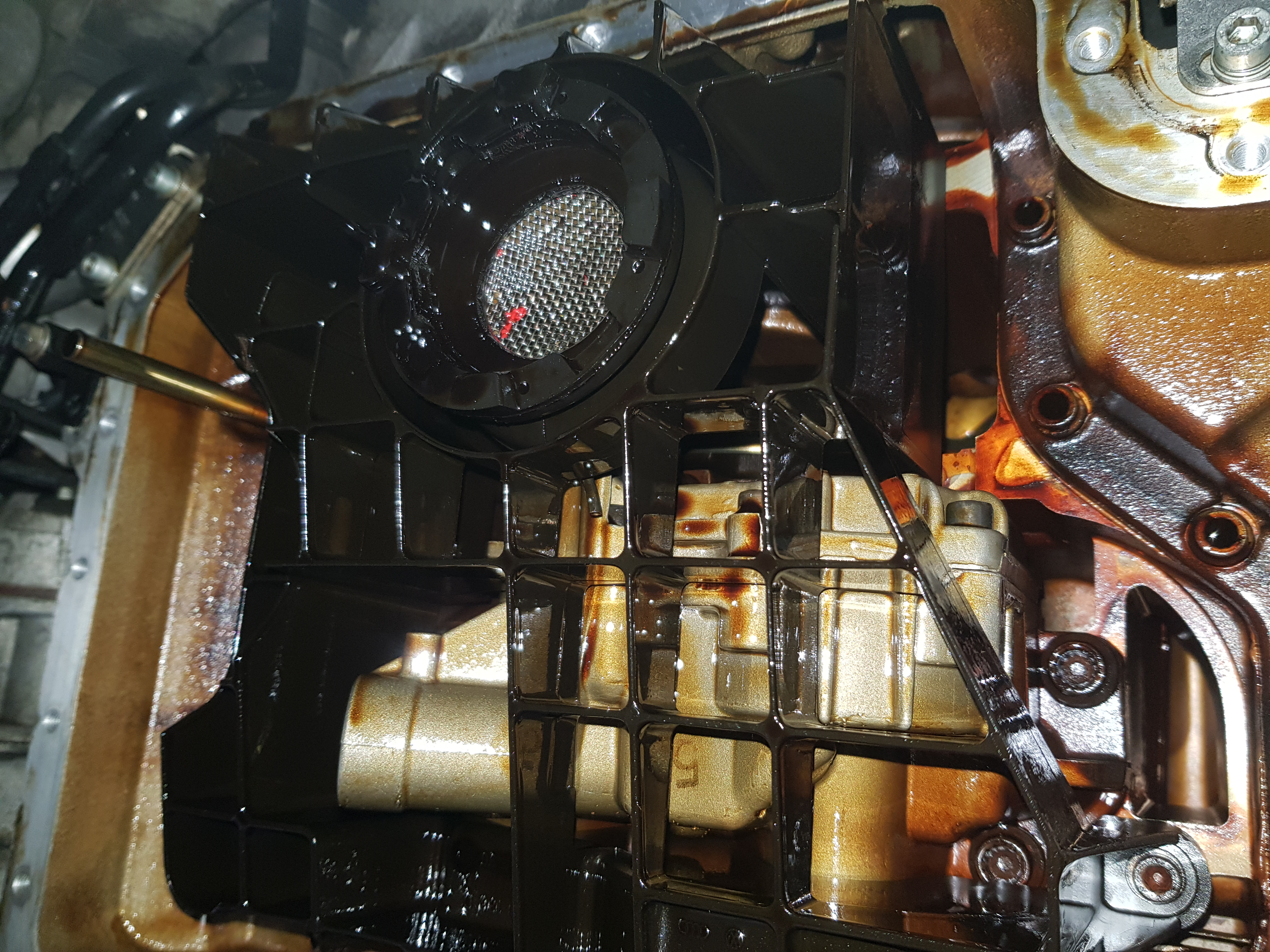

Managed a bit more work on the old girl today, oil change and sump re-sealed.
Car is much quieter on start up with the fresh oil.
Took the strainer off to clean out a small amount of debris. The red stuff was hard like paint, not sure what it was. Nothing unusual in the sump. All was pretty clean.

Post by Felix2566 » Sun Apr 07, 2024 3:15 pm
Thanks, would rather do a load of work now while the weather is rubbish and hopefully have less problems when ever things get warmer and drier!
Leak from the sump appears to be fixed, no drops have come back and all looks dry around the sump pan seal.

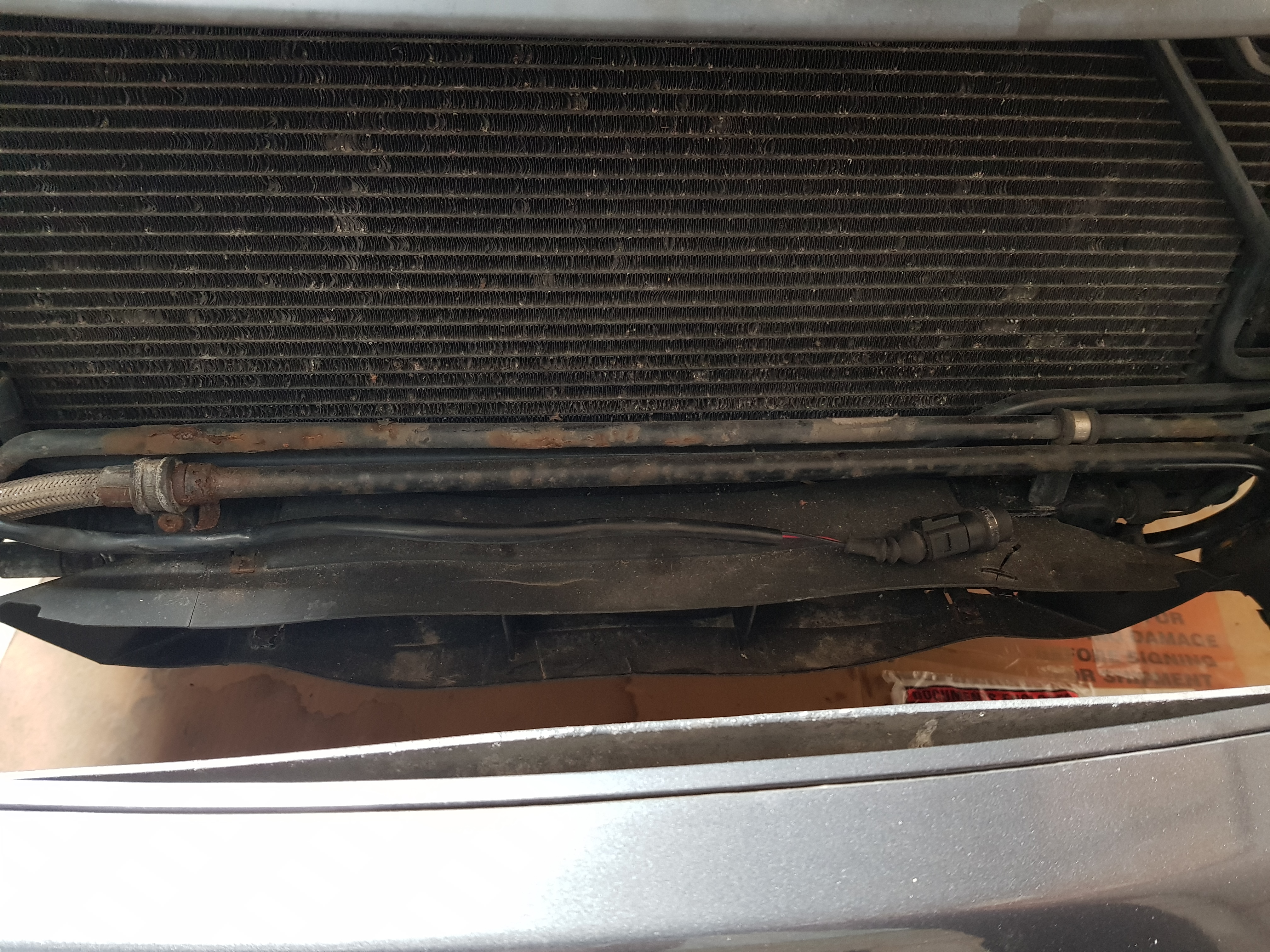

Post by Felix2566 » Sat Apr 13, 2024 11:30 am
I'm about to put the front bumper on and there is this sensor (I think it's a temp.sensor for the solar sunroof) where is it supposed to go? It was just tucked ontop of the oil cooler pipes
Posts: 20315
Re: Project, they all are...
Post by Shoppinit » Sat Apr 13, 2024 12:09 pm
It's a temp sensor for the dash display of ambient temperature. Doesn't matter where you put it because it always gives stupid temps anyway, but it's supposed to clip somewhere on the bumper IIRC.

Post by Felix2566 » Sat Apr 13, 2024 12:25 pm
Cheers Shop. There are some unused clips inside the crash bar I can probably tuck it into.

Post by pwack » Sun Apr 14, 2024 3:28 pm
If you still have the oil cooler plastic air guide ,there should be a hole on the passenger side of the air guide , thats the originl location for the external temp sensor, mine didnt have the air guide when I got it so mines zip tied behind the centre grill , like Shop said though , it never gives the right Temp!!!
