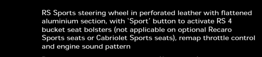

The 'S' or 'Sport' button does nothing to the suspension. It activates the seat bolsters (if not disabled), throttle response/map & exhaust flaps.
Attached is a screenshot from the brochure.

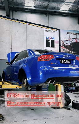

My current DRC's are leaking and suspect they are more or less knackered.
Koni's and H&R setup going in tomorrow. Any other bushes or mounts others would suggest replacing whilst the work is being done?
Will post pictures after install.

Thanks, and yes rather excited to see how these do.
I ordered them from Steve at CRS.
The H&R springs I sourced from TunerShop.
Should be all wrapped up by midweek as I am also replacing the front pads on the ceramics, so I'll post some pictures once completed.

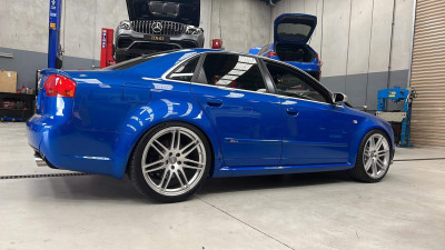

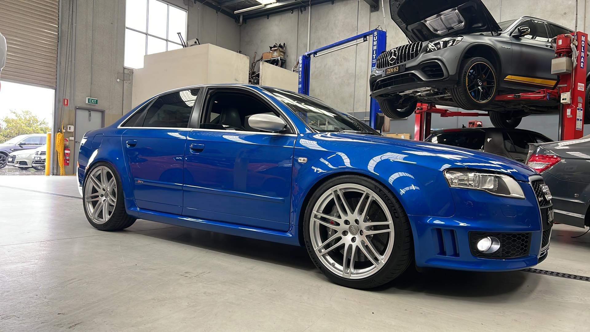

Post by TRS842 » Tue Aug 22, 2023 11:54 pm
Opted for the H&R lowering springs. Although concerned it may be a tad too low in the rear.
Considering switching to KW HAS springs to allow me to set the perfect ride height.
