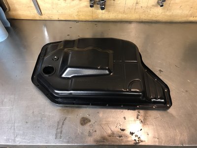

These are the official ZF docs. Note that despite Audi saying sealed for life, ZF do specify servicing - for ALL the 5HP and 6HP gearboxes. Gave the sump a lick of paint while it was out. Bit of a quick and dirty job TBH, but want to stop it rusting. Will get a replacement powdercoated when I can find one.

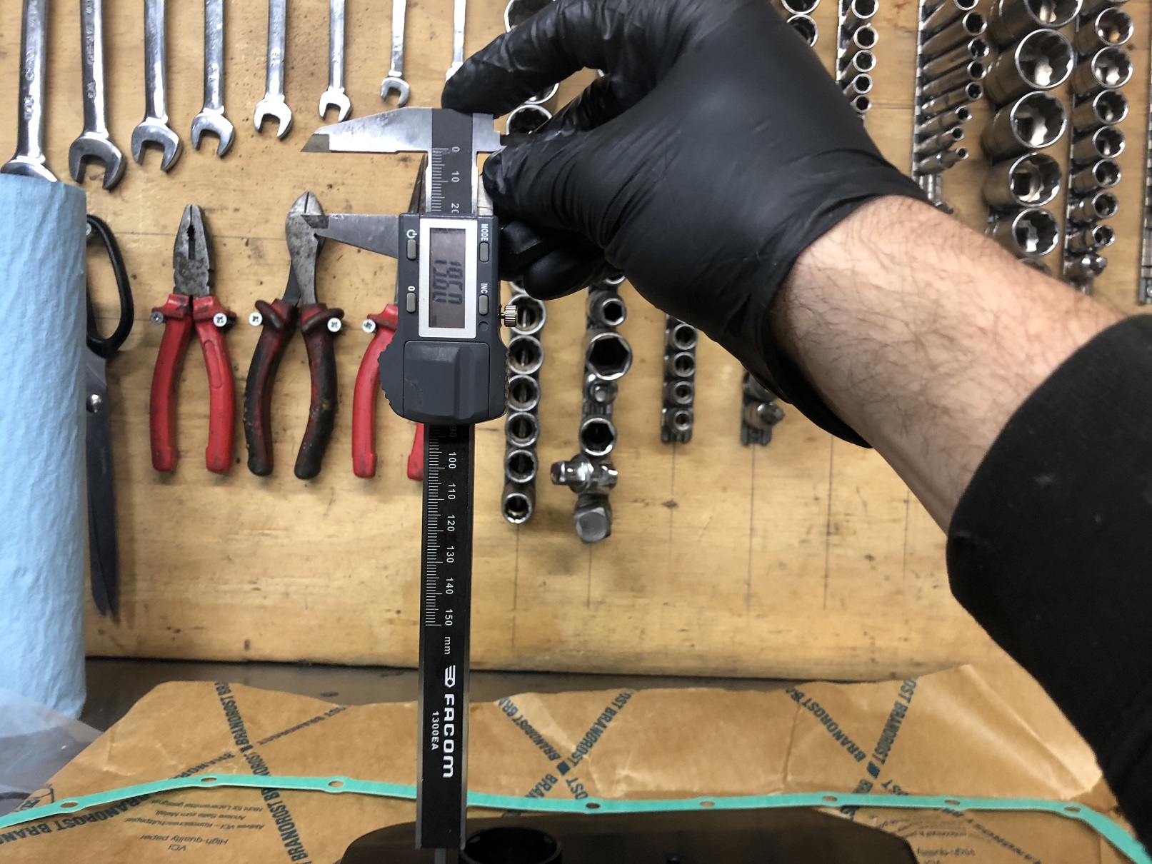

It's well discussed that the 5HP24 A should have the short filter - but I couldn't find any measurement to confirm what the right filter length is.
20mm is the (right) number. 25mm is the wrong (long) number.
The gotcha is that the long filter will just fit in a short sump - but with no clearance. Although I've never actually seen a long filter - do they still even make them?

And you have a spare sump for powder coating.
That’s what I call good timing ?
Mɐʇʇ
Posts: 2720
Re: 5HP24 A - ZF Service Kit
Post by Mɐʇʇ » Mon Sep 21, 2020 8:02 pm
Totally. I had been patiently looking for one for quite a while.
However, when I switch over, I’ll then have my current one available for someone whose own one has rusted through. I will pay it forward. 😄
