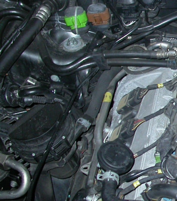

Yeah, that's how it looks. Interesting that.
This is mine:

Thanks for the pic Shopp! Mine is no longer the oem one which died but the Bosch equivalent. Supposedly they should be identical in terms of function, but they may have the electrical connector the other way round, hence the question. I stupidly throw the oem one away so I can't tell for sure.
Anyway, from my findings the N80 -when not powered- acts like a non return valve with a spring. Meaning if you apply enough vaccum on one side (or pressure on the other), air will pass through. So installing the thing the wrong way could lead to problems.
If you don't have better things to do with your life for the next couple of minutes, here's my reasoning for choosing the right direction. My best bet is to install the valve the opposite way of the air flow (canister -> engine) so that when vaccum is applied either from the front of the engine at idle (throttle valve) or from the back (turbo intake) during boost, the N80 stays always closed, except of course when it's powered in which case air can pass through. I suppose it's a good assumption to believe the valve is strong enough to counteract both the spring and the air flow, or? Comments?

The N80 valve is normally closed, and opened when it gets an electrical signal from the ECU. When the valve is open, it allows gas glow from the carbon canister towards the intake manifold. Otherwise, when the valve is closed, there is no flow at all in either direction.
On the OE valve, the "output" towards the intake is on the side of the connector. On your Bosch valve, I would have thought there would be an arrow indicating the flow direction.

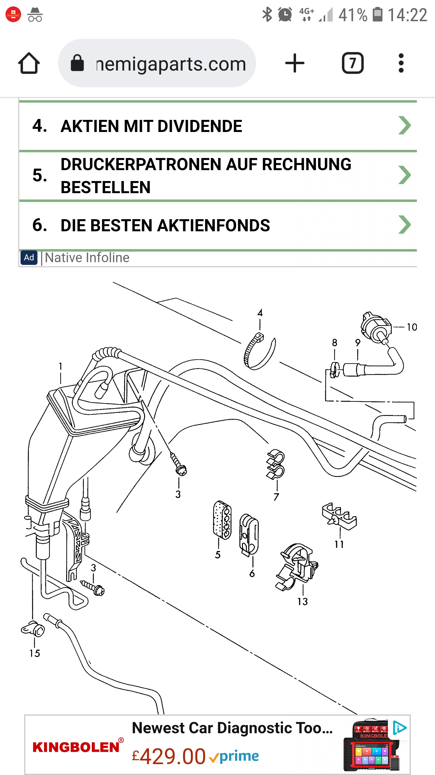

Is it me, or does this show it being piped up different?

I wouldn't rely on the parts catalogue for technical information. Although you would expect it to be right.
