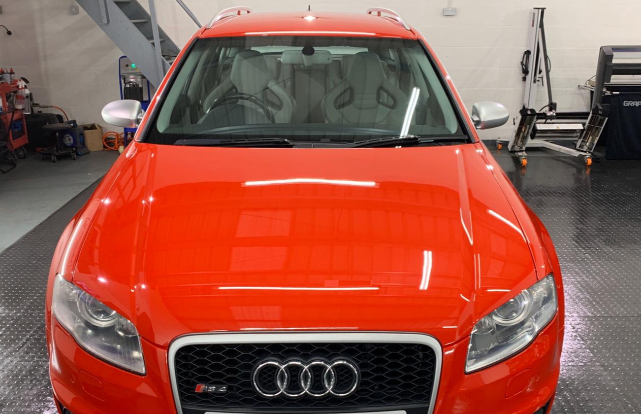

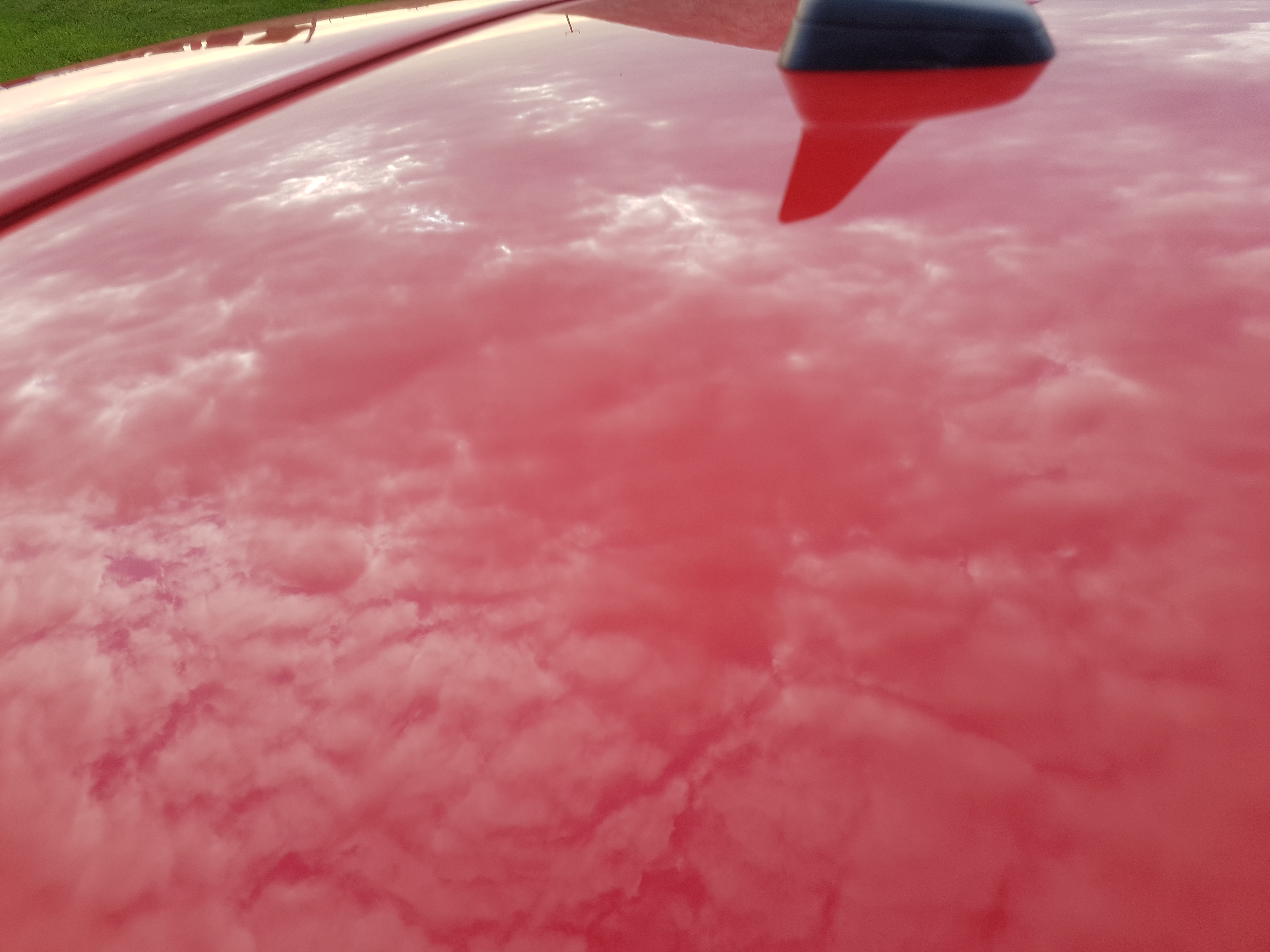

Not the best pictures but it was only after looking at the car on a sunny day that I fully appreciated the quality of the paintwork.
Better than new.
Better than new.

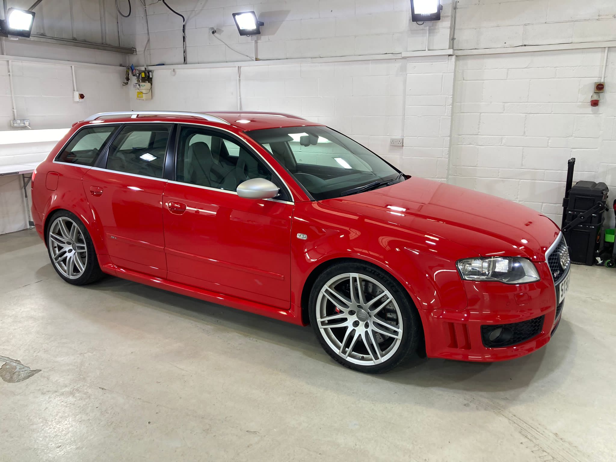

Few updates to the car this month. Lowered the rear ride height back to SS+ as I had raised it just after it was painted. It just looked wrong and I am sure the rear was more mobile. Now running SS+ height front and rear.
At the same time I removed the H&R anti-roll bars and fitted a brand new OEM front paired with a 034 Motorsport rear. This has improved the low speed ride quality no end whilst the uprated rear is very effective at combating body roll when combined with KW V3 coilovers. I need to do more mileage with this setup but it feels like some steering precision has been lost but there appears to be less understeer.
I also got around to having the whole front end and extended side skirts covered with XPEL Ultimate PPF. Really pleased with the results and will be going back to get the rest of the car covered in a couple of months.

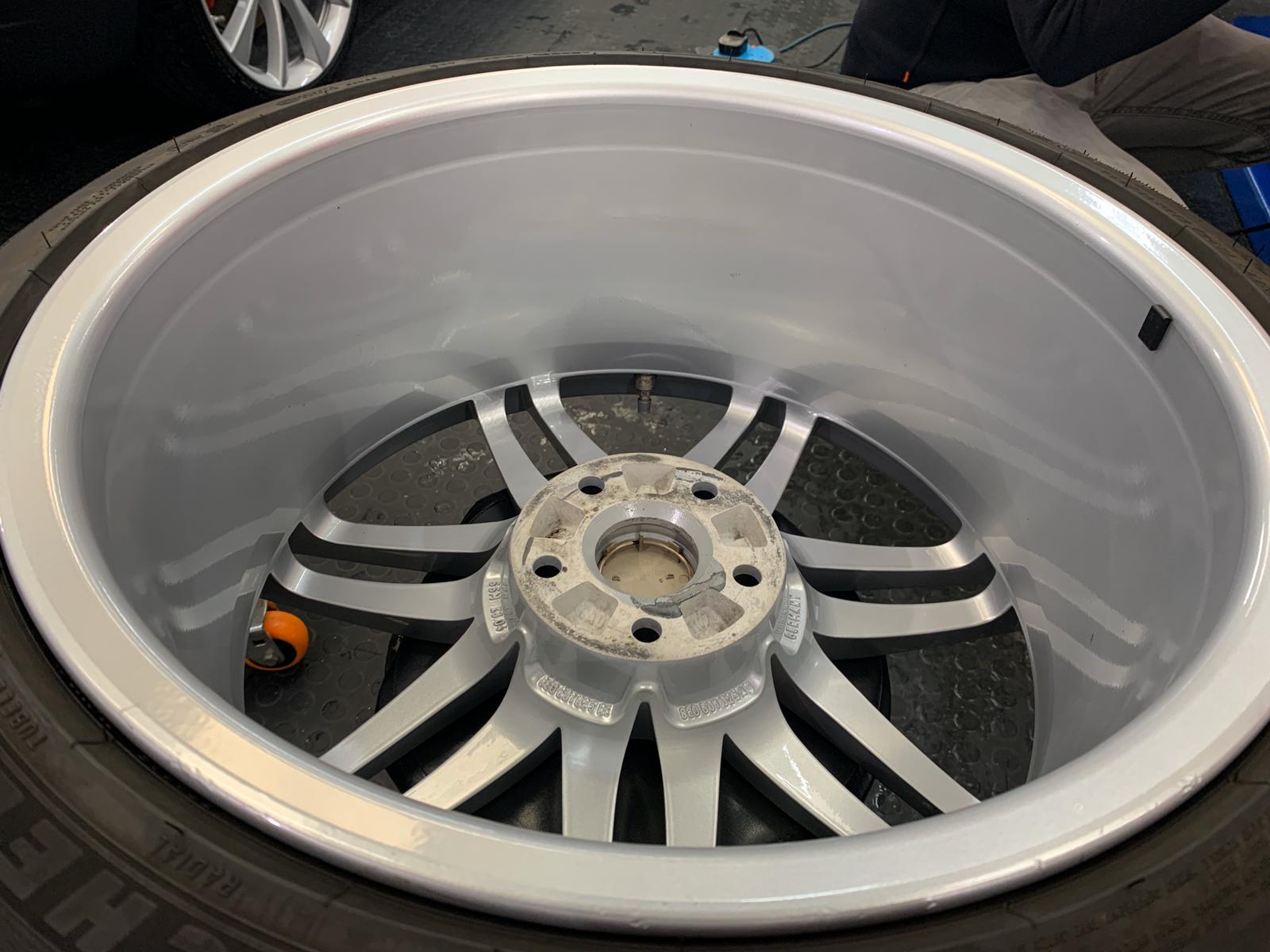

Whilst it was at the detailers I got them to ceramic coat the wheels and calipers, this should make them a bit easier to keep clean over the winter.

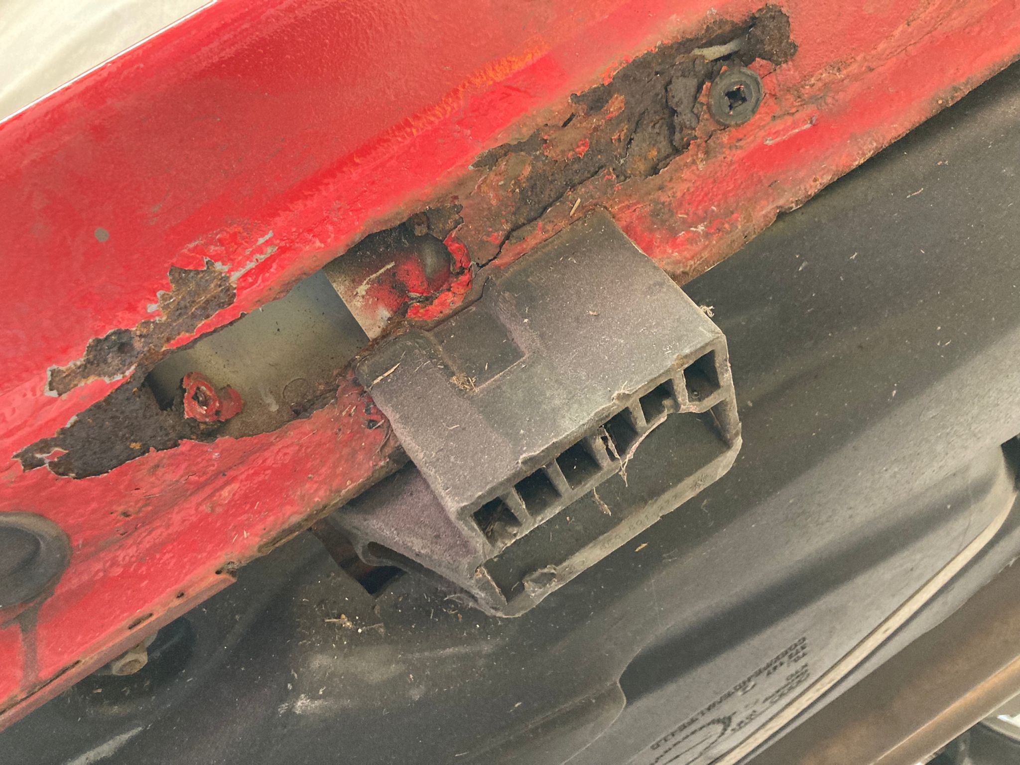

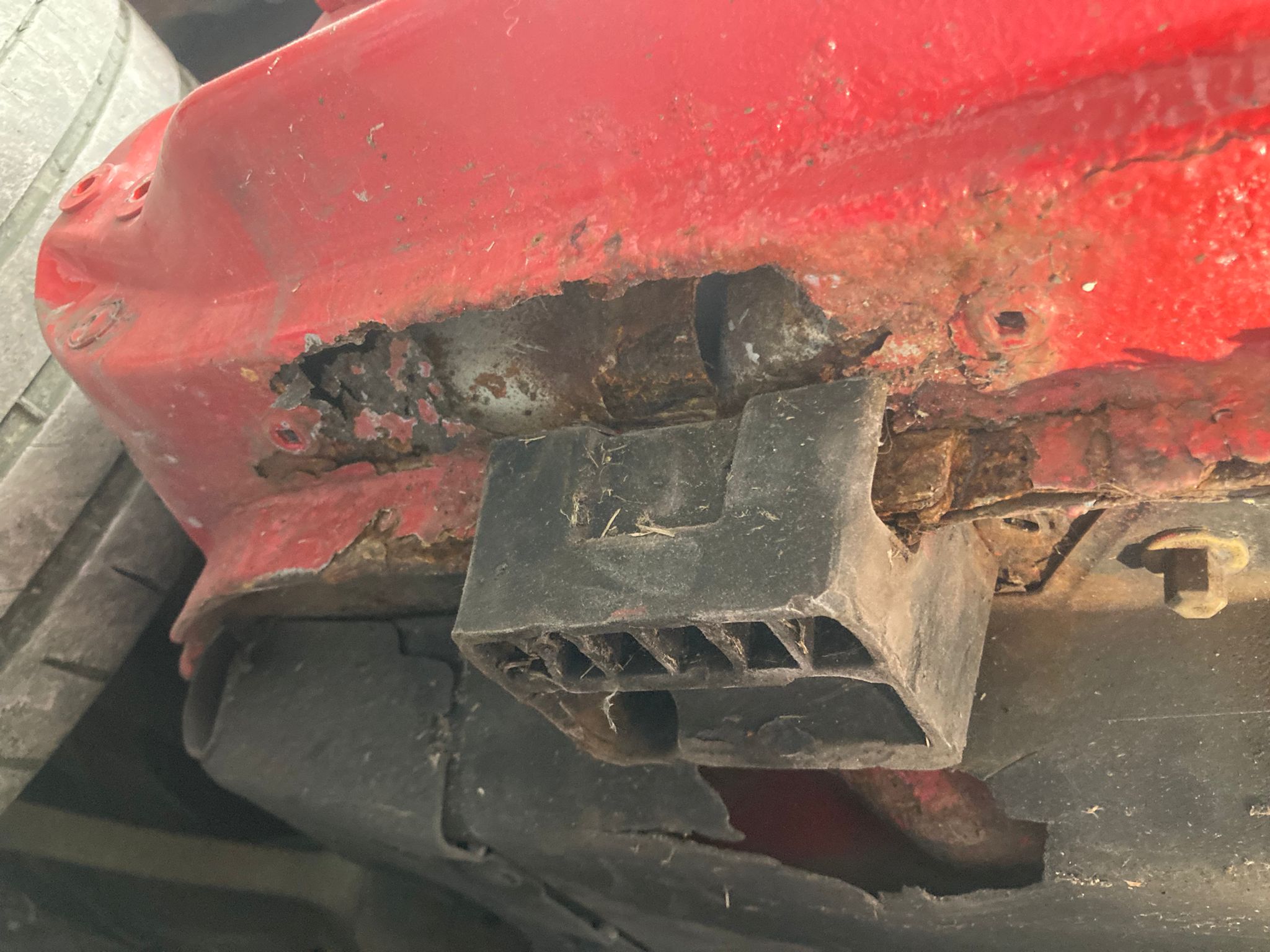

Well it's been awhile....... so I thought I would post some updates!
The car went back to the original body Shop a year later as there were a couple of bits that needed attention. Because of Covid it was there so long it needed a new MOT! The old bus was then fully detailed before having the rest of the panels covered in PPF film.

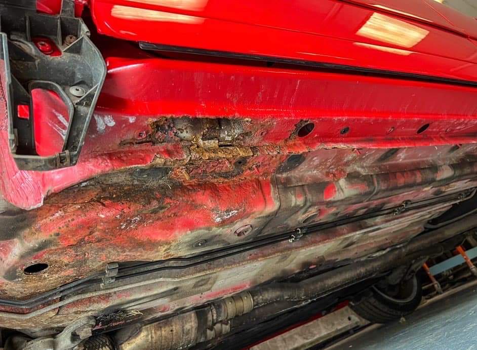

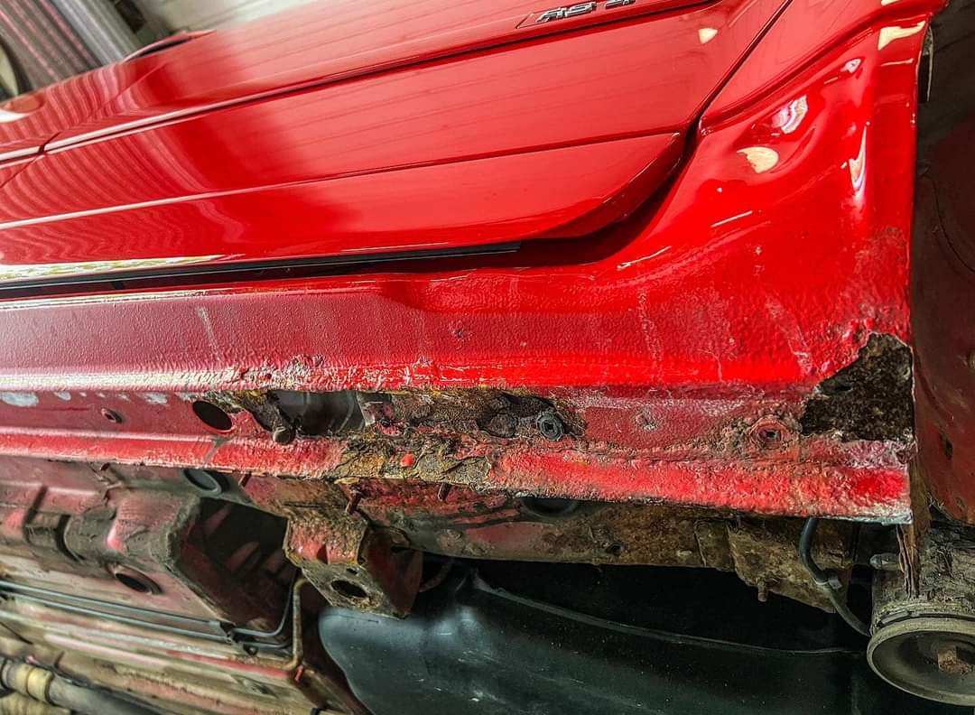

Unfortunately whilst it was in for this work (specifically when the side skirts were off), it was highlighted that the sills were in a bad way....... with the rest of the underside not looking much better
I always knew it was going to need work underneath but you always hope you can get another year out of it...... now it was time to bite the bullet and find a workshop to carry out a full underside restoration. Before it was too late...

Wow that is bad, and glad you found it in time to sort it. Shouldn't be too much of an issue for a body repair Shop.

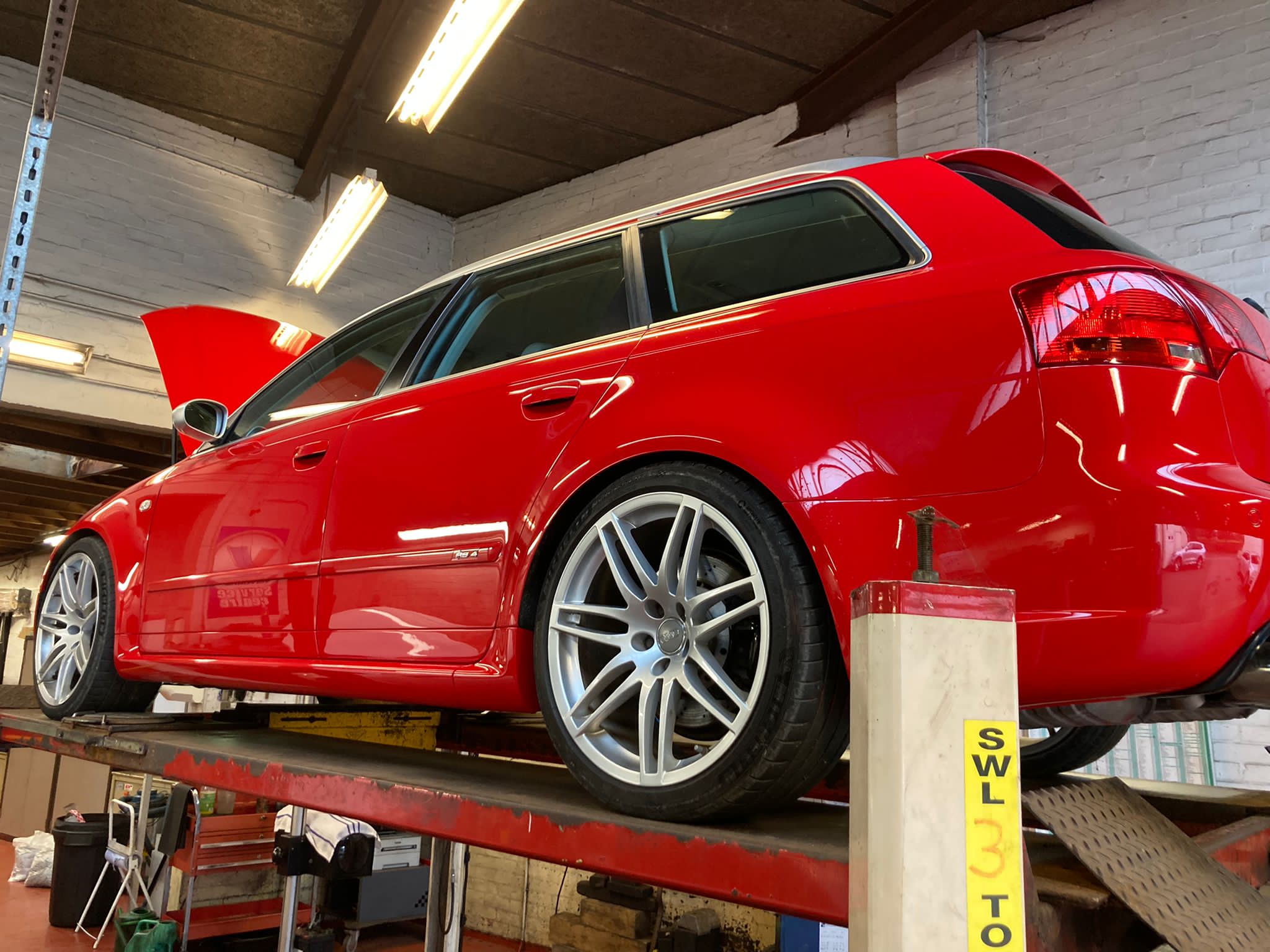

Re: Martin's RS4 B7 Avant Build

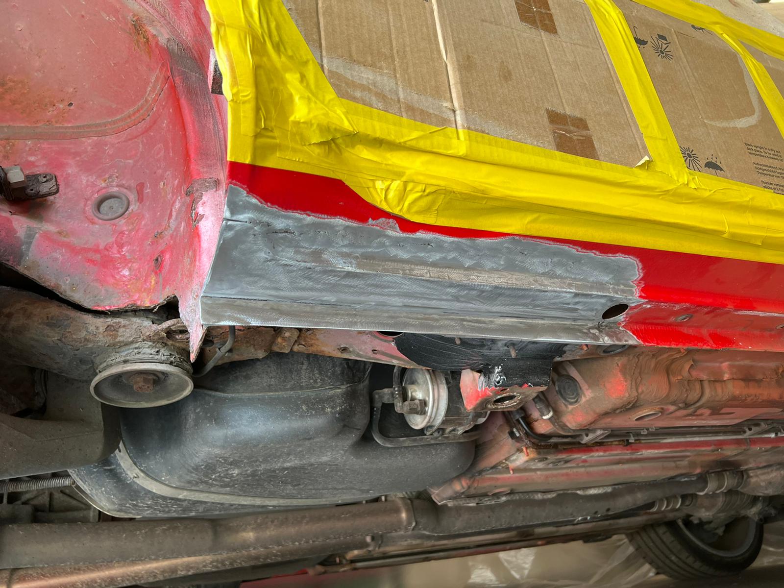

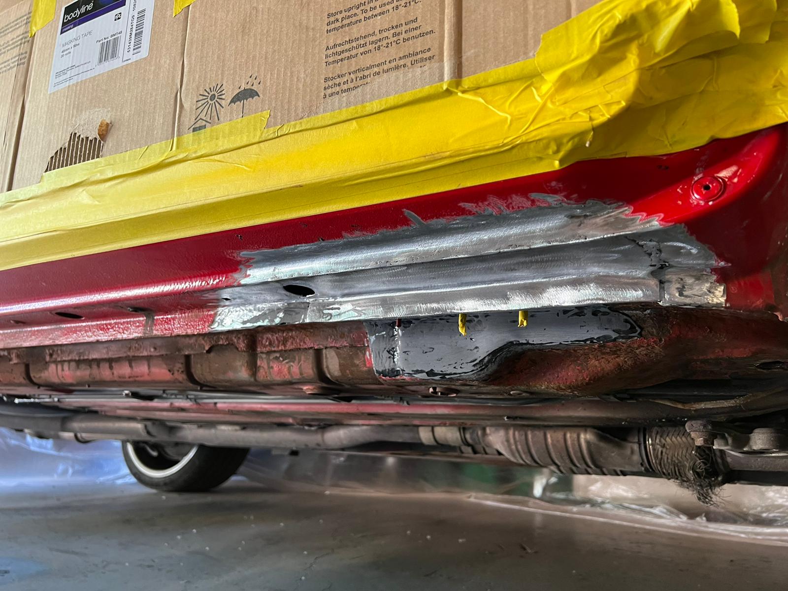

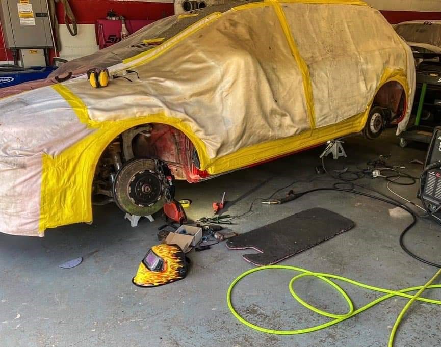

After doing loads of research I managed to find a place to restore the underside of the car. The owner had restored his own RS4 B7 previously and after seeing pictures of the last RS4 he did, I was convinced I had found the right person to carry out the work.
I literally picked the car up from the paint Shop and drove it straight to his workshop. Only a 3 hour drive on mostly motorways, but it felt great to be back behind the wheel again after so long!

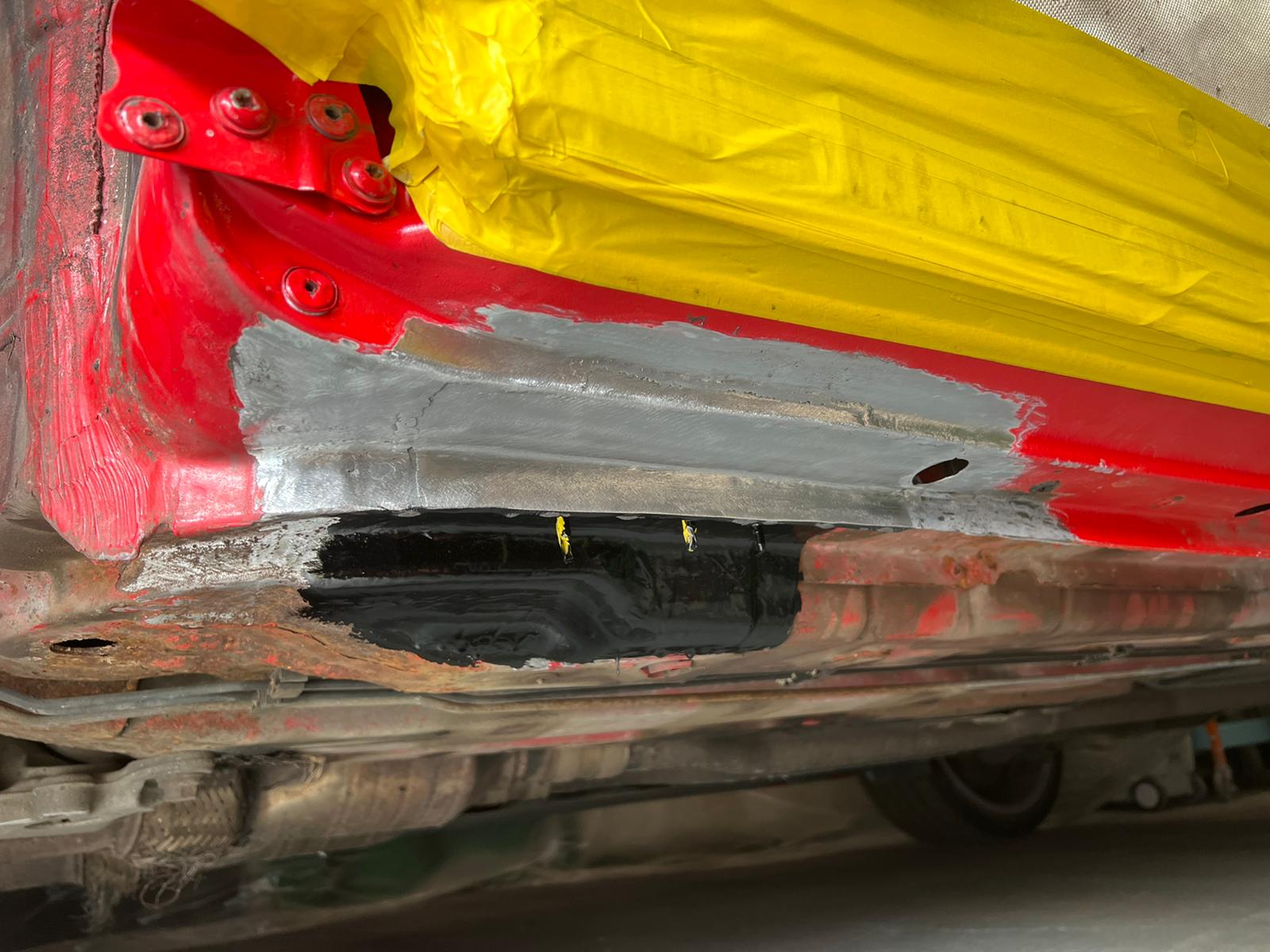

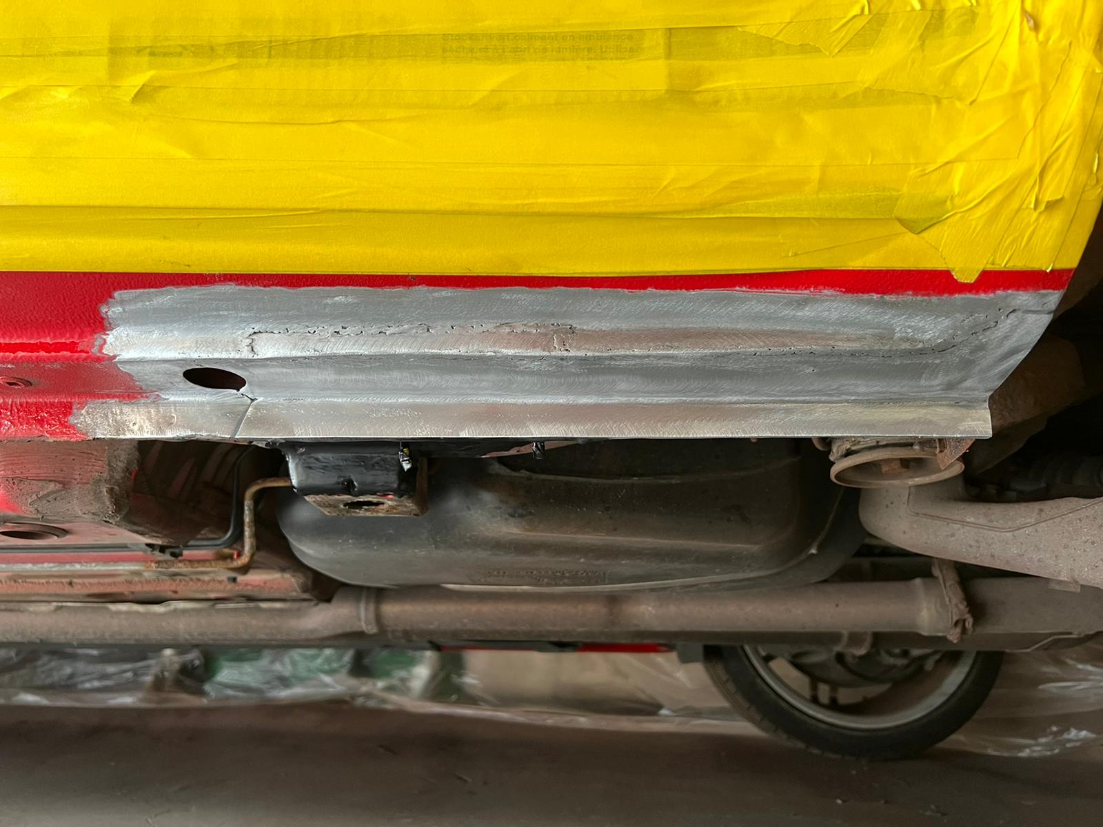

The first job was to get the sills repaired along with the jacking points to allow it to be safely put onto the lift.

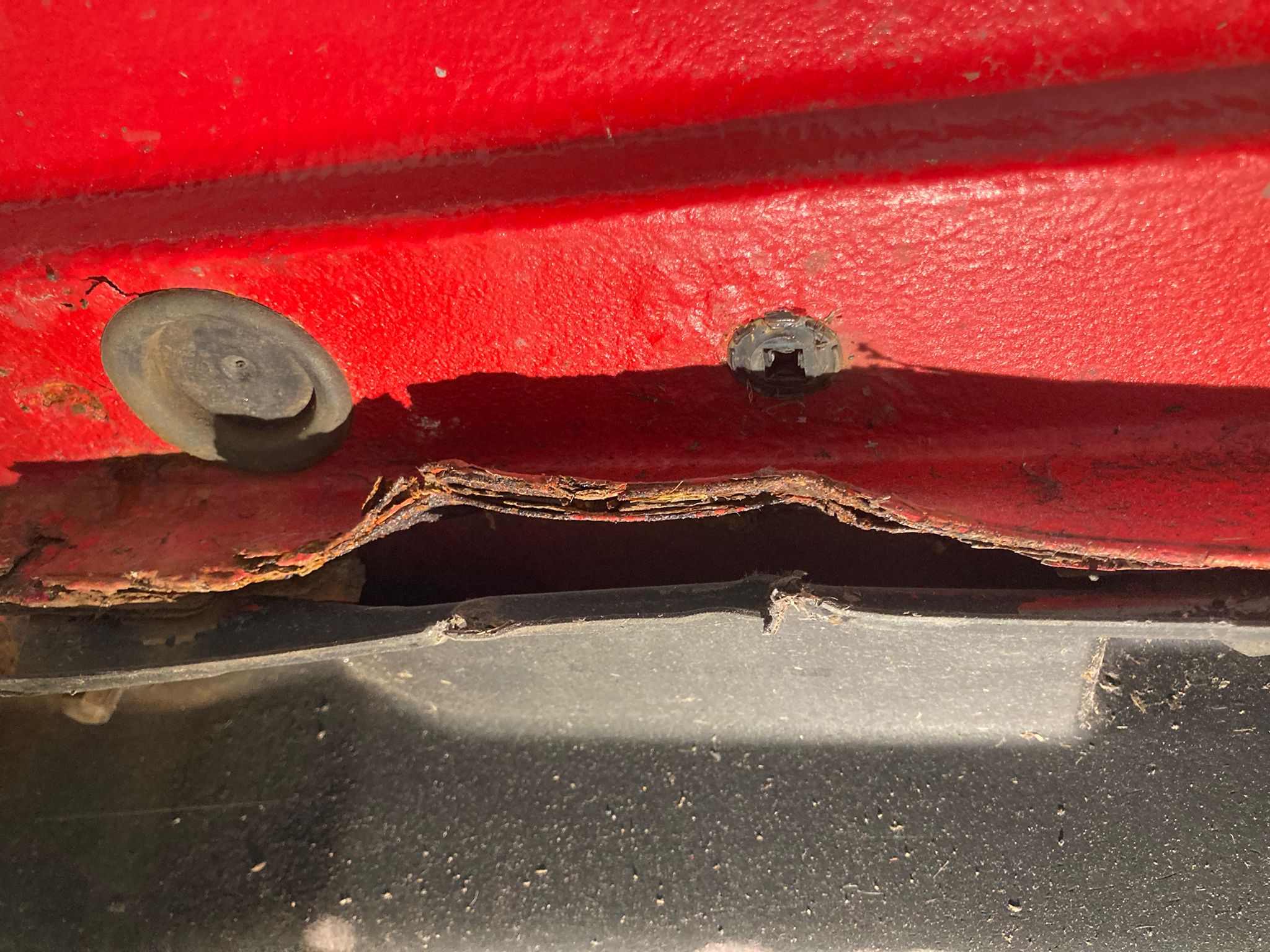

As you can see, the sills were in a terrible state! They were hidden by the side skirts so never flagged up on any MOT but I knew I was in trouble when a few month before, I placed an axle stand under the sill, lowered the jack and the car continued to drop back down!!!
The sills were repaired by using a combination of welding and bonding. Thicker gauge boron steel was used for increased strength, corrosion resistance and longevity.
