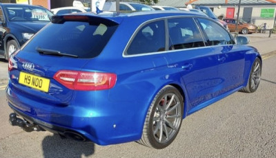

Currently for sale on AT.
Clearly all mountings are there for a tow bar.
I have seen others fitted with a tow bar too.
When I enquired with a local tow bar guy, he said it could be fitted but he wasn’t legally supposed to due to not being homologated for a tow bar.
If it was just for a bike rack I don’t see the issue.
