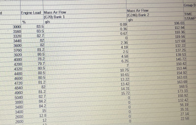

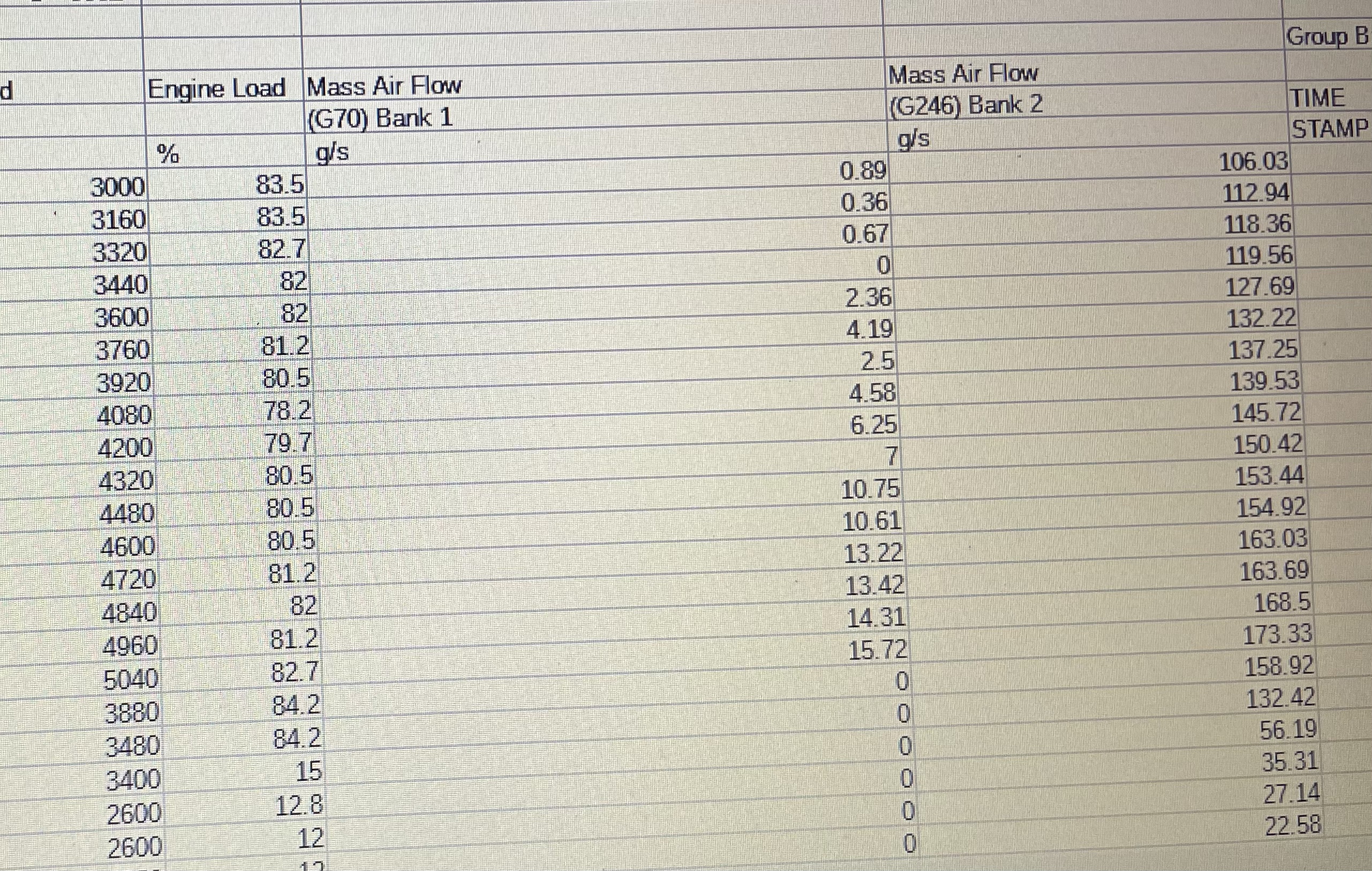

Afternoon all, hope you had a good bank holiday weekend so far! Started having a play with the car, checked the readings again and MAF’s way off now… checked the air box and assume they had “lost” one of the nuts that holds the air box down when it had its service :x
Reseated the air box and got everything bolted back up and issues remains, did some logging as per attached and was just running through the measuring blocks and noted the lambda voltages - not sure the range but not sure it should be that wide!
Just to add insult to injury also got the red band across the gear indicator 18227/P1829 - reset but feel like it will return
Any thoughts gents (Shop :bowdown: ) for a car that’s only done 850 miles in 5 years it’s an expensive hobby!

That's a really low MAF reading for bank 1. You might not have seated the airbox properly. I hate the bloody thing. Usually takes me a couple of attempts to get it seated right. What happens if you increase the revs?
I wouldn't worry about the lamda sensors until you sort out the vac leak.

You need to see what boost the car is requesting and what is being achieved. Drive it and log groups 2, 32 and 115.
If the car is not requesting, that is a different kettle of fish to not achieving.

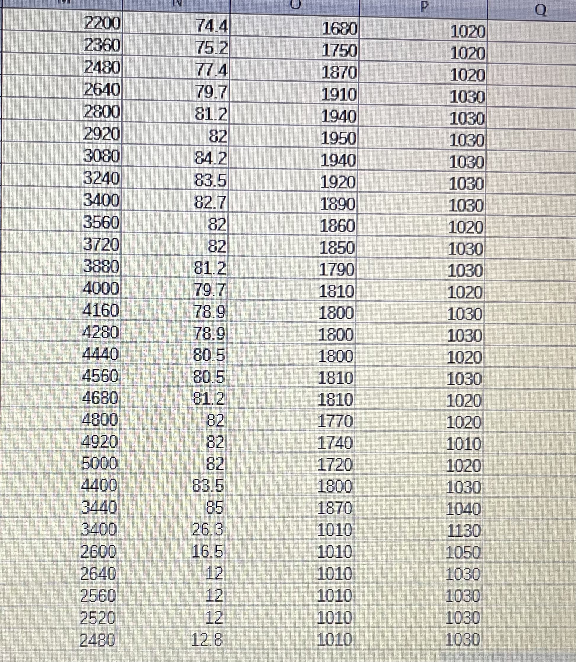

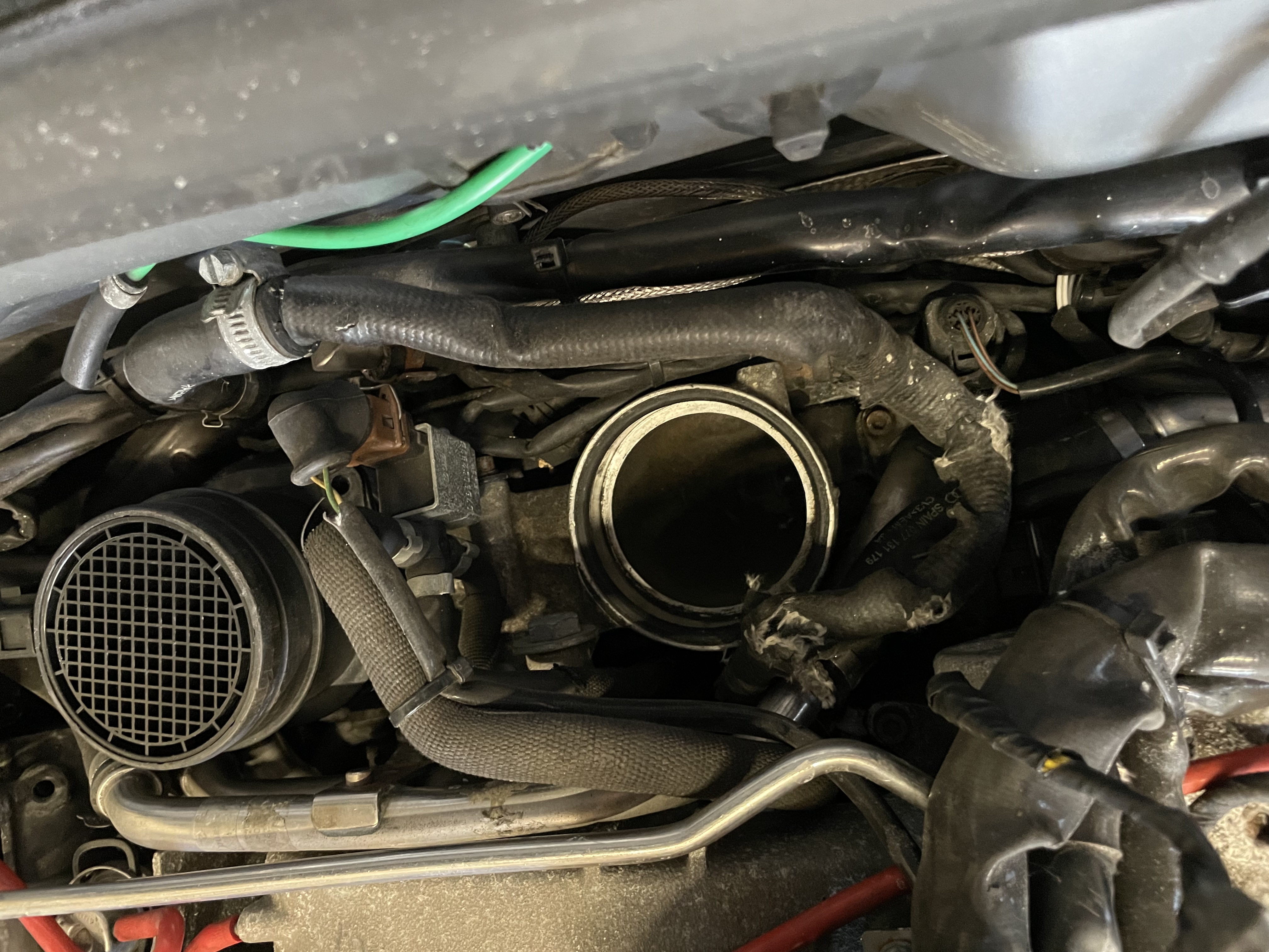

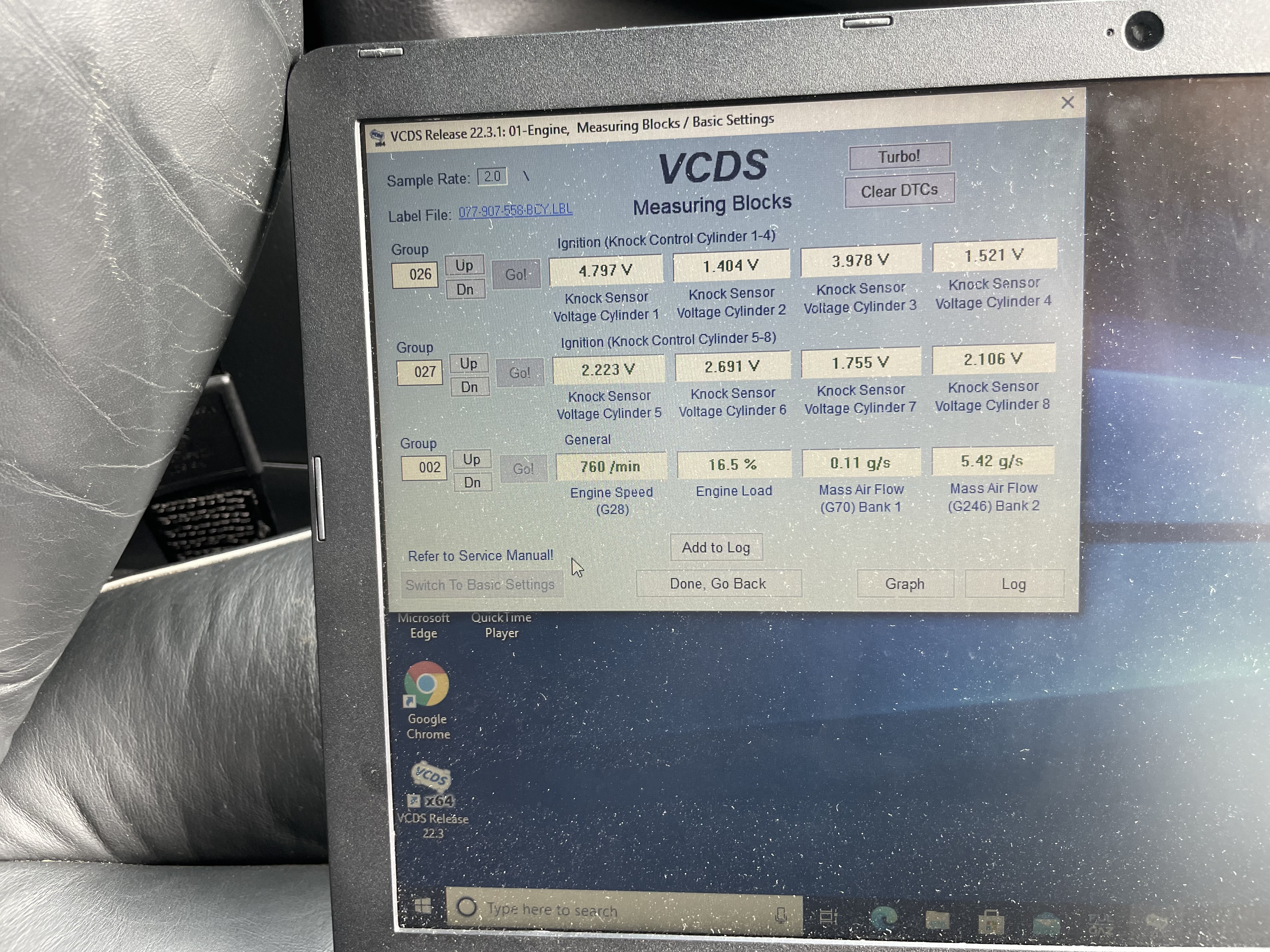

So had a play today, took off the airbox and one MAF was def not seating right, after a bit of investigation it was being fouled by a vacuum pipe - had the engine out on mine quite a few times so garage could have mis-fitted a bit. Managed to move it a bit, swapper MAF’s over and with no air is in they both read and pretty much in line, popped them back in the air box, seated properly and tested on VCDS again and still good.Got it all back together, went for a drive and logged - on bank 1 (same issue as last time) it’s still dropping out and the readings across the 2 are wild. Also logged the boost, looks like it’s being requested but not delivered…
MAF - scratching my head a bit, wiring issue maybe??
Missing boost, have not gone through the intercooler hoses yet but can’t hear anything…. Massive boost leak or something more sinister? Still no fault codes….. I did log 32 Shop but was all zeros?
