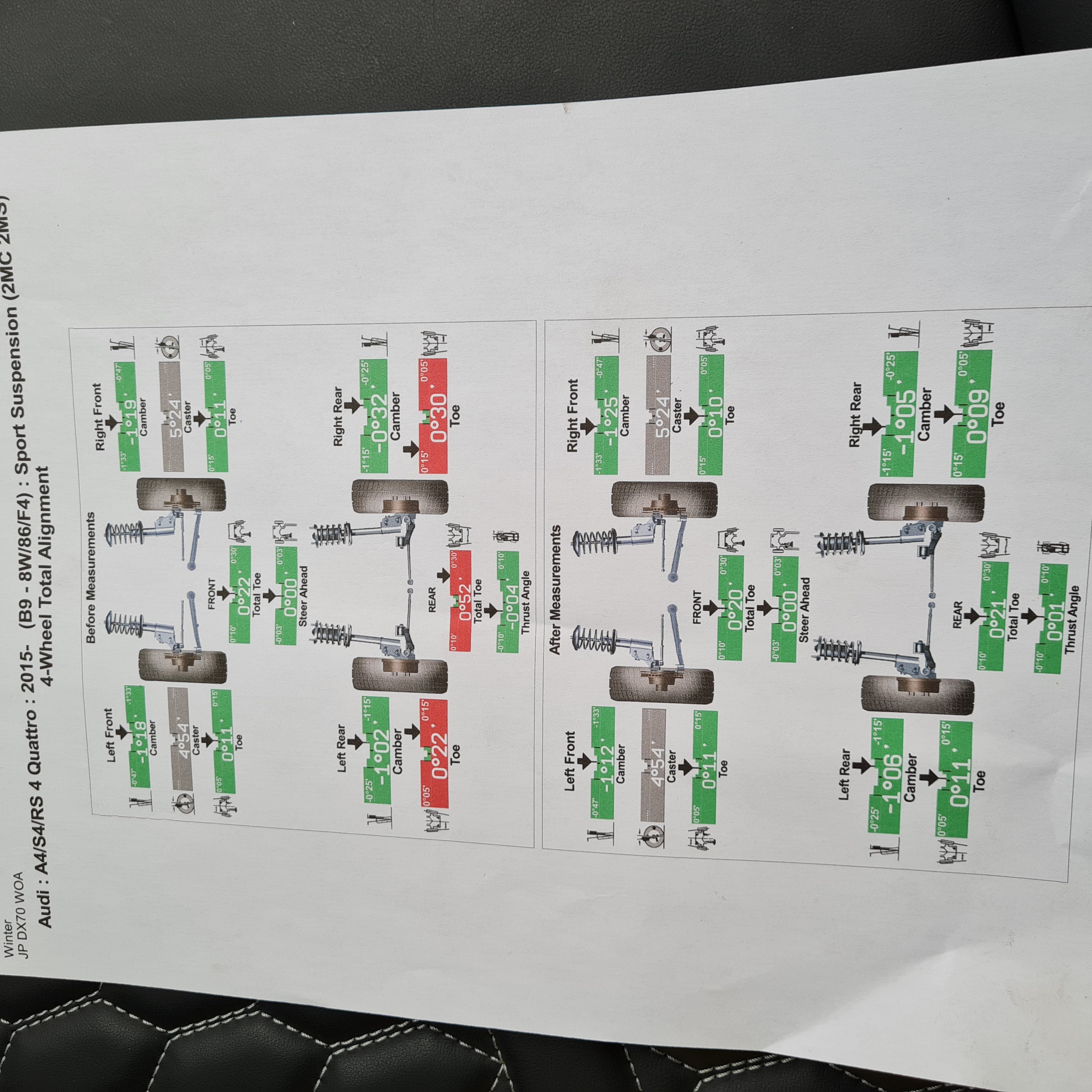

I have read that recall . The car specs list saying manufacture date before 2021, so that might not be a recall issue for me since my manufacture date is 2021/04.
I had it fix two weeks ago at dealer. however, when I pass a THICK Rubber Speed Reducer deceleration zone(very low speed) in parking lot, and I realized the crooked steering Agian. Now,I'm looking for other professional auto Shop to fix this. Annoying :audibash:
BTW, did you photo your alignment information ?

Hopefully attached sheet they left in car..... doesnt give the limits but does give the settings that are classed as green....

Nice. Appreciated
