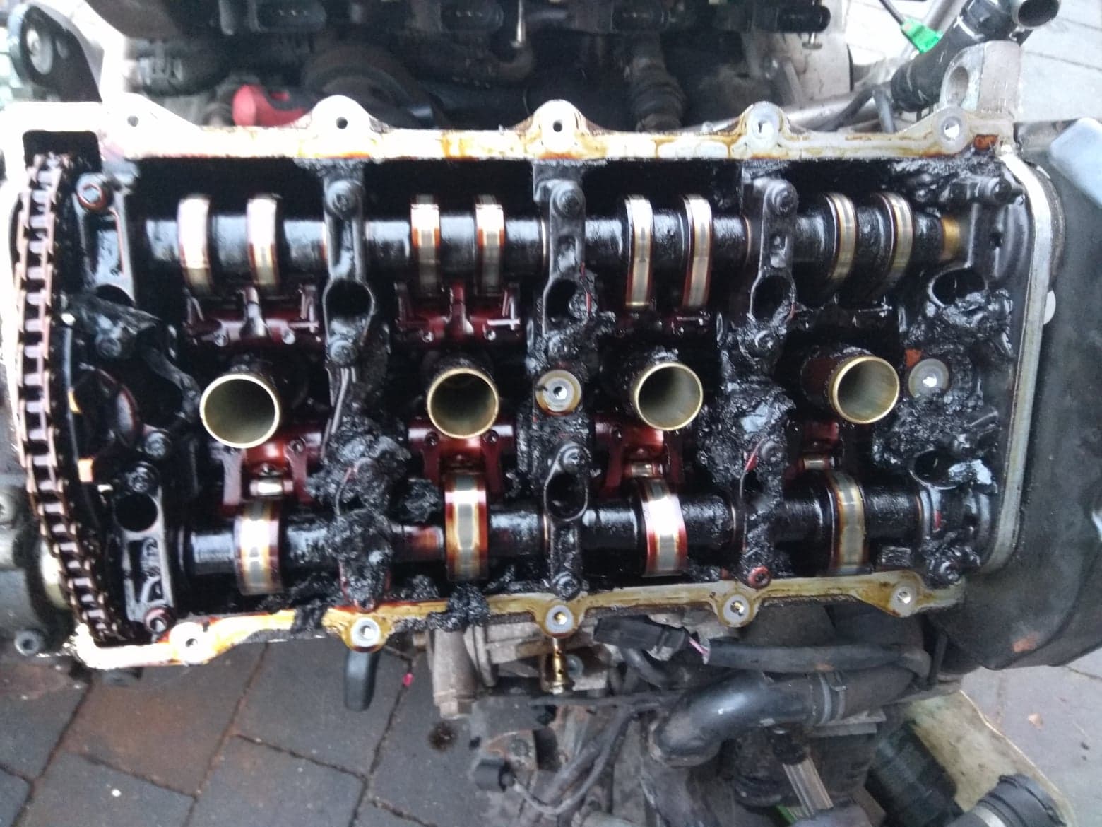

I have posted before about my poor car. It was a great car until the TQ failed or worked loose and toasted the gearbox. In doing so it also wore the crank snout.
I was going to get a a good second hand crank I had sourced but my specialists in surrey say that they cant get new bearings from Audi anymore and they wouldn't put a decent used crank in with out new bearings (My car has done about 92K). So the car has sat in surrey with engine out for a bit over a year so the weather has had a bit of an effect, so will also need a some fettling etc .
My choices it seems are sell as a non runner or patch up and keep by having the crank snout welded up and get a recon box and torque converter from Chester automatics. My specialist says they could weld the crank but they are not sure how long that would last. I suppose my question is should I spend £5K on box and Torque converter and other bits etc putting into a car with a welded crank snout. I am still struggling after a year to know what to do.
I would sell if I could but it is too good and with good history and loads of good things about it to sell super cheap for parts. Help appreciated.

That’s horrible luck.
I’d be making super sure that there was no bearing shells available. I bet they’re the same for all the C5 V8s. Maybe even the B7 V8s. Are there any aftermarket ones? Can you get some made?
What about trying to source another engine and bow from a breaker? These engines are generally indestructible even if you’re the exception that proves the rule.

Do you have a pic of the crank snout damage?
I think, if it’s genuinely shagged, I’d be just replacing the engine, rather than fannying about with crank swaps. You really need a proper engine builder with a clean room to contemplate that kind of surgery.
Although, it’s all aggro for you. Step one is deciding if you can be bothered with all the aggro.

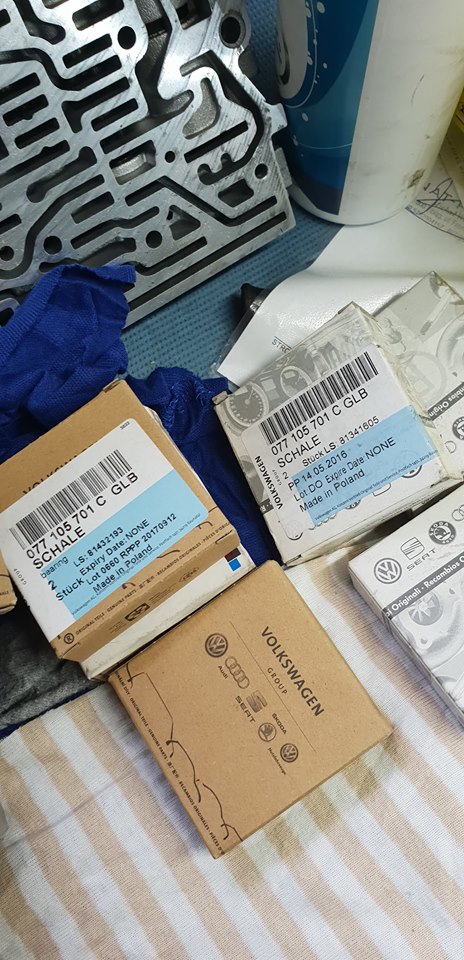

Looks like it's the same bearings as all other V8s from 94 onwardsish.
Interesting discussion about it on motorgeek : https://www.motorgeek.com/viewtopic.php?f=10&t=8621
And it looks KingBearings have done a production run before (I found some references to them elsewhere as well as motorgeek), so might be worth an email to them : https://www.kingbearings.com/

There's a list of king bearing distributors: https://www.kingbearings.com/where-to-buy/
Re: decision time .fix., or sell as a non runner
Potentially this is the big end bearings : http://www.king-catalog.com/Catalog/Engine/20049213
However big ends also seem to still be available from audi.
Can't find mains though from King.
