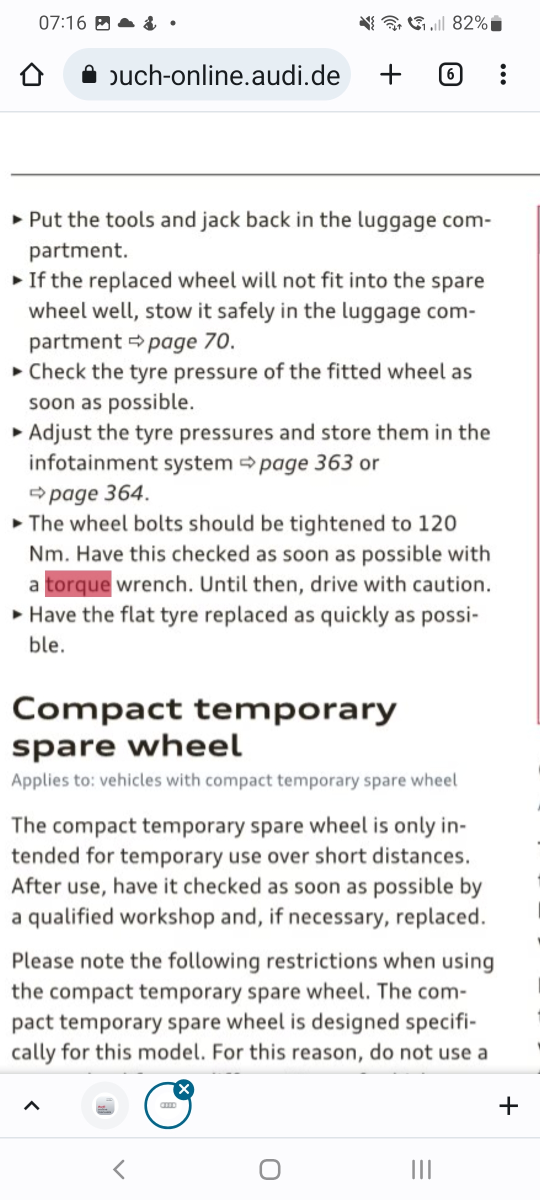

Post by Brooner » Sat Jul 16, 2022 7:17 am
There you go 120nm from the owners manual
