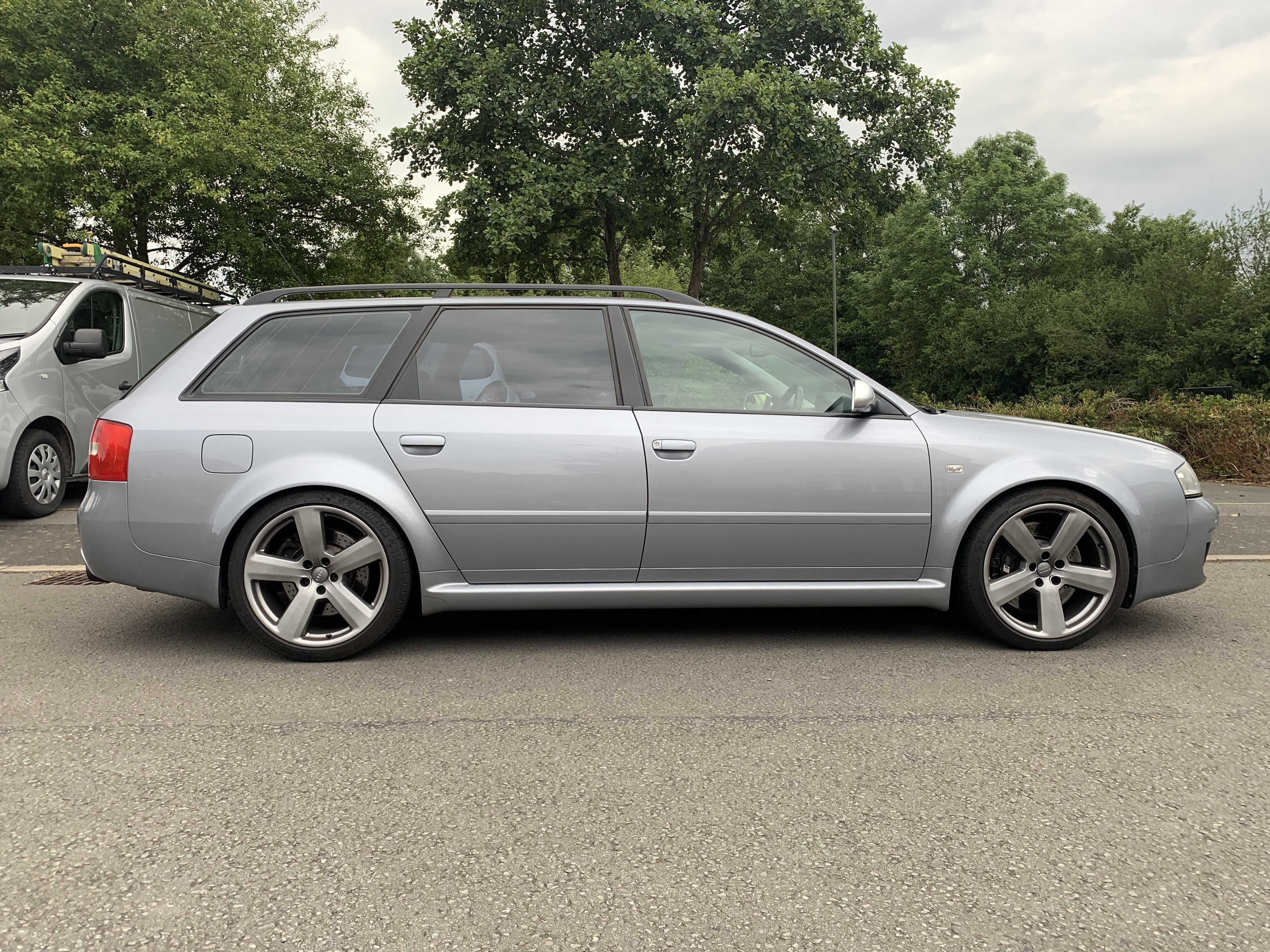

I’ve noticed a little knock on the front. Which I reckon is the drop links. The front right one looked a little older than the front left. Is it worth getting some drive on ramps so I can check it and the rest under load ??
The only issue I have noticed I’m not sure about is the rear right corner seems to sit lower than the rest. Has anyone else had similar issues on these ?

So this is now after two days
This is just after it was fitted. Seems the suspension has settled a bit. But almost a bit more at the rear
