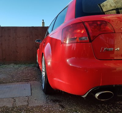

Do the rears look as though they are sat to deep in this or is it just the angle???
I mean they look like they aren’t wide enough and don’t fill the arches???

Offset is ET29 for the OEM 19" wheels. As standard the outside face of the wheel does sit inboard of the arch, this is to allow the fitment of snow chains.
8mm front and 10mm rear is the normal size spacers you can run without rubbing but it depends on tyre manufacturer.
I run 8mm H&R all round with the ride height set to SS+ (KW V3) and Michelin PS4S with no issues.
You can remove the upper arch liner screw at the front if you find it rubs with the 8mm spacers.
