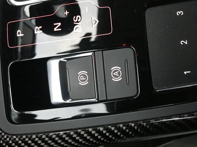

I can't recall ever pressing that on the standard A6.
I've just had a press in the RS6 and I think it is something to do with auto-release of the hand brake.

That button with the A on it applies the brake when you are stationary and press the brake pedal hard and stops you rolling forward when you release the brake and will only work if you have your seat belt on. This is not the same as automatic handrake activation.

When Auto Hold is on and whenever you’re stopped with your foot on the brake hard enough for it to pop up with the green P symbol, put the car in park and whenever the drivers seatbelt is undone or ignition is turned off it should automatically apply the handbrake. However this is on my fathers MY15 FL which may be different.
