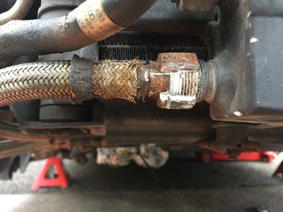

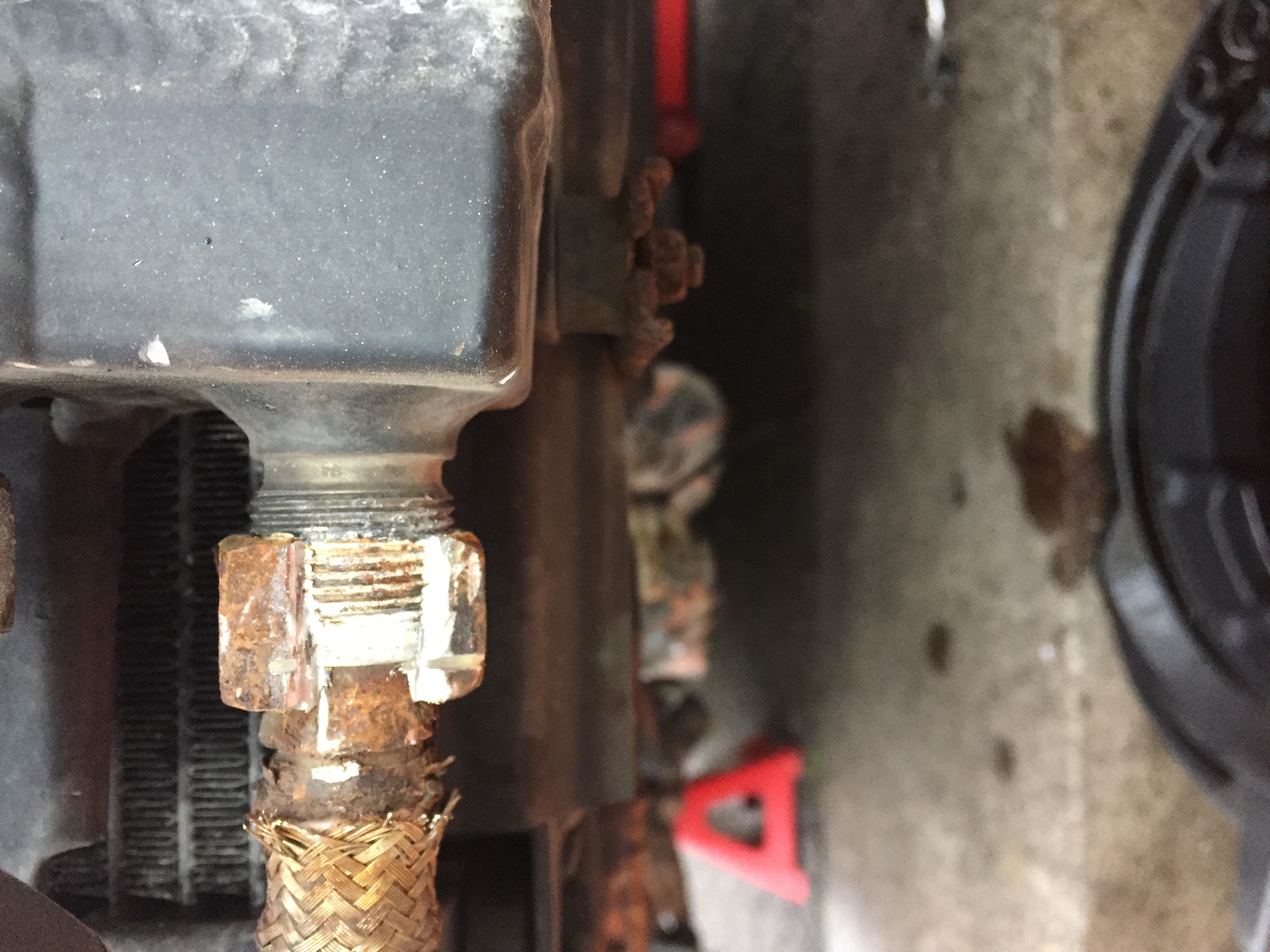

aRSe.... The garage called me today and told me that they didn't think things were going to work with the DIY route.
........................... my plan was to gently cut twice (180 degrees) into the steel connector end on the rad hose, down to just where you could start to see you were coming down to alu thread, then crack/spread with a big flathead screwdriver to leave the alu thread in pretty well mint condition.......................
Thanks.
That's a pity. That process you mentioned was one of the techniques taught when I did my apprenticeship and it is well thought out and safe. I'd use a nut splitter though, not a screw driver. No wonder we're into the mega pound / dollar services when every solution is new factory parts.

IchBautAuto wrote:
Wed Nov 20, 2019 10:35 pm
Mr Footlong wrote:
Wed Nov 20, 2019 5:06 pm
Thanks.
That's how I got mine off. The Dremel paid for itself! Surely the garage could have done it. I just took my time with it and it went ok.
