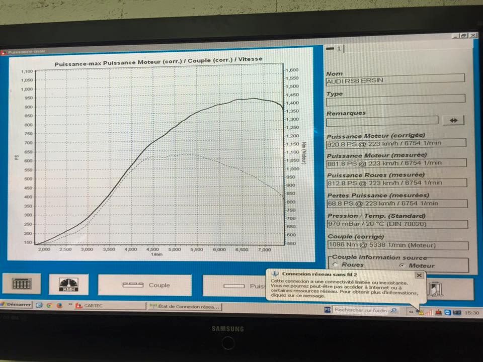

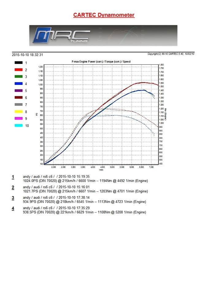

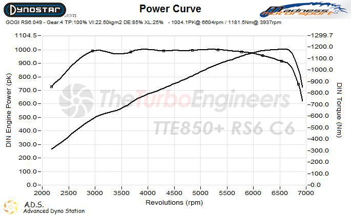

Looking around it seems there are a few cars around the 1kbp mark using TTE850 turbos.
Those figures by typically achieved by using water / meth injection and race fuel, but only if the turbos can blow that much air.
As I understand it, increasing octane and cooling the charge simply allows the tuner to use more boost, so the gains only occur at higher revs where the turbos are able to generate more boost.
So perhaps the TTE850 was the TTE1000 all along, and that may be about as good as it gets with a stock engine.
Nick

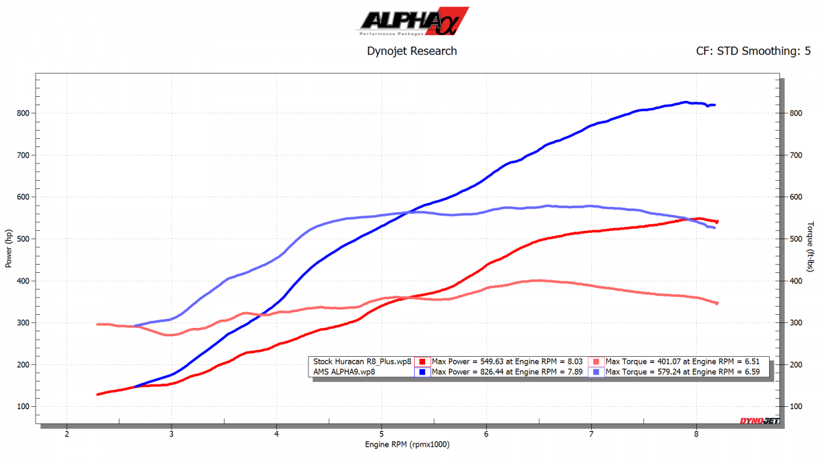

Tuners don't always give much information about what they do, but AMS have just announced their R8 V10 TT bolt-on package. The engine and transmission are stock, but the bolt-on parts look cost-no-object, and the charge coolers are huge.
https://www.amsperformance.com/cart/aud ... kage.html/
On pump fuel, wheel power goes up from 549 to 826, and torque from 401 to 579 lb-ft (44% more). The gains suggest a boost pressure of half a bar, which I think is typical for Lambo tuners.
What's interesting is that they give power and torque curves, and the peak torque and power revs are hardly affected by the conversion. Peak power is at 7890 rpm and peak torque at 6590 rpm - higher than the POWER peak of any tuned RS6 engine.

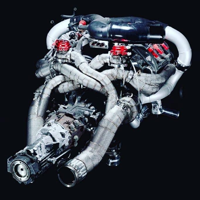

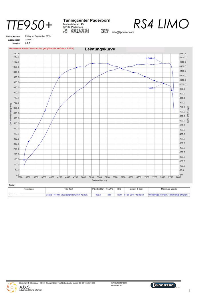

It's a lot of revs for a large engine - like a highly tuned RS4 B5 in fact, which will probably produce the same power and torque from just over half the capacity.
I never paid much attention to the B5 before. It had an idiotic 90 degree V6 which meant a split pin crankshaft, and the plumbing was a nightmare - intake, exhaust and charge air running backwards and forwards alongside eachother. But in spite of all that it could make huge power. The turbos are behind the engine, so there's just enough space for proper tubular manifolds.
You can fit free flowing manifolds on the B5, C5, R8 and GTR R35, and reach for the stars. The RS6 V10 has the torque converter behind the differential, so the engine is further back, and there's little space for fancy manifolds or lofty ambitions.
Here are some examples of dog's dinner plumbing, and the amazing results it can achieve in spite of it all.
Nick
