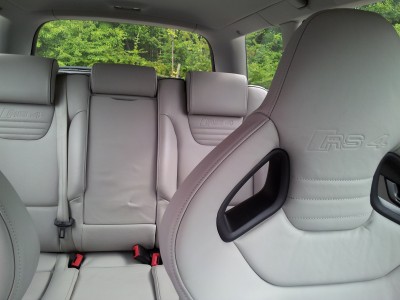

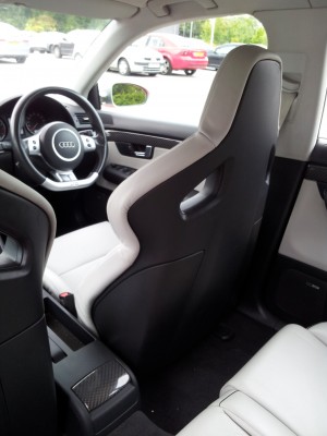

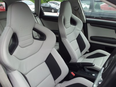

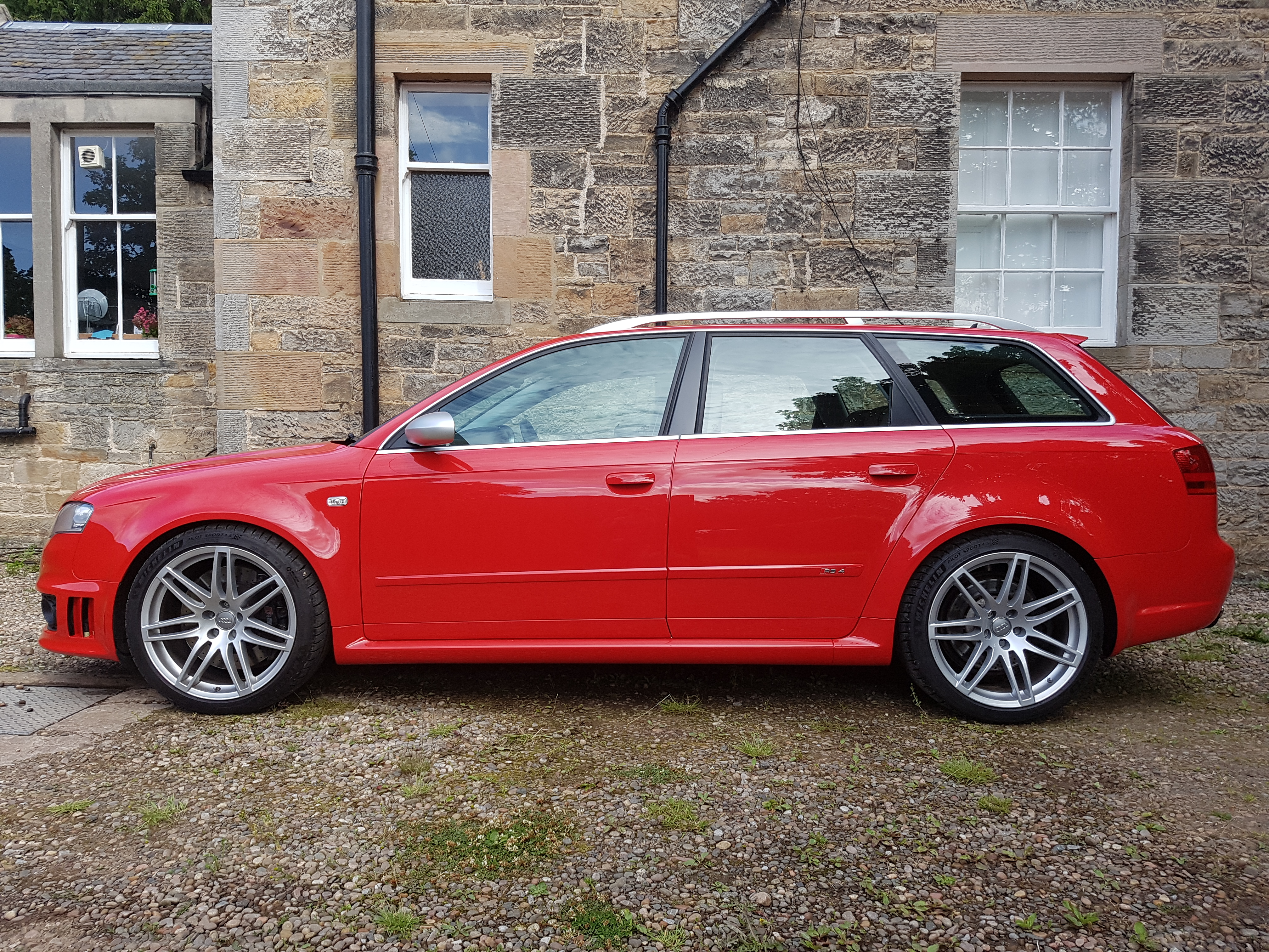

Apart from the KW V3 coilovers and the H&R arb's the car is mostly stock.
034 Motorsport adjustable upper control arms were fitted as the inside edges of the front tyres were wearing out too quickly. Once fitted, there was a noticeable improvement to the steering feel as well as more even tyre wear at the front.
At a service, it was noticed that the oil cooler pipes were badly corroded, so the unit was replaced with the Forge Motorsport item. Hopefully this should last a bit longer.
Unfortunately at some point the original oil cooler had worked itself loose and damaged the main radiator. Not enough for it to leak but it was a potential weak point in the future, so this was replaced at the same time whilst the bumper was off. The aux radiators had been changed the year before so that was one less thing to worry about.
All the clutch/fly wheel, slave and master cylinders were replaced at around 100,000 miles just after I bought the car, so hopefully I will get another year or two out of them before they need doing again.
The cause of the biggest running issues in the past had been passing injectors. The weeping causes the sparkplugs to become wet so they produce a weak spark which then results in engine misfires. By monitoring the misfire counter per cylinder, I was able to work out which injectors were faulty. This was confirmed by checking the condition of the plugs. Going by the service receipts from the previous owner, I suspect this is why the car was sold. It had been in and out of the local Audi dealership a few times over the space of a month just before I bought it. Considering it was still doing it when I bought it, it was never fixed.
The car has run well enough since, though. However, it only passes the MOT emissions test on the right exhaust so suspect the unburnt fuel has damaged one of the left side cats!
The only other mod has been removing the centre resonators from the standard exhaust, which is without doubt the best modification of all. Two straight pipes were welded in and now it sound glorious with the valves constantly open. Not too loud to use as a daily though and no drone. However, it is a bit loud on a cold start.....
Apart from that finishing off the paintwork, either retaining the KW V3 setup or reverting back to DRC is next on the list.
The next time the front brakes need replacing I might consider swapping to the OEM ceramic setup. I do have a complete set of spare calipers that I really should get refurbished but I really like the idea of the less unsprung mass and longer disc replacement intervals of the ceramic setup. If anybody has made the switch can they comment on pedal feel? Are they difficult to modulate when cold etc?
The bucket seats I installed 6 years ago to replace the original comfort seats are holding up well. Much better than I expected to be honest given the colour. So glad I did though as the car would not feel as special without them.

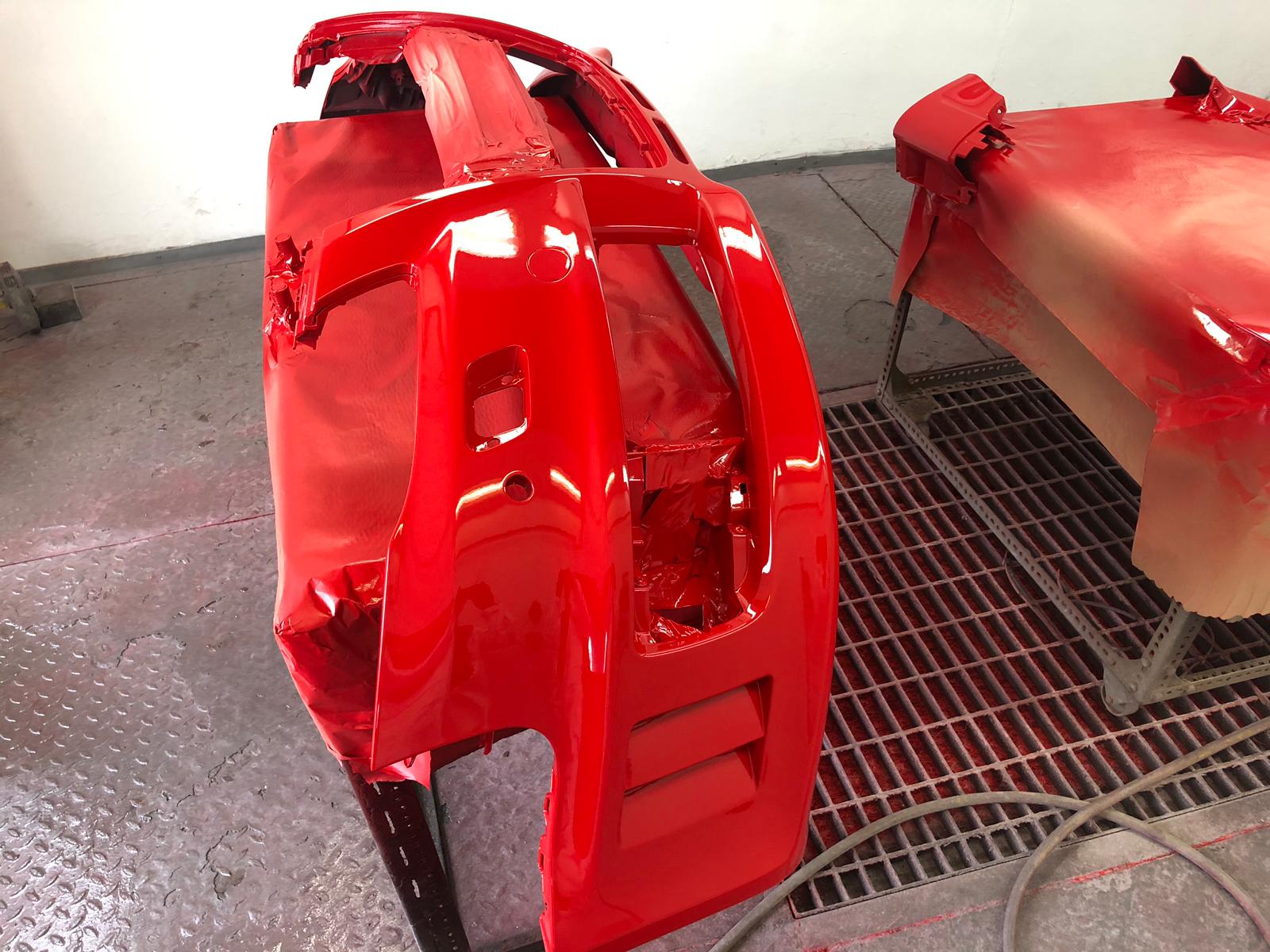

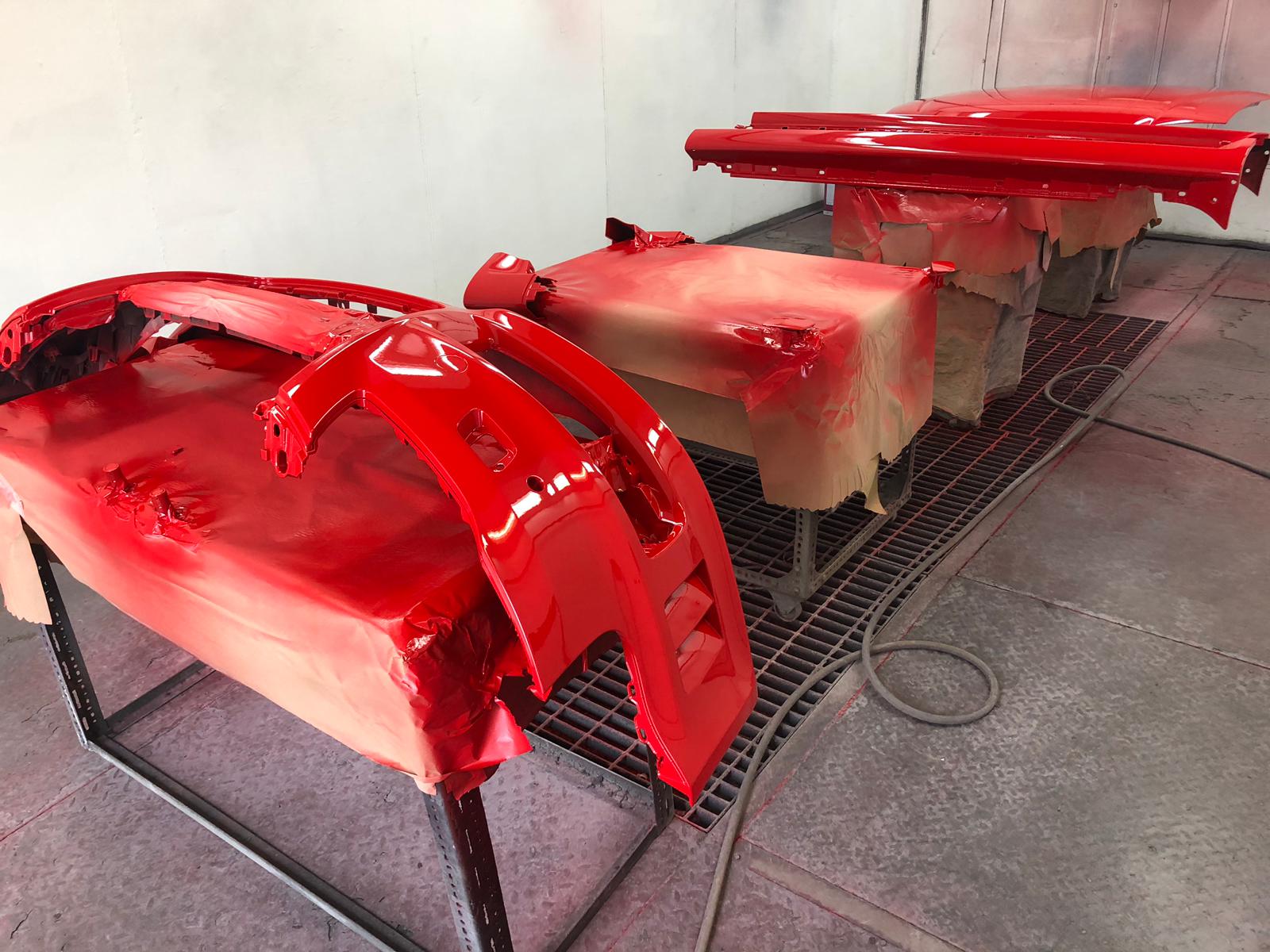

Misano Red RS4 B7 Avant
Re: Martin's RS4 B7 Avant Build

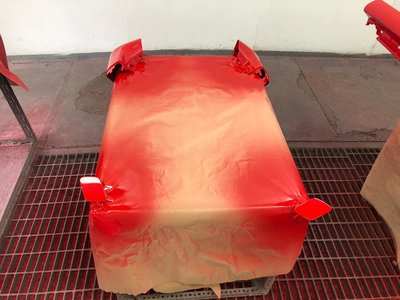

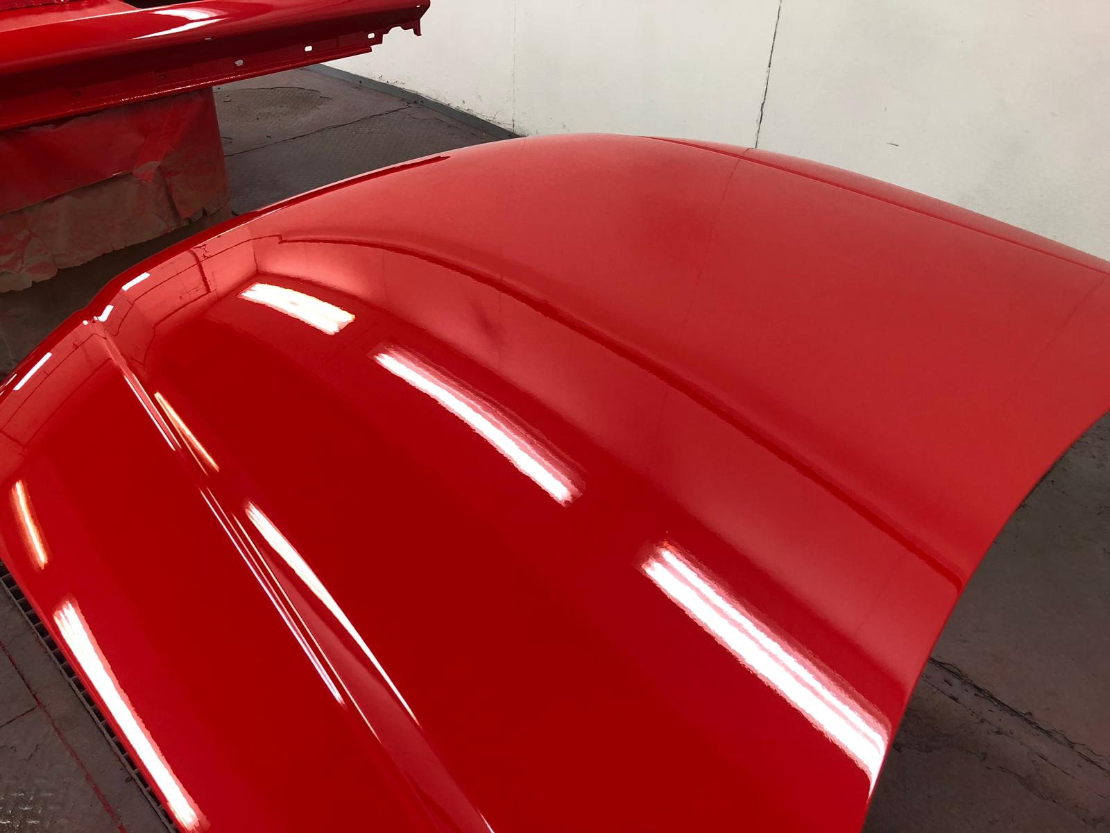

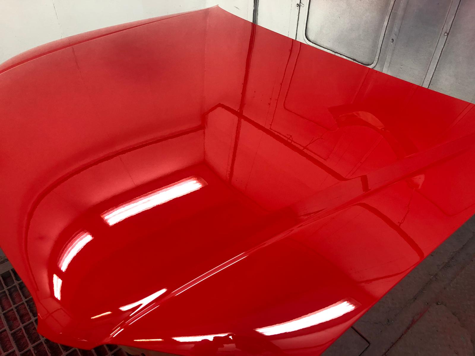

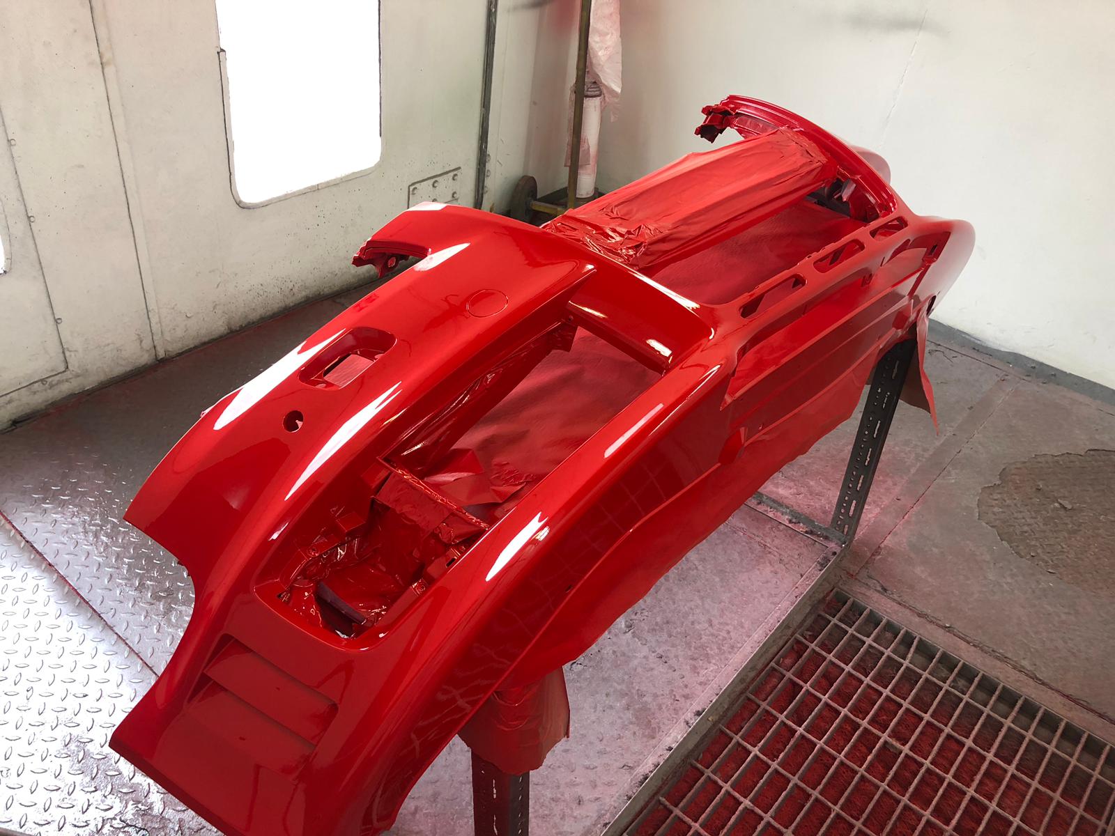

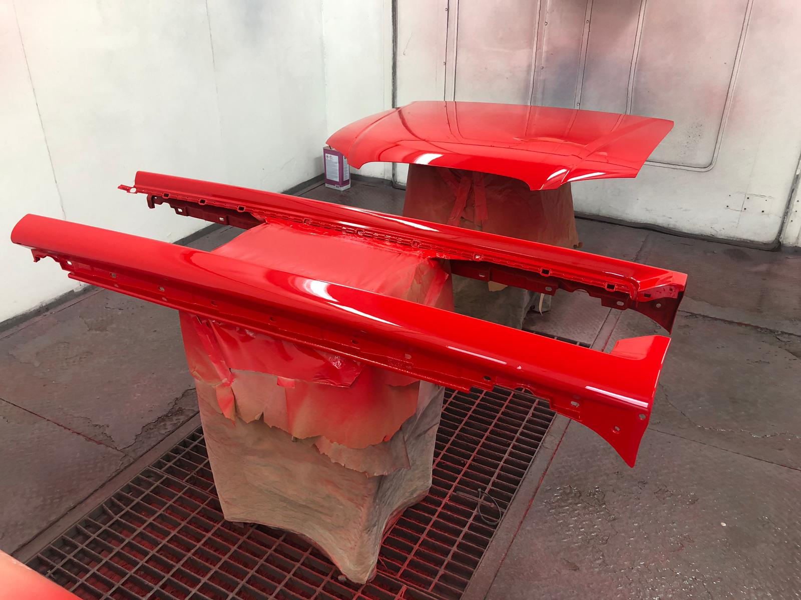

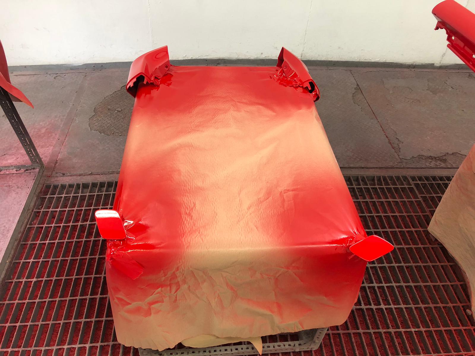

The bonnet, bumper and side skirts all have fresh paint on them now.
If these are anything to go by, the car is going to look great when finished.
5 star treatment, well on the way to immaculate condition

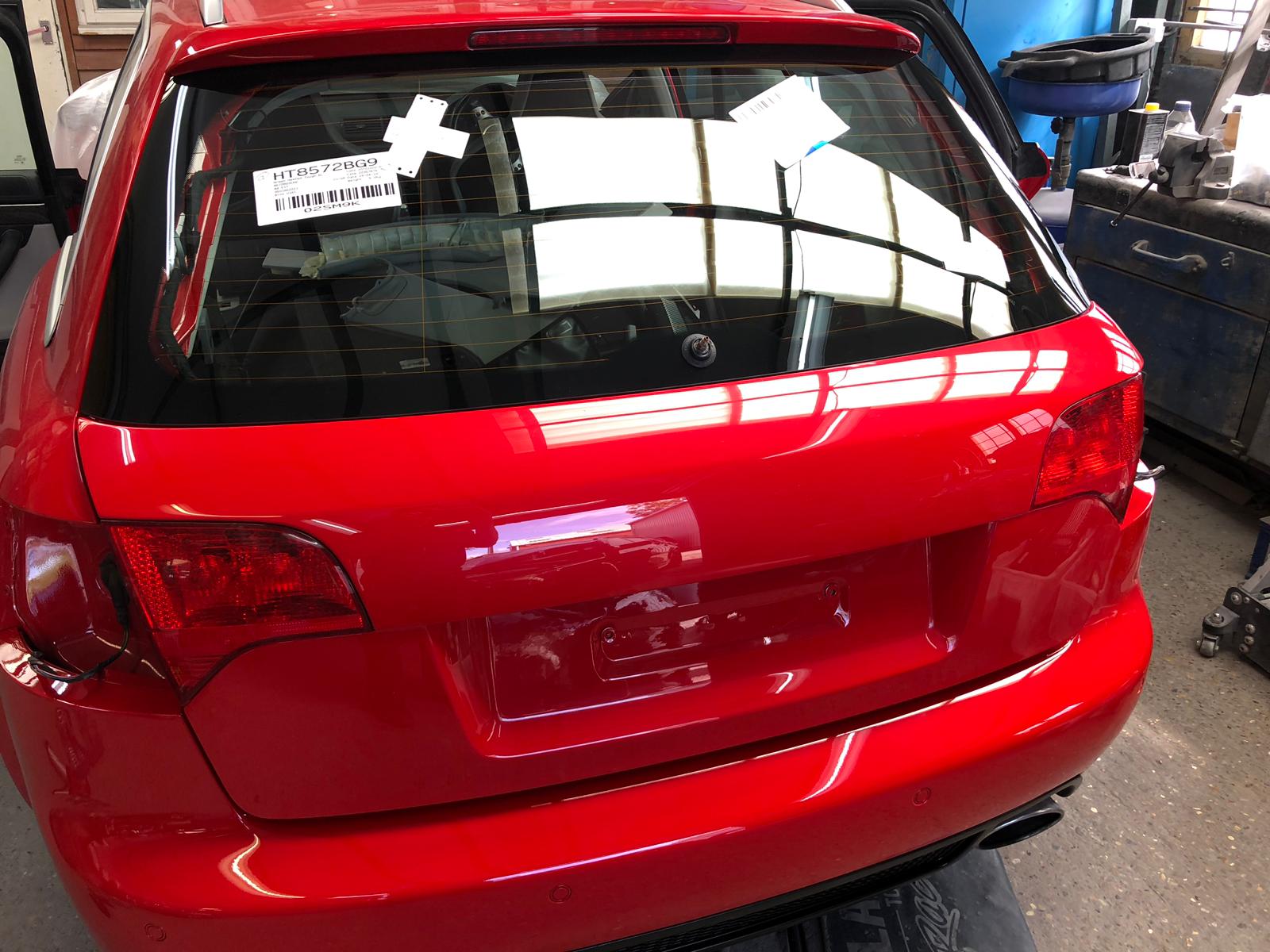

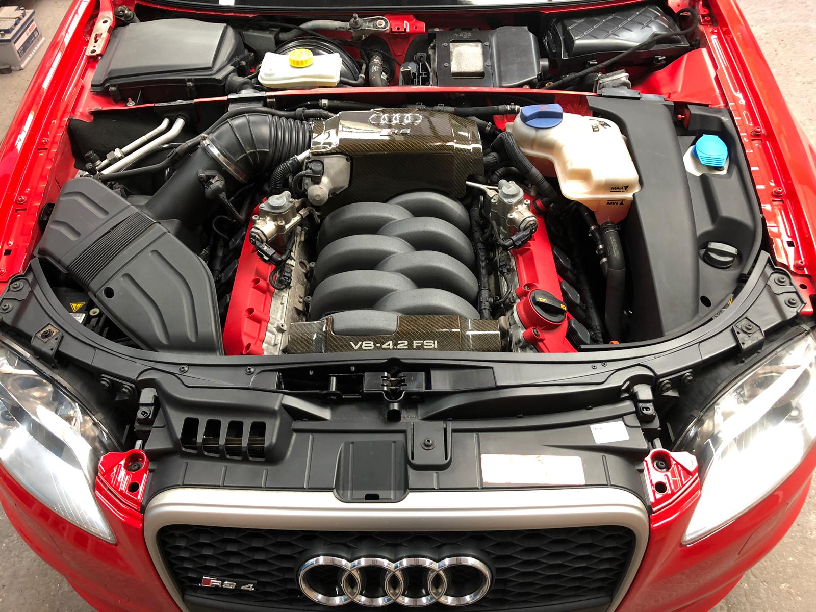

Update from the paintshop, the car is almost fully back together, just some bits of trim, bonnet and badges to go back on.
All going to plan, I will be picking it up next week!
Been planning this for a long while now and having not seen the car since the beginning of April, I am really looking forward to picking her up
Booked in for a full geometry alignment the following day so I will get them to set the front arb to soft and adjust the rear ride height to SS+.
And then finally get around to changing that coolant expansion tank.....

Picked the RS4 up from the bodyshop on Monday, I can't fault the quality of the finish, it has turned out much better than I could have hoped for.
Panel gaps and shut lines are spot on. The new front and rear screens make a huge difference, it feels like a new car now.
Full geometry check carried out on Thursday and it turns out the anti roll bars were already on the softer settings. Rear ride height raised up as it was sitting a bit too low vs the front. Might have went a touch too far but will see how it settles.
The front can't go any lower as the downpipe flexi-hoses already catch on a speed bump near my house.
Nice to have the car back again and another step closer to getting it how I want it.
