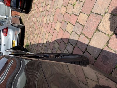

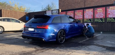

So, 2015 face lift with 15mm rear and tools in the boot, perfect!
2017 PE with standard everything, no weight in boot, looks too small and I could swear the wheels look narrower as the rubber is stretch over the rim a little
M3 with 30mm wider ET, too much as it rubs.
I reckon the sweet spot for RS6 is 20mm rear and 5mm front, if at all. You can feel the car tramping on the white lines a little and I'm pretty sure someone doing a 4 wheel alignment would cringe, but it sure looks good!
Apologies for the autorotate, iphone PITA

I'll get rear facing low down photos of both cars this next few days, a mate has bought the blue car so I still see it (and miss the sepang)...
