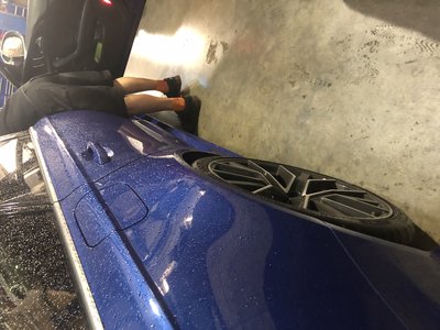

Post by HDPete » Fri Jun 07, 2019 9:20 pm
20mm trial spacers
20mm

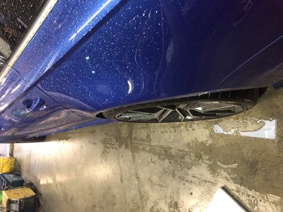

Re: Performance spacers
Post by HDPete » Fri Jun 07, 2019 9:21 pm
Vs standard
Vs standard
