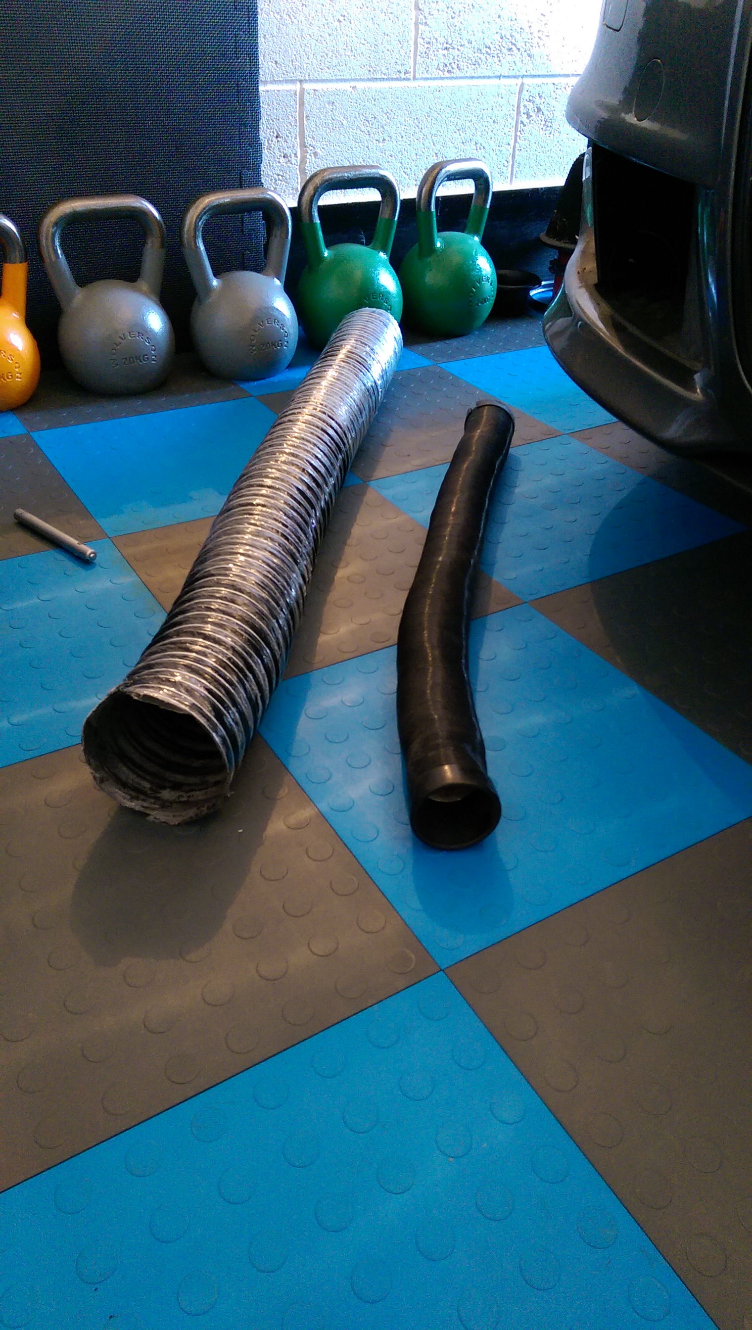

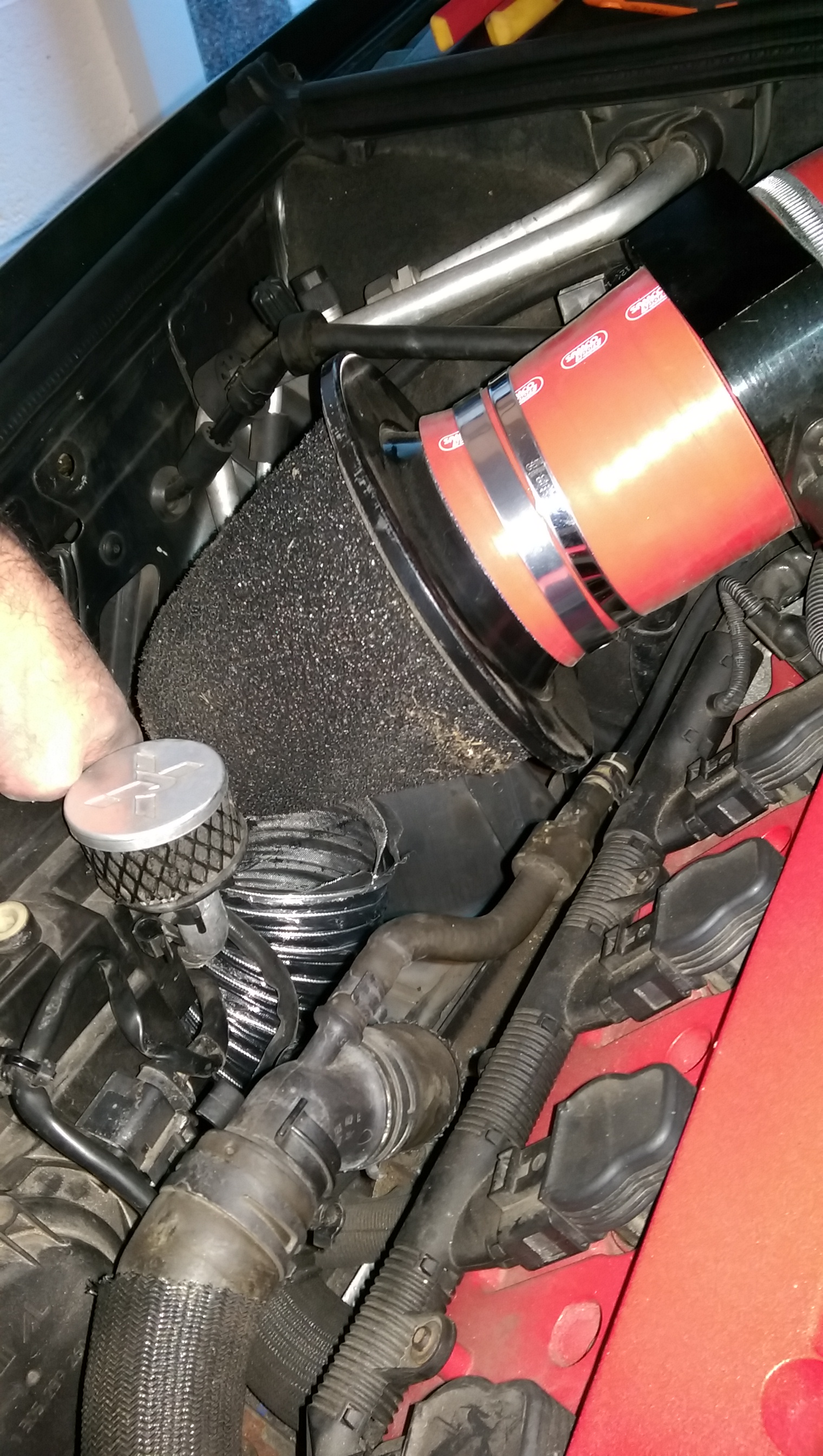

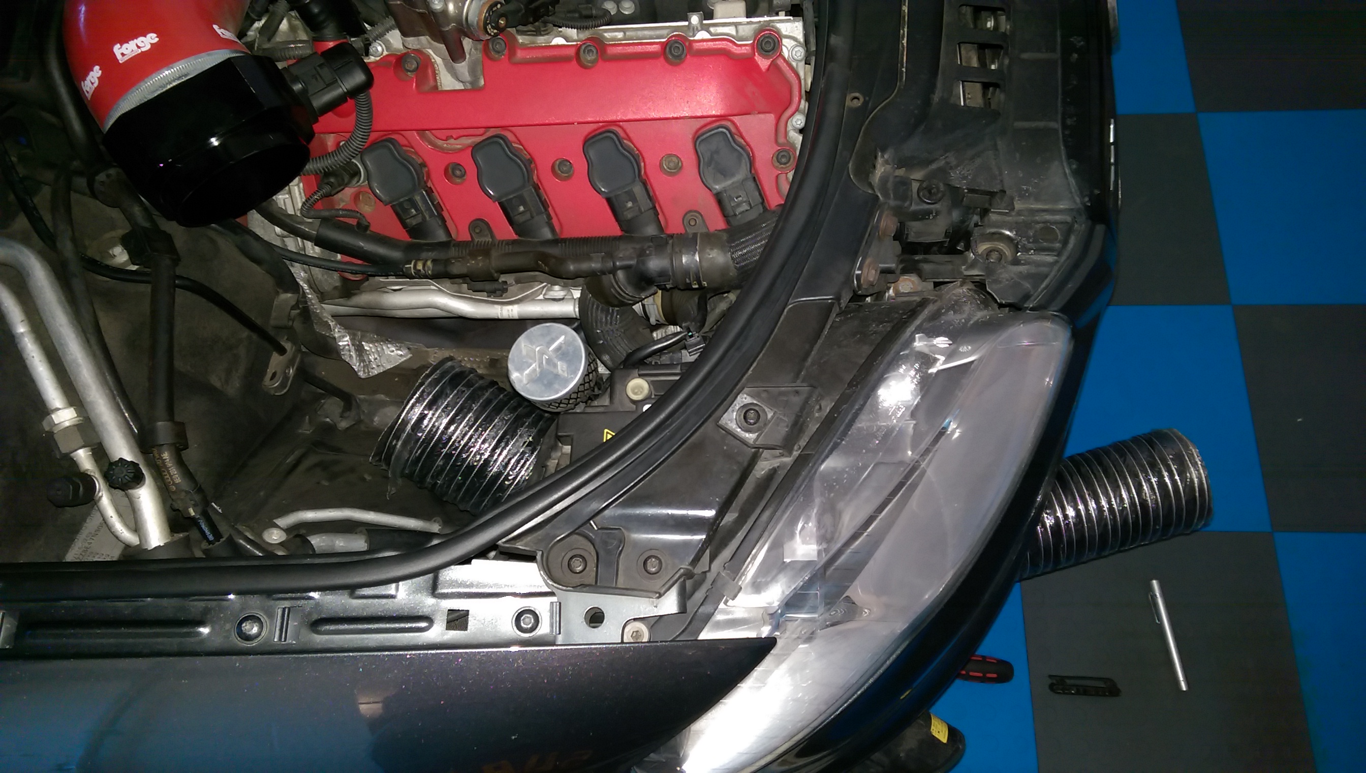

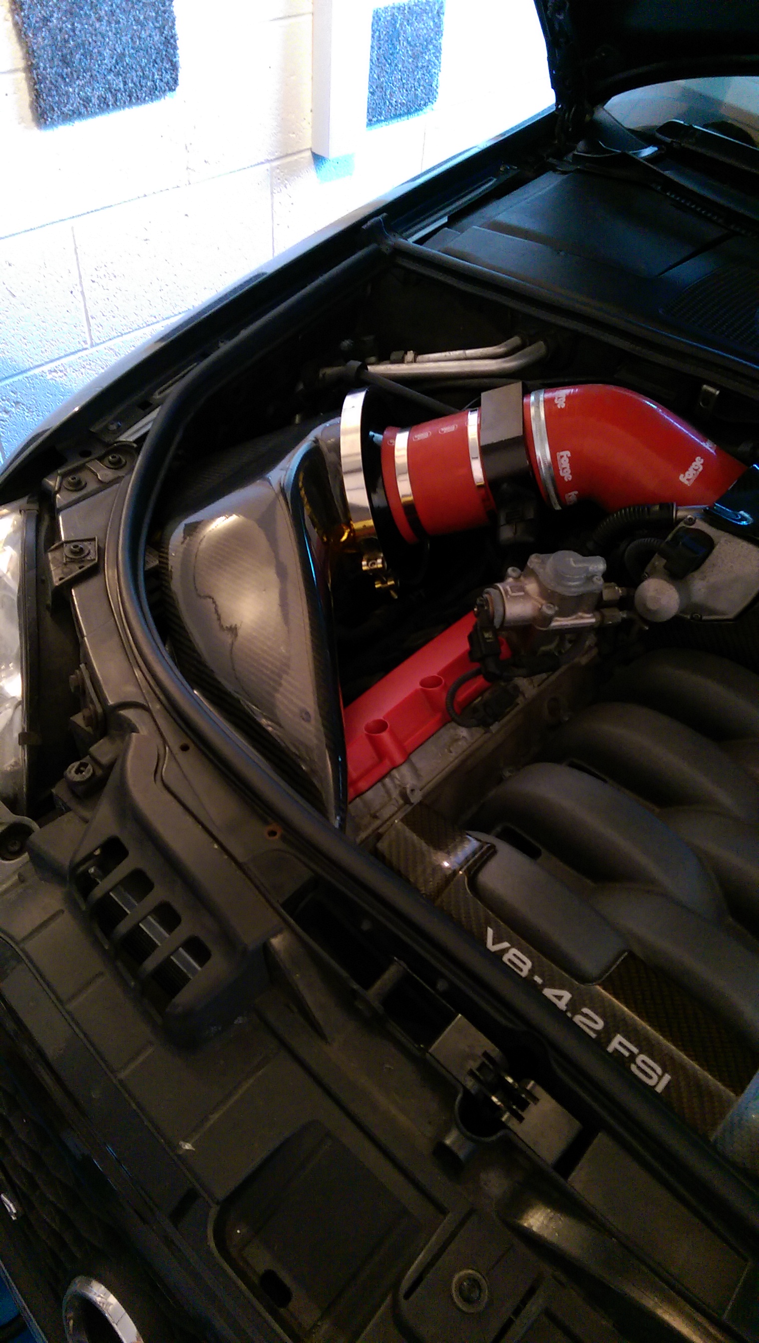

Heres a few random pics of my upgrade install -
45mm diameter feed removed ready for 102mm. My opinion is any larger would be struggle to fit
Inlet trumpet fitted
Engine bay bling

Post by Covkiller » Tue Nov 27, 2018 10:40 pm
Looks like a smart job. And I bet it sounds proper Nascar ?
