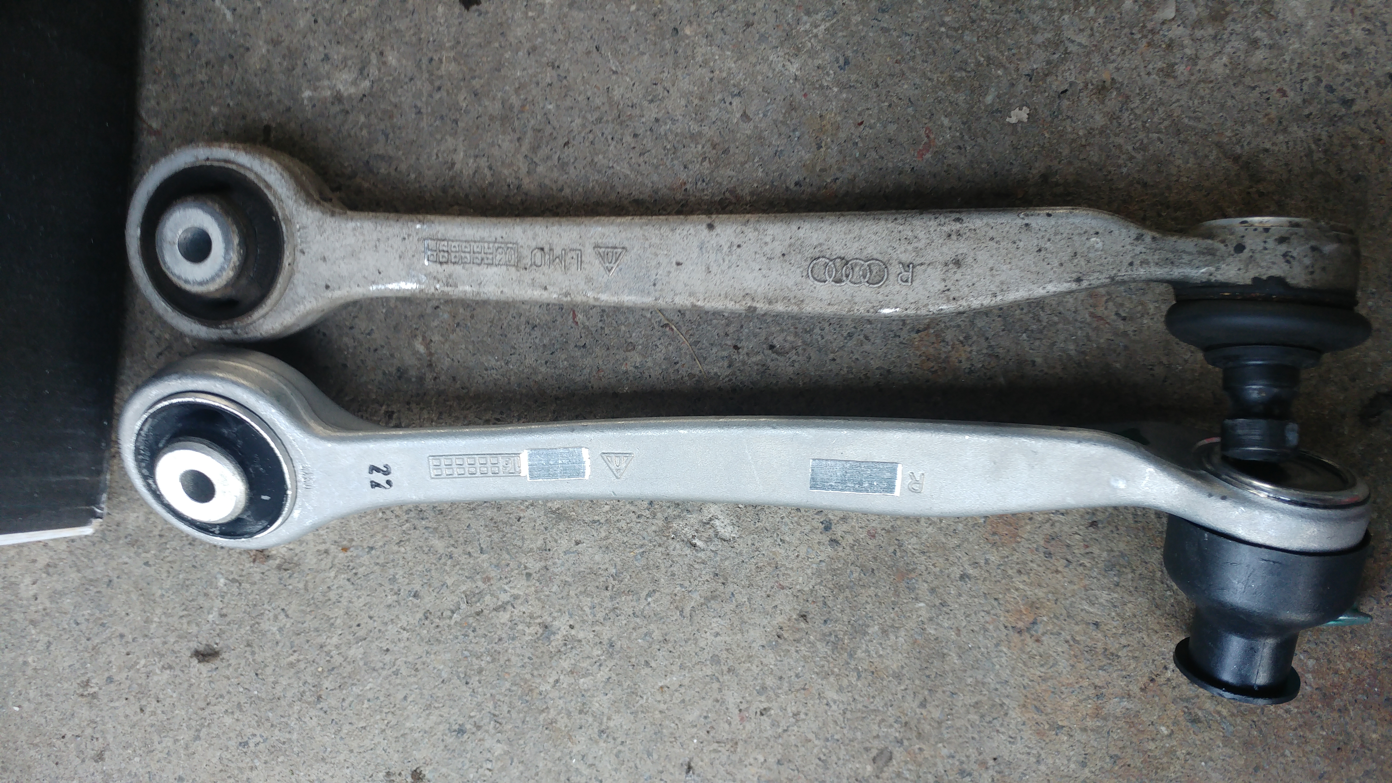

I recently changed all uppers, a complete pig of a job especially with DRC shocks....
I used small butane torch and with constant heat on upright pinch bolt eventually started to move, after much backward & forward it came out. Not so lucky on other side as bolt snapped which meant drilling it out....
To get the front arm pivot bolt out I had to use a spring compressor to pull the top mount down enough and allow the mount to rotate where i could get the bolt out. (both sides)
I measured arm distances between arm and top of inner wing with vernier before slackening and checked against spec, used this measurement when tightening new arms in position
I ordered all parts from Autodoc and can't complain, next will be all lower arms and arb links
Part no's I referenced from Lemforder before buying from Autodoc, part no's as follows:
29851 01 front axle,front left upper (quantity 1)
29852 01 front axle,front right upper (quantity 1)
29853 01 front axle,rear left upper (quantity 1)
29854 01 front axle,rear right upper (quantity 1)
All parts are OEM, you can see where the audi rings have been removed on the casting

MIDZ wrote: ↑Thu Aug 30, 2018 6:27 pmI recently changed all uppers, a complete pig of a job especially with DRC shocks....
