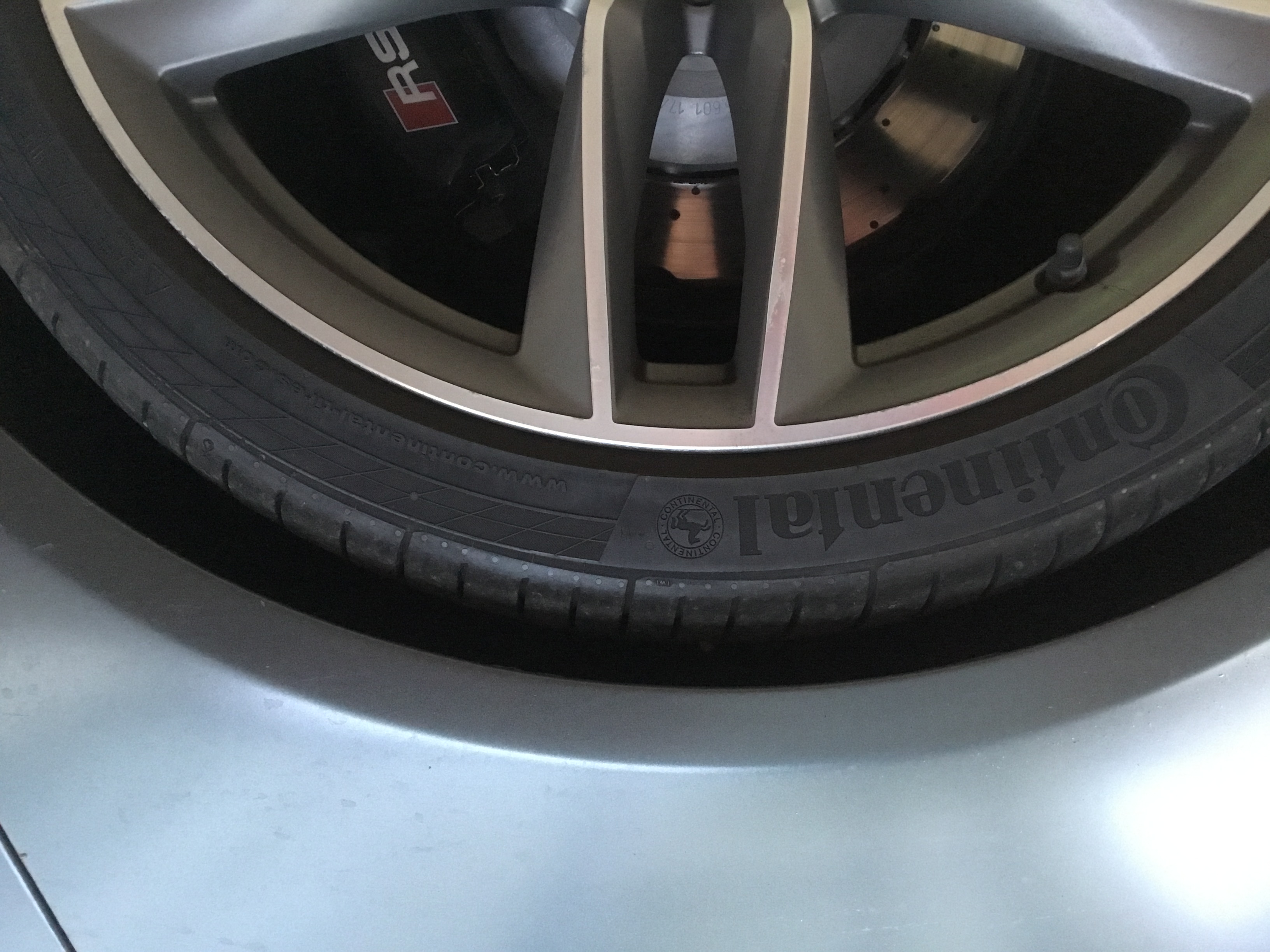

It also needs new rear pads so dropped into QST today to book in. Standing with the owner Kim talking about the knocking sound and he starts looking at my car from the rear and saying it doesn’t look right.
Turns out the rear offside sits best part of. 35mm lower than the near side.. on checking the camber the lower side is actually 2degrees outcompared to the other. The only people to have touched the car is Audi.

35mm? Christ that's a huge difference!

Re: DRC Front shocks ???
How can you do this by just fitting new shocks ???
Are the spokes bent?
It does look like that but just the photo
All sorted now the camber was out. Didn’t think it would make that much difference but now correct and the gap is equal
