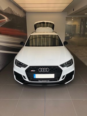

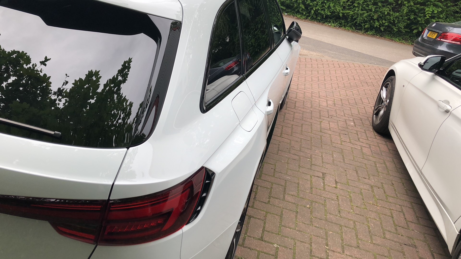

Looking great more pics please...bing0r wrote: ↑Mon May 14, 2018 1:19 pmPicked up my RS4 last Friday and loving it so far. My right foot is itching, as need to be sensible during break in.
It is however not got much storage space. Tried to add storage pack last min, but when i added it, the car had already been locked in for build so no changes!! grr..
However getting brake squeal at low speeds, which is rather annoying. Anyone else having the same issue? I know it doesn't affect braking performance, but rather annoying non the less. Not sure if it will go away after a few more miles or if it needs to go back to the for some additional grease on the pad ears or shims?
No brake squeal here maybe that is why it spent 10 days in QC!
