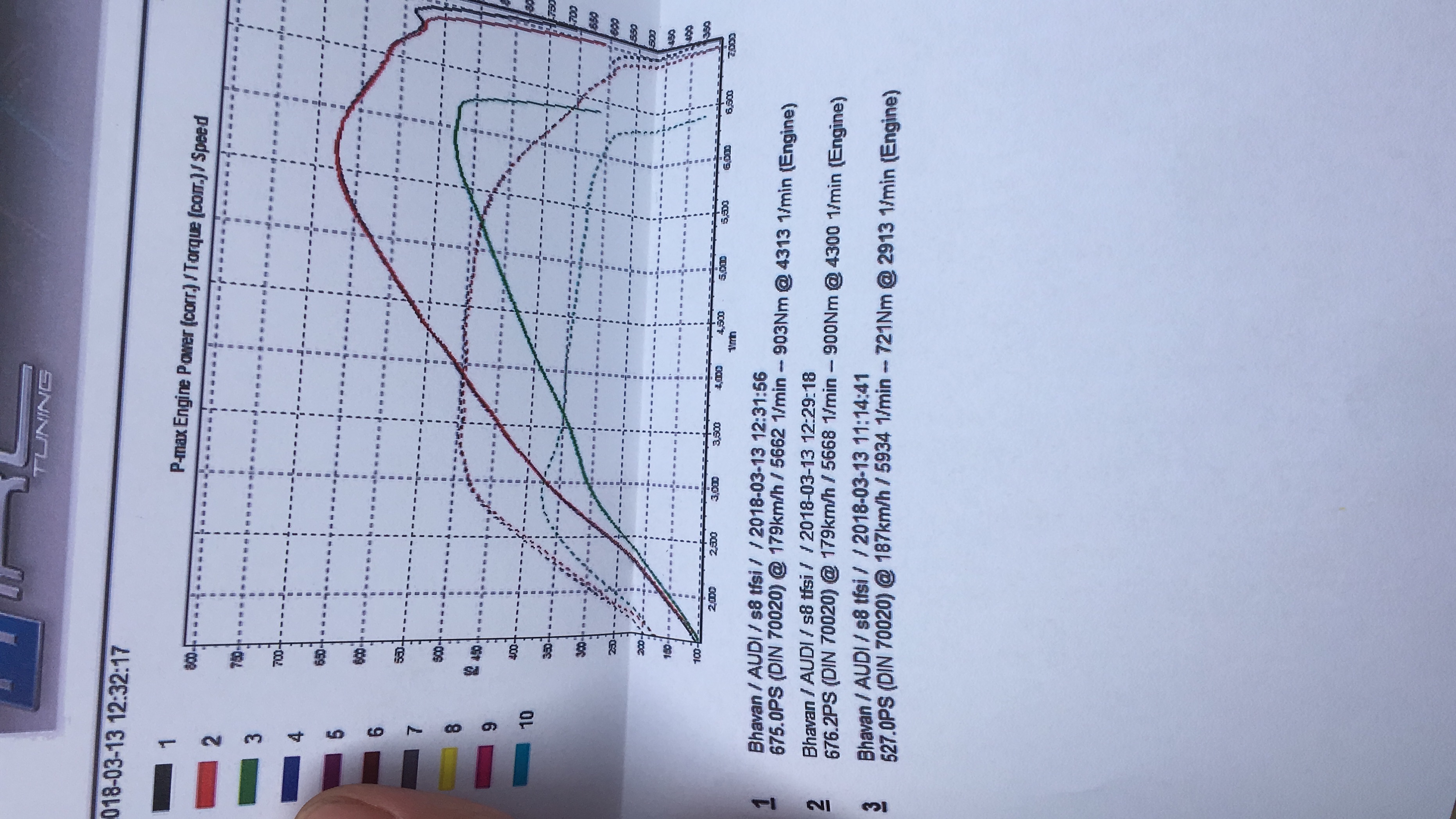

Hi, I have an MRC tuned Audi S8. Similair engine to the RS6.
Yes, they are more expensive, however, the time on the rollers alone is enough to warrant the extra cost.
Doug must have done around 10 runs in mine and fine tuned it perfectly.
The gearbox feels like it has been tuned (Maybe placebo) but the rev limit has definitely increased when warm to 7k from 6300.
The way the power/ torque is now delivered has transformed the car.
Few cars have a chance at the traffic light grand prix, and mid range is enough to stick with the best of them.
Dyno: Almost a 150ps gain.
MRC will only Map if you fit high flow air filters ( I went for BMC) and racing sparks (NGK 4905’s) which either MRC can fit or you can done locally as I did. - And a full tank of V-power or equivalent. (Maps are Octane sensitive)
These engines are very reliable if tuned correctly, however from what i have read very unforgiving if not.
Hope this helps and and good luck
