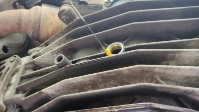

So, I've started doing a major service and just wanted to ensure the Gearbox fill and drain plugs are normal threaded. ie. Left to loosen - and not reverse threaded
I've put an extension on my 1/2" ratchet and even after some heat - the damn gearbox fill plug is not budging! .. even with a small breaker-bar.
I haven't even attempted the drain plug yet.

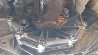

yep, managed to get off the Gearbox fill plug - just required a little more leverage (counter-clockwise) , by way of extension bar.. was slightly tricky as not much room when performing on the 'ol driveway..
the drain plug was easy enough:

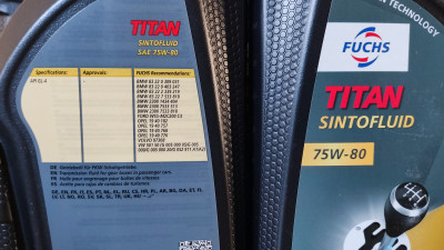

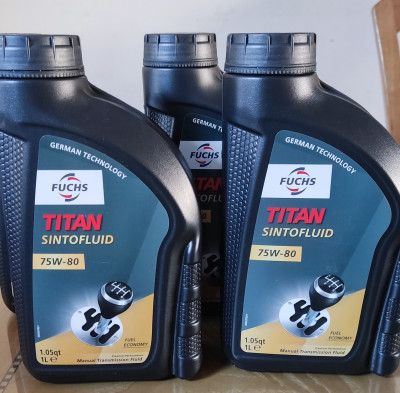

For reference:
OE Audi Gearbox Oil part # G052 911 A2
Audi Price (as of Aug. 2023) ~ £27.87 each +vat per 1L bottle
Gearbox Capacity ~ 3.2L
So, purchased 4x 1L Fuchs TITAN SINTOFLUID SAE 75W-80 Synthetic Manual Transmission Fluid , as Fuchs meets Audi Spec, typically come highly recommended and cheaper!
