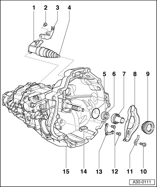

I am convinced this is the problem
on most transmissions the throw out bearing guide bushing is fixed to the tranny casing (the bushing and bearing do not spin, ie are stationary relative to each other, so they can't wear badly)
on the RS the bushing floats on the shaft (and the bearing does not spin) and will spin at some speed slower than the shaft due to friction
as the bearing is pushed on the the spinning bushing it wears/heats up, this cuts a groove into the bushing and bearing and this is what 'catches or hangs up
due to the groove and the heat causing expansion/binding, this is why it's worse when pushed/hot
can someone post the audi parts diagram for this assembly?
BMW item 7 is the bushing that the bearing rides on, fixed to the tranny
show how the bearing slides on the busshing/guide
Re: Clutch pedal doesnt come up
here you go arthur...i think your right.
b7rs4 phantom black, titan pack.
I'd like to see item 7 first pic from a high mileage car
wonder if the clip item 13 is tight, ie, no spinning, or just holds it in place loosely
I wonder why they did it differently than all the others?
especially since the tranny is made by the same company Getrag?
