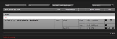

Comes across to me like these are just a set of dampers with a load of extra mumbo jumbo attached. Of course, I could be wrong. From the koni website:
These look like the same part numbers he's used, without the "RS4 Special" text.
If you're planning on changing springs and dampers, I'd seriously consider some decent coilovers instead."Manufacturer Part Number: 8240 F RS4 1235 Special 8040 R RS4 Special"
