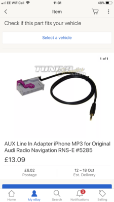

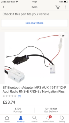

Perfect write up, thanks for that fella.
Out of interest, Anyone tried either of the following for a straight plug and play?

Post by mikep99 » Tue Oct 03, 2017 11:41 am
looks like you've already got something hooked up to the socket where the aux in goes.
Do you have a tv tuner / camera or similar?

Yep, something already in the slot, see what that is first, likely to be tv tuber which doesn't work now anyway. The bottom of the two links is all you need. It's three wires, nothing special.

Yep I bought and fitted one of these cables and got Listers Audi to map the Aux port. They did it for free and it works a treat.
