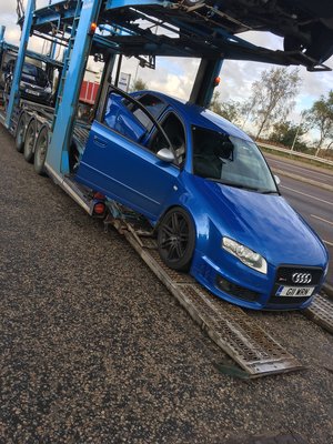

Update.
Car left on a transporter last Friday.... Destination MRC.
It arrived Tuesday afternoon around 5pm as I booked it in for stage 2..... The guys did a sterling job
Flew down on Friday morning from ABERDEEN to Birmingham then got the train to Banbury. Handy that MRC are 10min walk from Banbury train station.

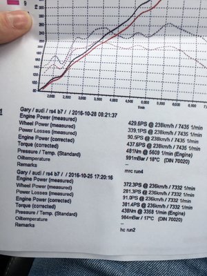

Car was treated to stage 2 map after having the pre cats gutted, decoke done, manifold deflapped as well.
Doug mentioned that carbon build up was average, first time it's been done as well. It performed ok with 381ps for the health check run. Then after the work had been carried out it ran 438ps
Throttle response is brilliant now power band is coming in just after 3k rpm. The drive back to ABERDEEN was most enjoyable. Apart from speed cameras on just about every gantry on the M6 and the bloody road works
Car has a deeper rumble now with the pre cats being gutted
