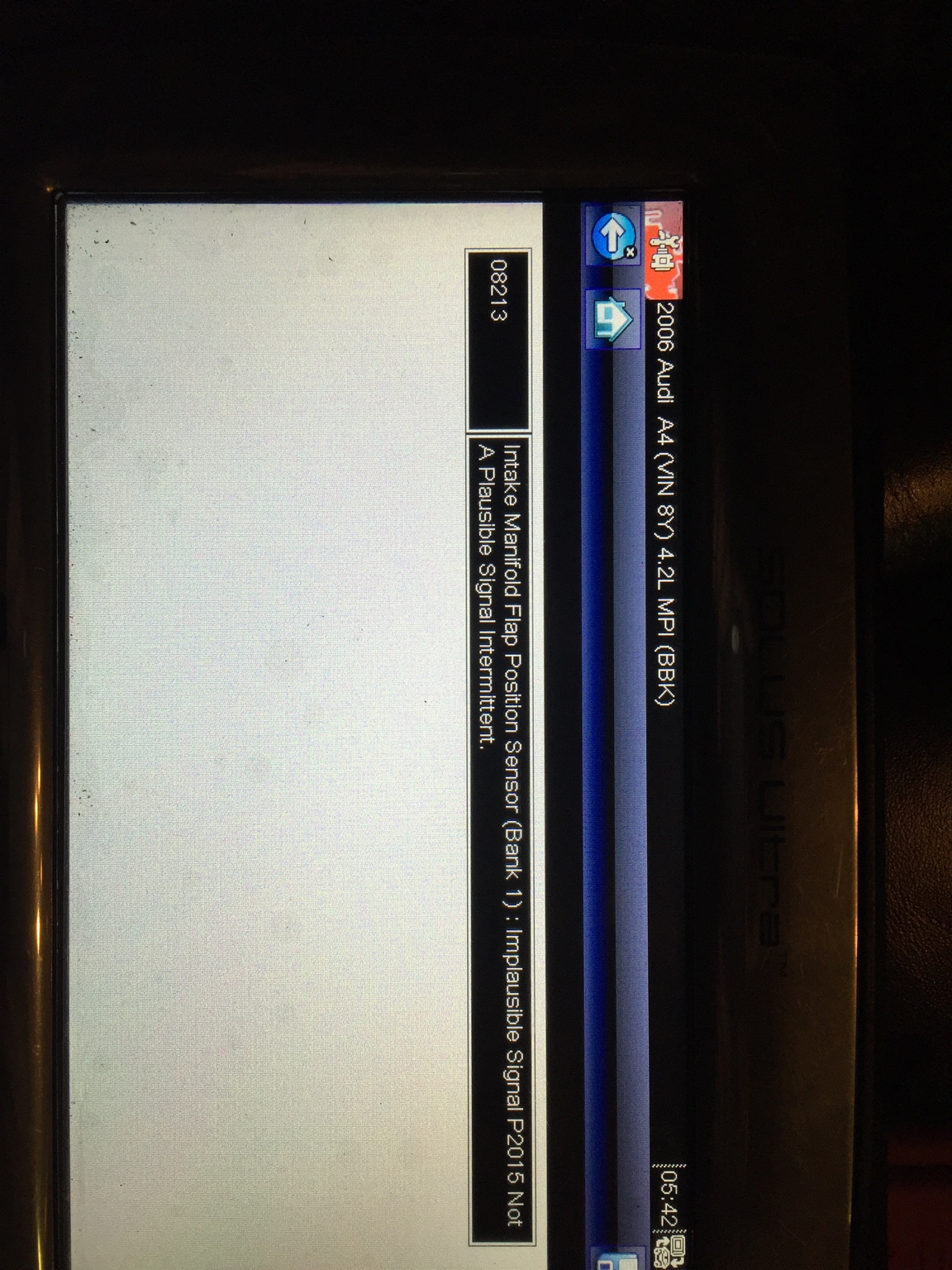

Hi guys I'm getting the same issue started with the doc light coming on was intermittent comes on then goes off had it plugged in to check and it came up with this

Any one had this issue ? Is this just a sensor issue ? Now the engine light is also on constant and the epc comes and then off !!
Any ideas much appreciated
