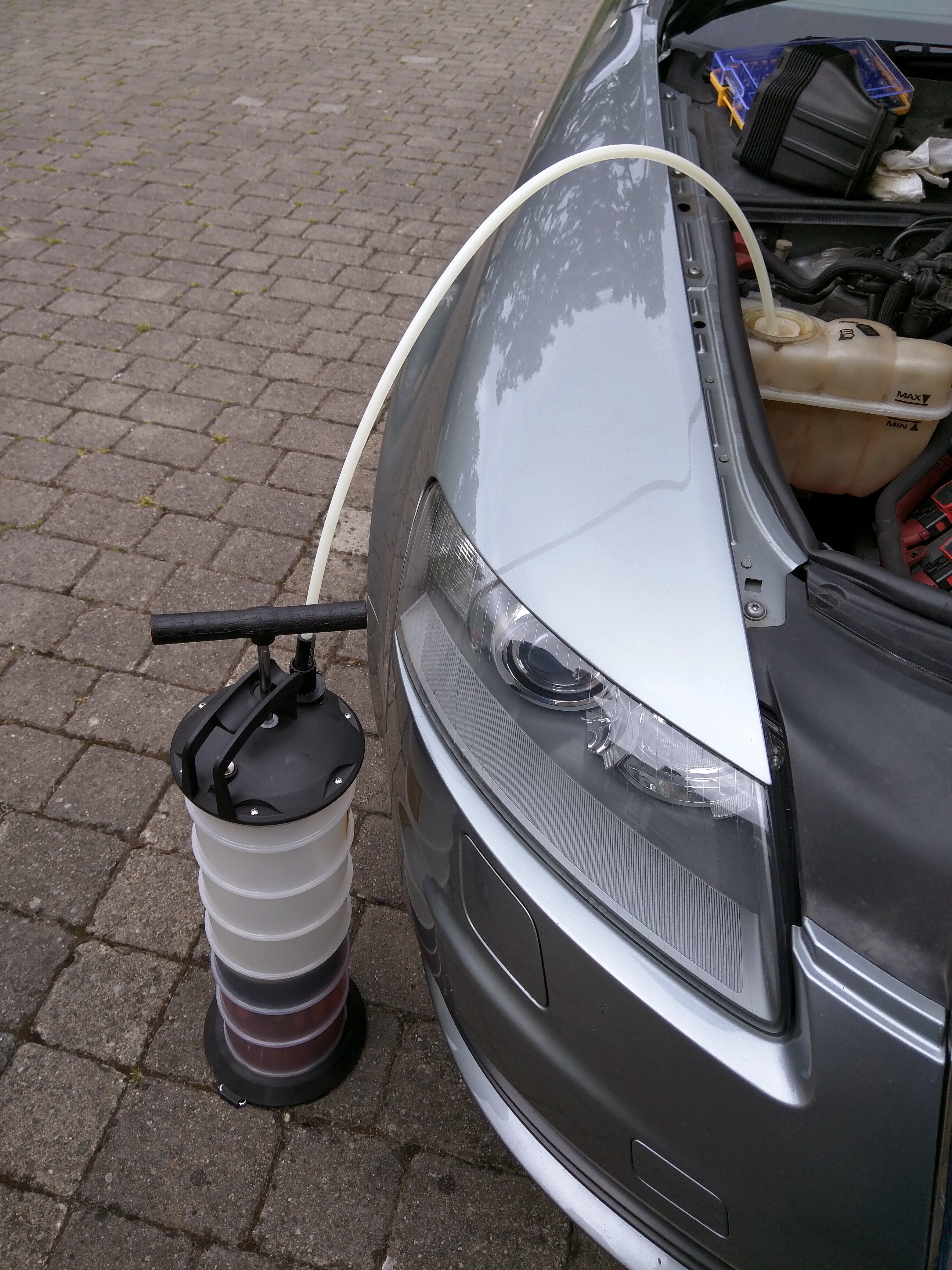

I started with my trusty peli pump, and removed all the coolant that i could from the tank, and the pipe underneath a little too.

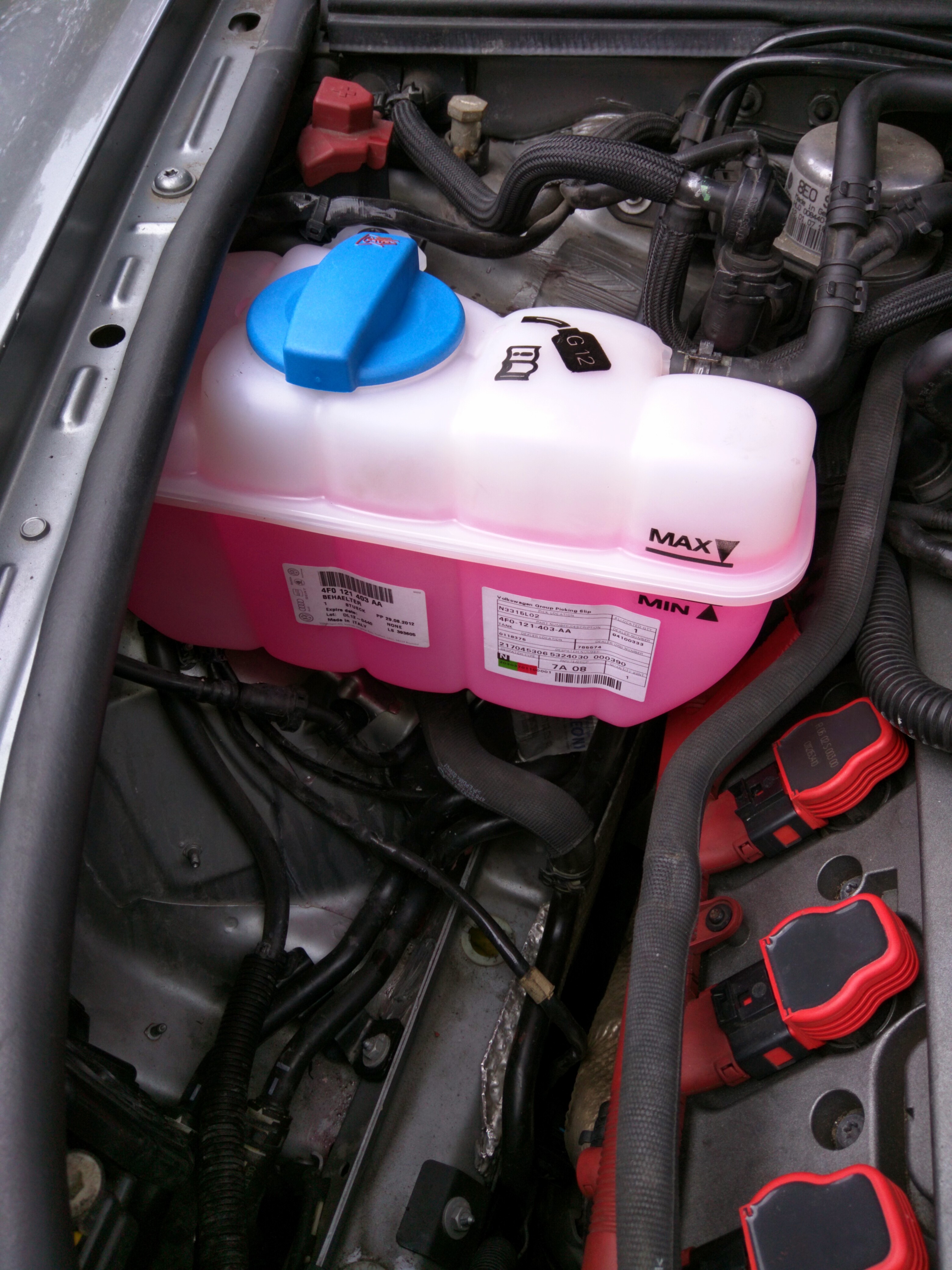

New tank prior to install so you can see the connections underneath:

peli pump:
New tank installed:
