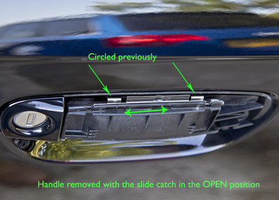

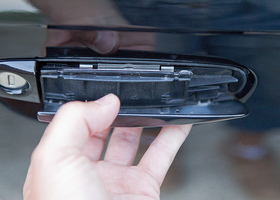

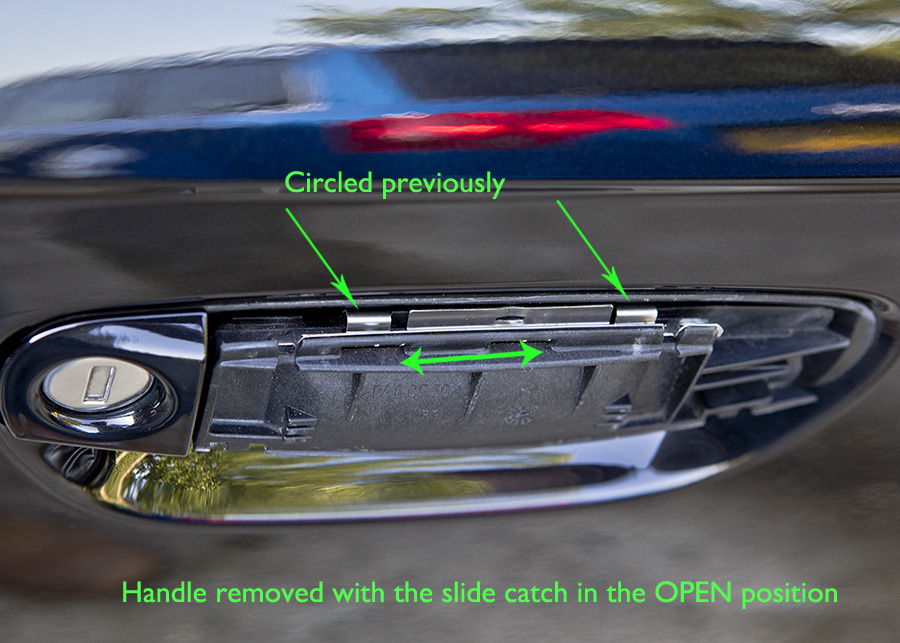

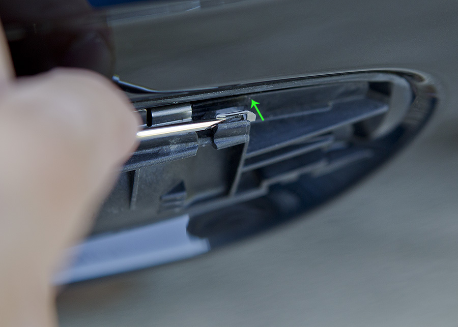

Going through RS4 number 2's list of niggles and the driver’s door handle rattle was one towards the top of said list. Every time I closed the door, it had an annoying metallic sounding rattle. The painted door handle cover also felt a little loose upon opening the door too.

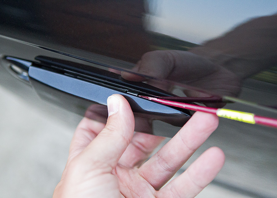

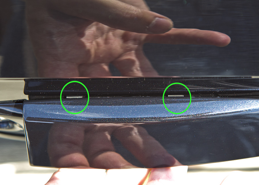

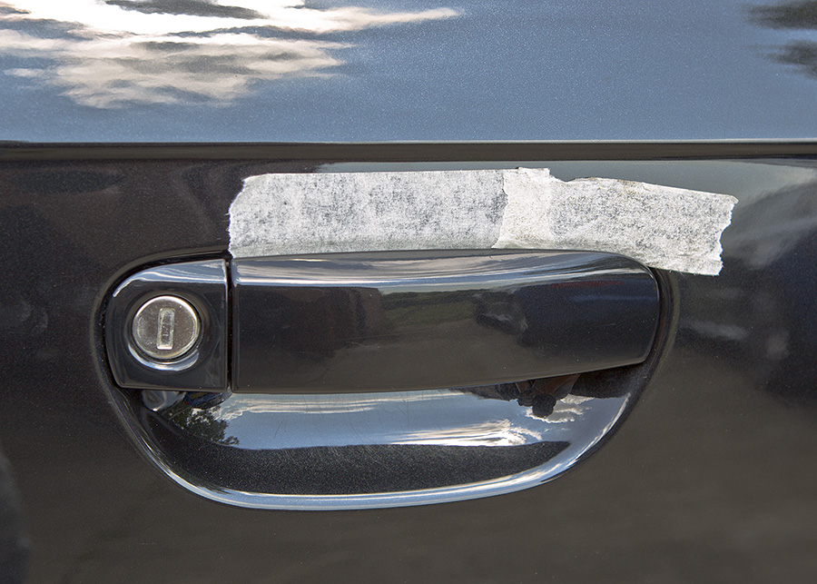

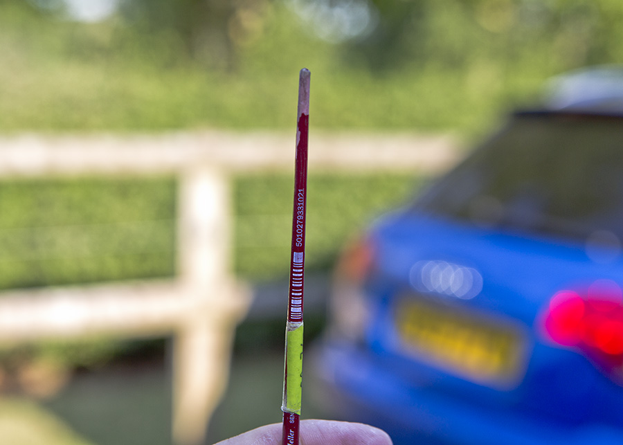

Overall its quite a simple fix. I found a small art brush buried in the bottom of my tool box which was similar diameter to that of an ink insert for a Bic Biro pen - DO NOT USE A SCREWDRIVER. Tape up the area with some masking tape to avoid any scratches to the paintwork, you can then lift the handle up two thirds of the way and look behind the top of the cover, you'll see two metal looking clips which are attached to each other in the shape of one long metal slider.
Click on pictures to enlarge slightly:

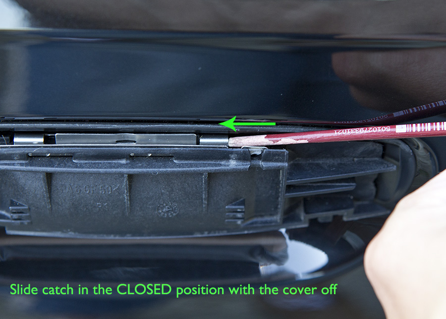

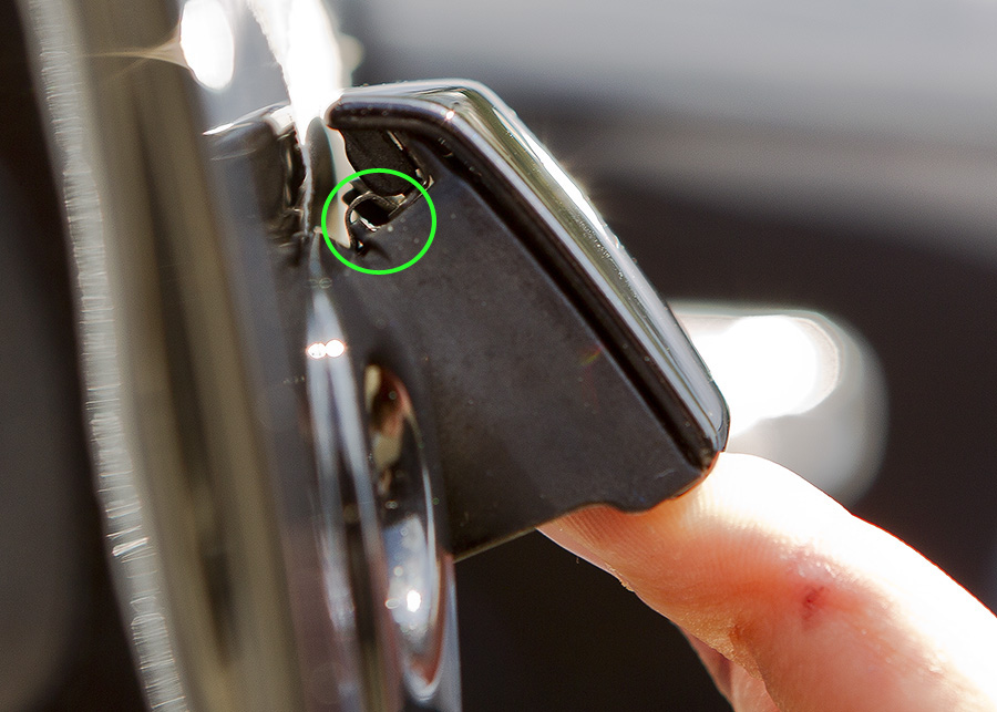

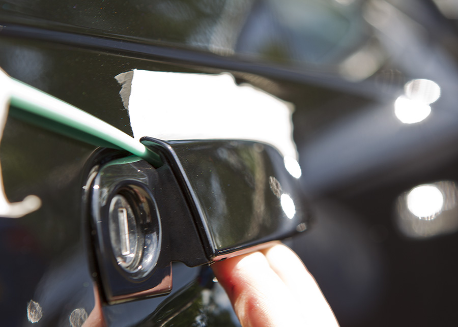

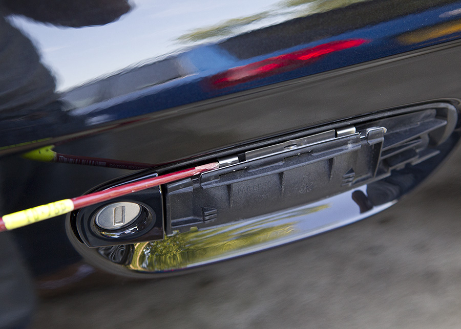

The slider/clip moves from left - right to open and the other way to close; I inserted the handle end of the thin art brush and pushed the slider to the open position. This made the handle really loose and you can then pull the top out a couple of millimetres which allows you to move the door handle cover downwards where you can disengage the bottom from two hooks.
Once the cover was off I just pinched the ends of the slider inwards a little to gain more purchase onto the handle cover and then re-assembled - you slide the clip right to left from the other side of the handle to secure the cover. Problem solved and all done in 5 minutes.
I have been trying this and don't seem to get it. Does the slider move from inside this hole or by pushing the complete metal bracket?
Mine is a LHD so does it work from right to left?
I have been looking at the "open" and "closed" position pictures and don't see any difference. Also I do not understand the arrows both
directions in the "open" picture. Please give more detailed advice:)
Neither do I understand where you adjust the handle. I see you with a small screwdriver & an arrow..
My car's door handle is really tight but when closing the drivers door it makes a slight metal sound that does irritate me.
After struggling 1 hour I had to give up before I brake something..

Post by Surrey Sam » Fri Apr 03, 2015 1:45 pm
The two parts circled move together as one metal item.
rob-s wrote:
The slider/clip moves from left-right to open and the other way to close
directions in the "open" picture. Please give more detailed advice :)
I believe that it's the same way for both LHD and RHD vehicles, so on a LHD drivers door you'll be starting at the oposite end to the lock cylinder. I've found a DIY fix on a USA forum which does it on a LHD car, it would be worth reading through that one as well - http://www.audizine.com/forum/showthrea ... tle-Repair
rob-s wrote:Neither do I understand where you adjust the handle. I see you with a small screwdriver & an arrow..
Very wise to give up, the last thing you want to do is scratch the paintwork.
When you have the handle off, you'll understand how to adjust it. I bent the metal bit inwards to gain more purchase onto the handle's hook when the slider is in the closed position.
Before adjusting, I could tap the handle heavily and it would rattle, also it was a little loose fitting. Your rattle may not be the handle cover if its all tight?
