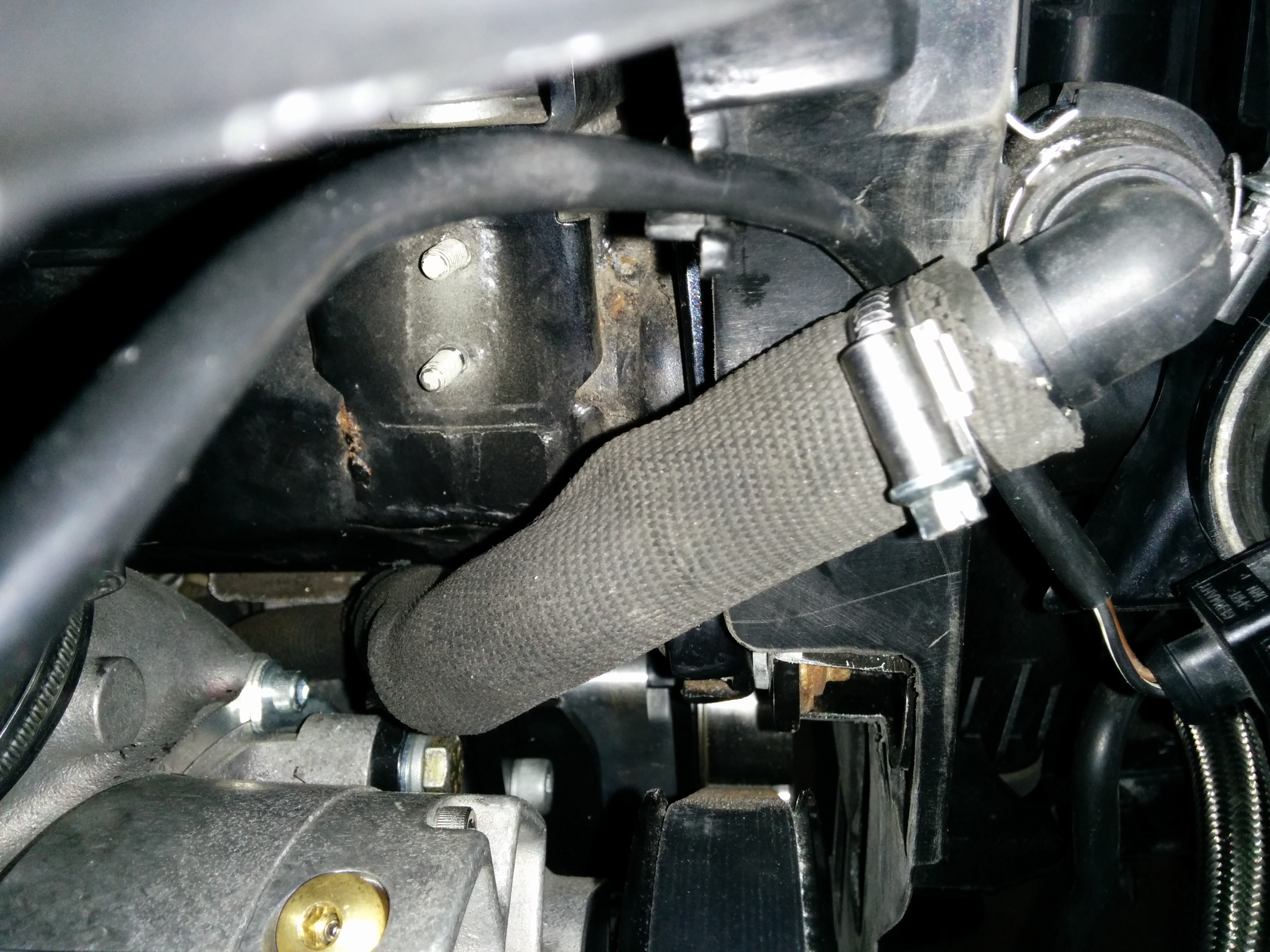

next job bumper crash bar back on and reconnect the coolant circuit from the deleted aux rad back to the main rad.
headlights back in, power steering rad on
the long modified ac line tucked up and fastened to the back of the bumper crash bar
a few cable ties to hold the pipes/lines, clearance from the pulley and belt looks good
