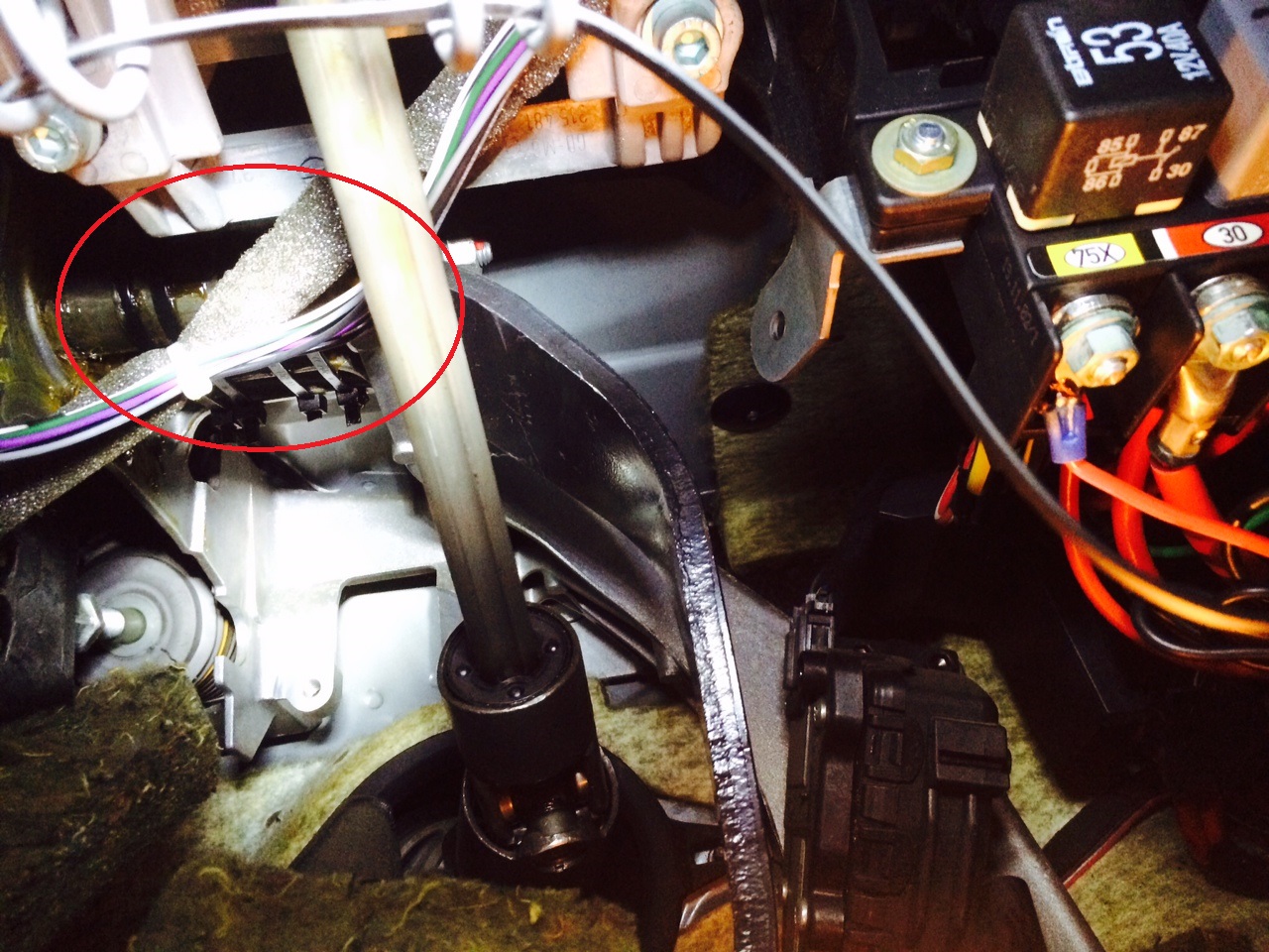

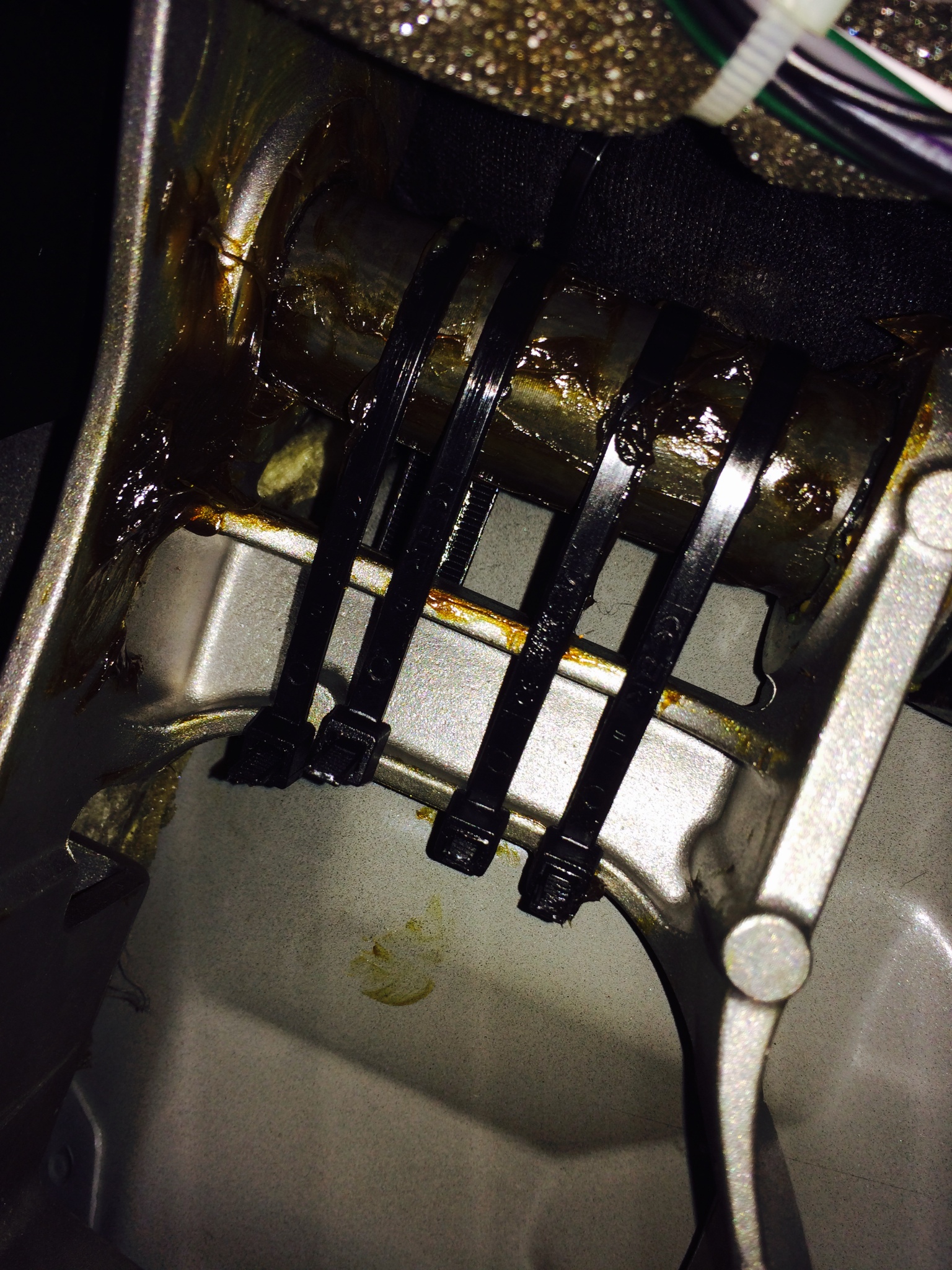

Okay i looked and saw what was done, It is where the brake pedal connects at the top.
Here is a couple of pictures so you guys can do this yourself, it's only a 10min job
Re: Vibrating accelerator pedal
Marvelous thanks. I take it that bit still rotates so needs a little greasing?

taspland wrote: Here is a couple of pictures so you guys can do this yourself, it's only a 10min job
Well, not a fantastic fix really, is it. But, if it does the job.
Proper replacement bushing has got to be the best way, but the pedal box is a proper faff to get out so sometimes a Heath Robinson half measure is good enough.
I'd be looking to put some bearings in there if possible. It's not easy to see how it's set out from the photos but obviously the original bushing isn't up to the job.
Did mine quickly last night. Wasn't too hard but I'm not 100% sure its the solution I want. My outer bush seemed to be the one with the most movement but couldn't figure out how to dismantle the pedal - think it might just be a massive bolt all the way through the pivot.
Anyway. All seems to be working ok. Vibration has definately gone.
I did mine, and it's stopped the vibration, with regards to movement, the bar only moves about a quarter of a turn for the brake pedal, and the cable ties move with it,
I'll keep an eye and see how long it holds up, but for a freebie I'm very happy with it, for a perm Fix then Unit20 can fit a replacement washer.
Just to add to this, MRC worked their cable tie magic on the + last week and it's pretty much eliminated the vibrations.
Much happier now.
How did these last now we're a year and a half down the line ?
They are cable ties mate, if they fail after 3 months you just put some more on. Cost you around £2.
chunky79 wrote:They are cable ties mate, if they fail after 3 months you just put some more on. Cost you around £2.
Yeah I get that bud cheers. Just wanted to know if people have found they have lasted well or if the fail after 3 months. If they fail quickly I will look to rebush it rather than tie it
